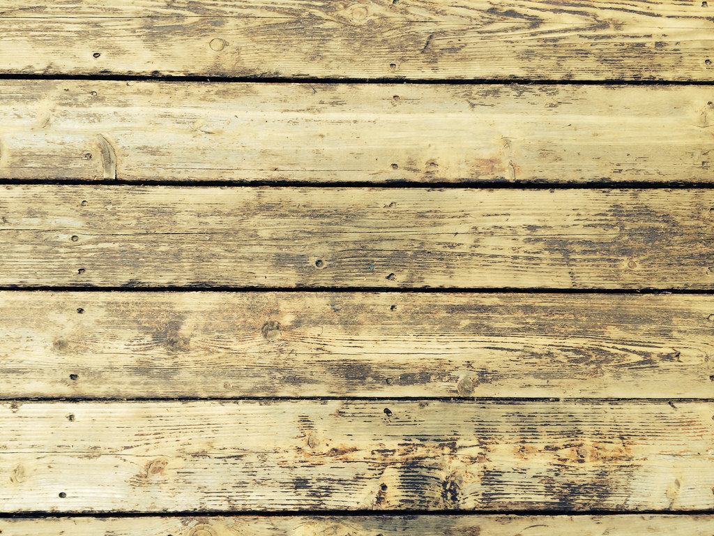

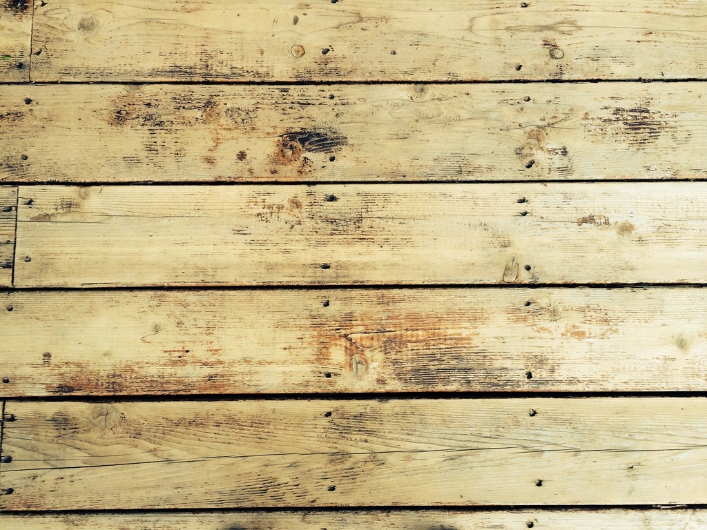

I'm really happy I found this site. I bought my house last year, I'm in MA. I have a deck that gets a lot of sun and the old finish, a dark brown stain, was peeling off. I used JOMAX Stain and Finish Stripper from Lowes. After heavy powerwashing I got most of the stain off, and then ad to sand the whole thing because of the heavy powerwashing. My question is, does this wood look ready to stain or is there more I need to do?
You need to get the black out otherwise it will show. You would need to strip and brighten for removal. Other option is to use a very dark colored stain to blend.
(@gdphishman817)
Joined: 12 years ago
We were already thinking of doing a dark stain, we thought about TWP 1503 Dark Oak, and TWP 1504 Black Walnut. Do you think those are dark enough?
Black Walnut for sure. Maybe on the Dark Oak.
(@gdphishman817)
Could I also just sand down the dark parts?
Striping would have better results than sanding them out. I would blend with a dark stain.
