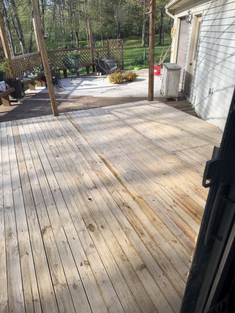

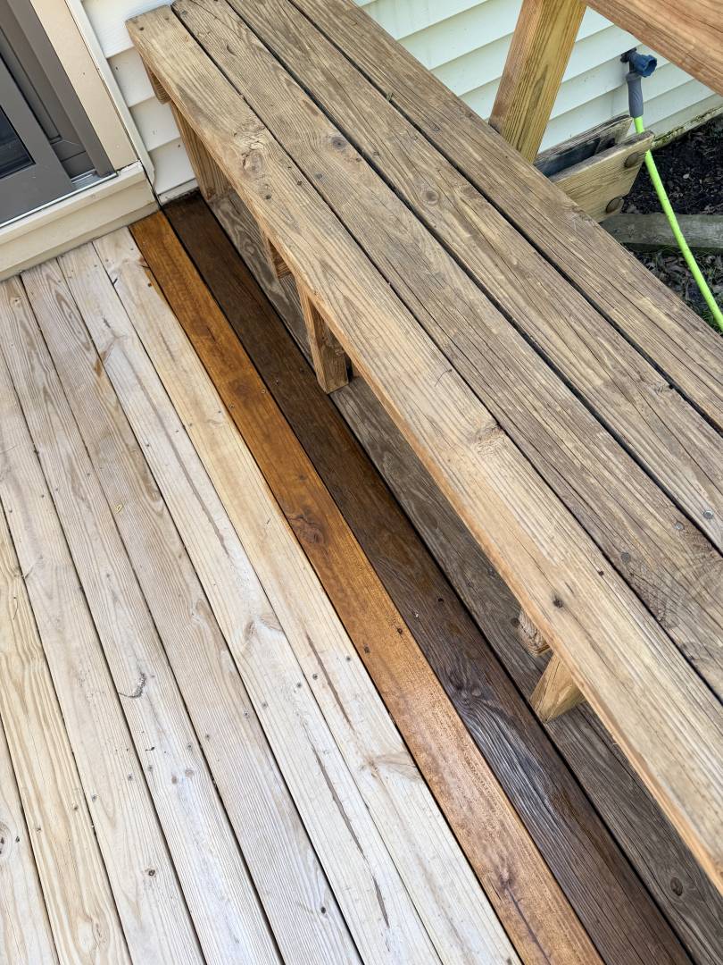

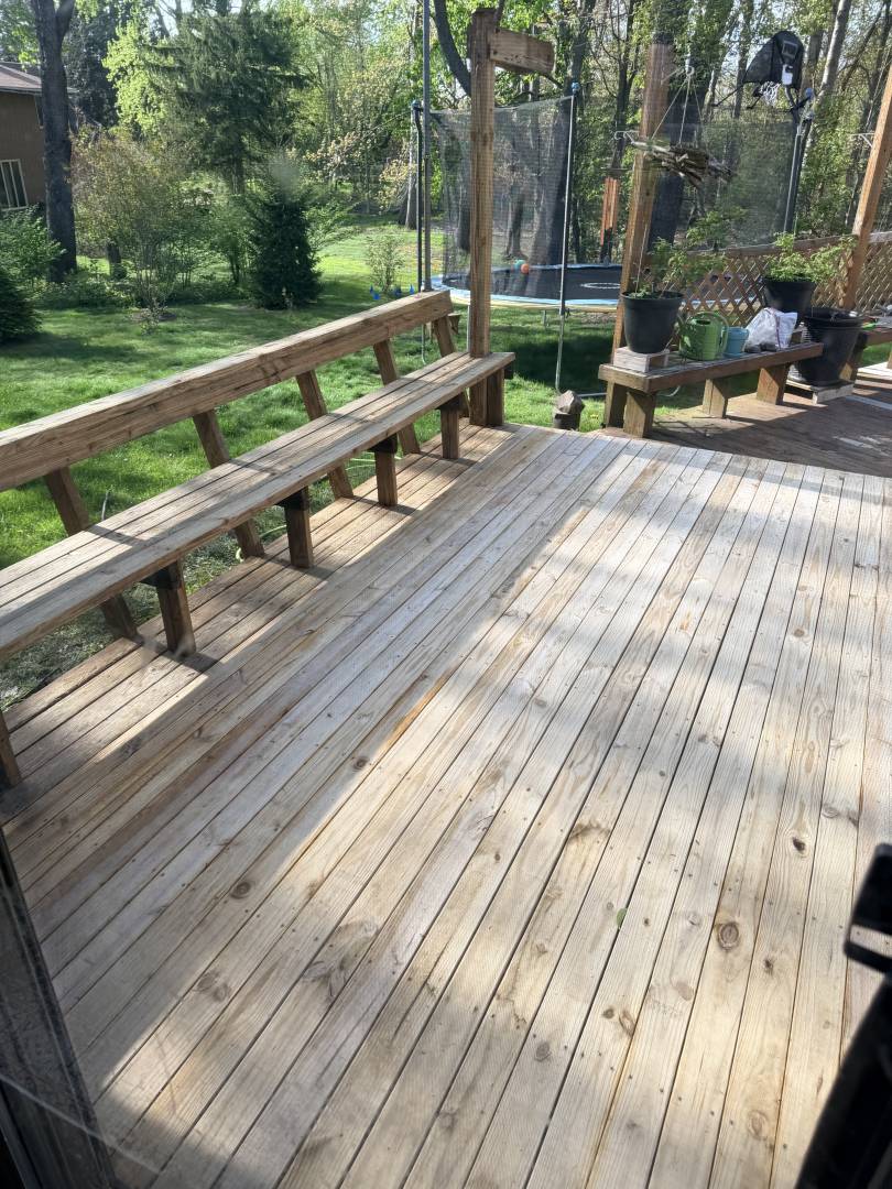

Last year we replaced a large portion of our deck boards with pressure treated pine. We left the built in benches as they were still in decent shape. Now that the new wood has dried out, we used RAD stripper and brightener on the entire upper deck(doing the lower area next). We are going with TWP 1500 (pecan) for the stain. We tested 2 boards—one old and one new and the contrast between them is a lot more than we were anticipating. My question is—should we use a darker stain like dark oak on the new boards and use pecan on the old boards, do some sort of mix of the colors, or go with a different stain altogether? Thanks!
Posts: 3385
It is not possible to blend new and old wood when using a semi-transparent stain. It doesn't matter the color or the stain brand. No matter what, the older wood will stain darker or richer as it is more absorbent than the new wood.
