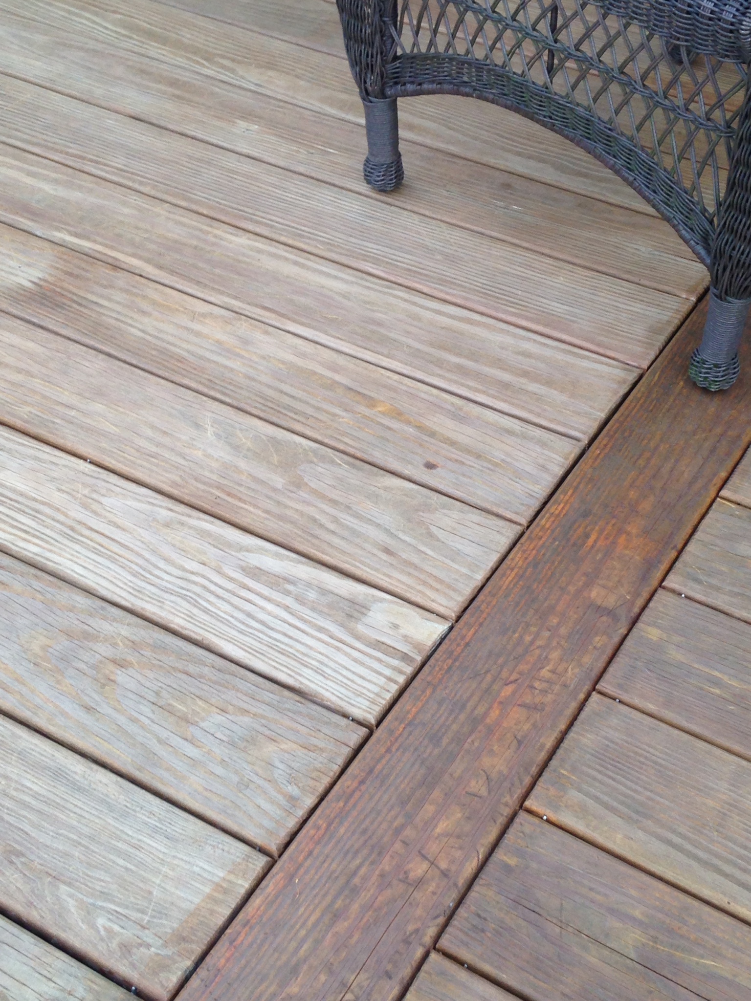

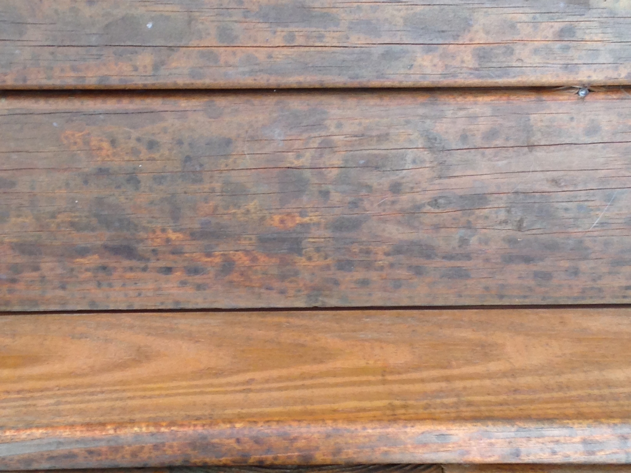

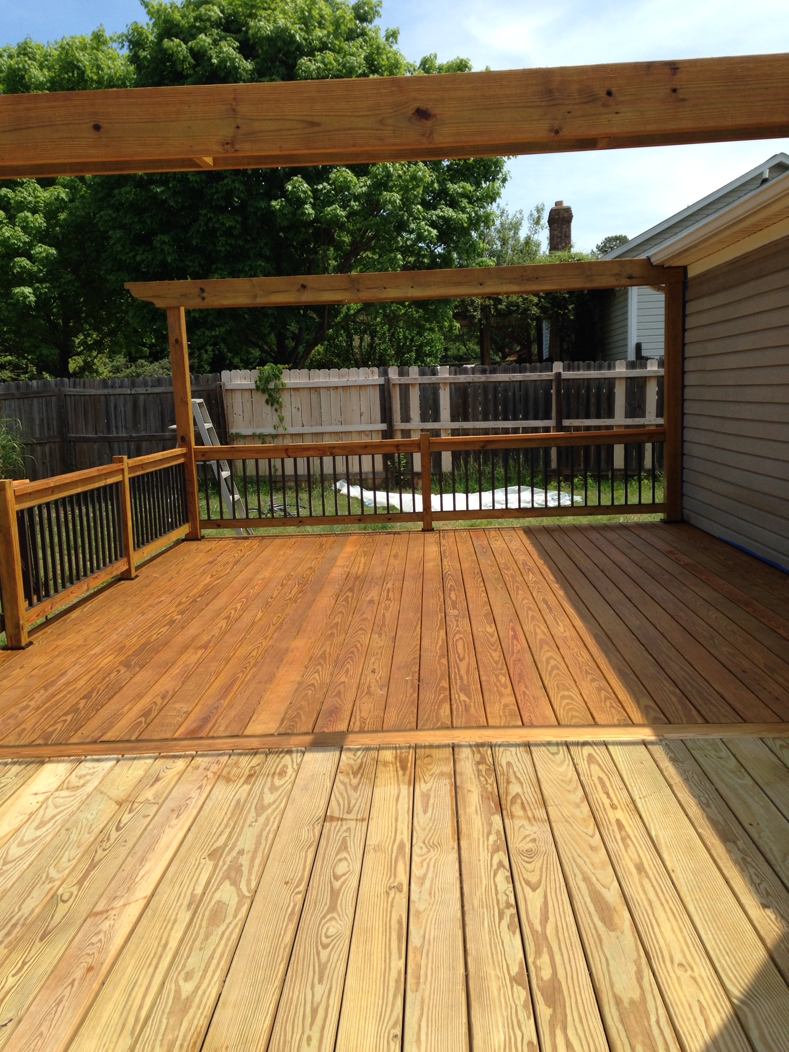

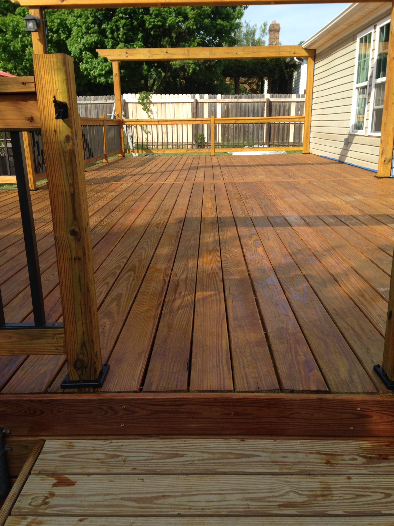

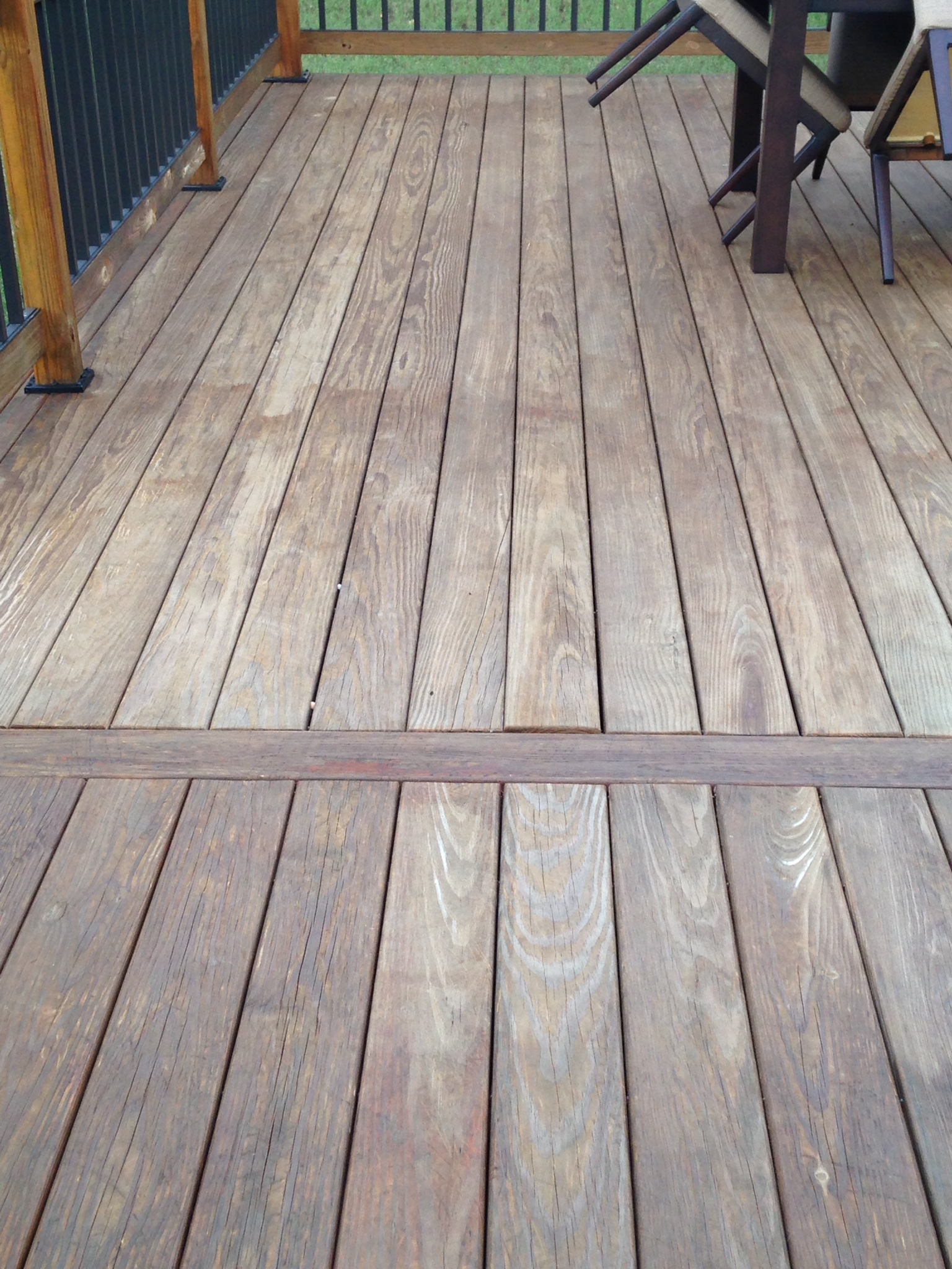

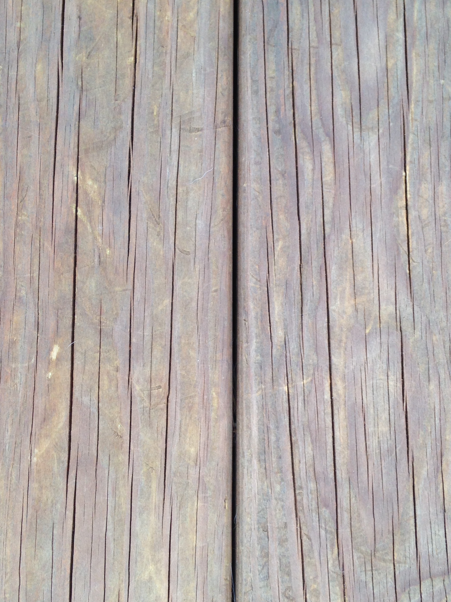

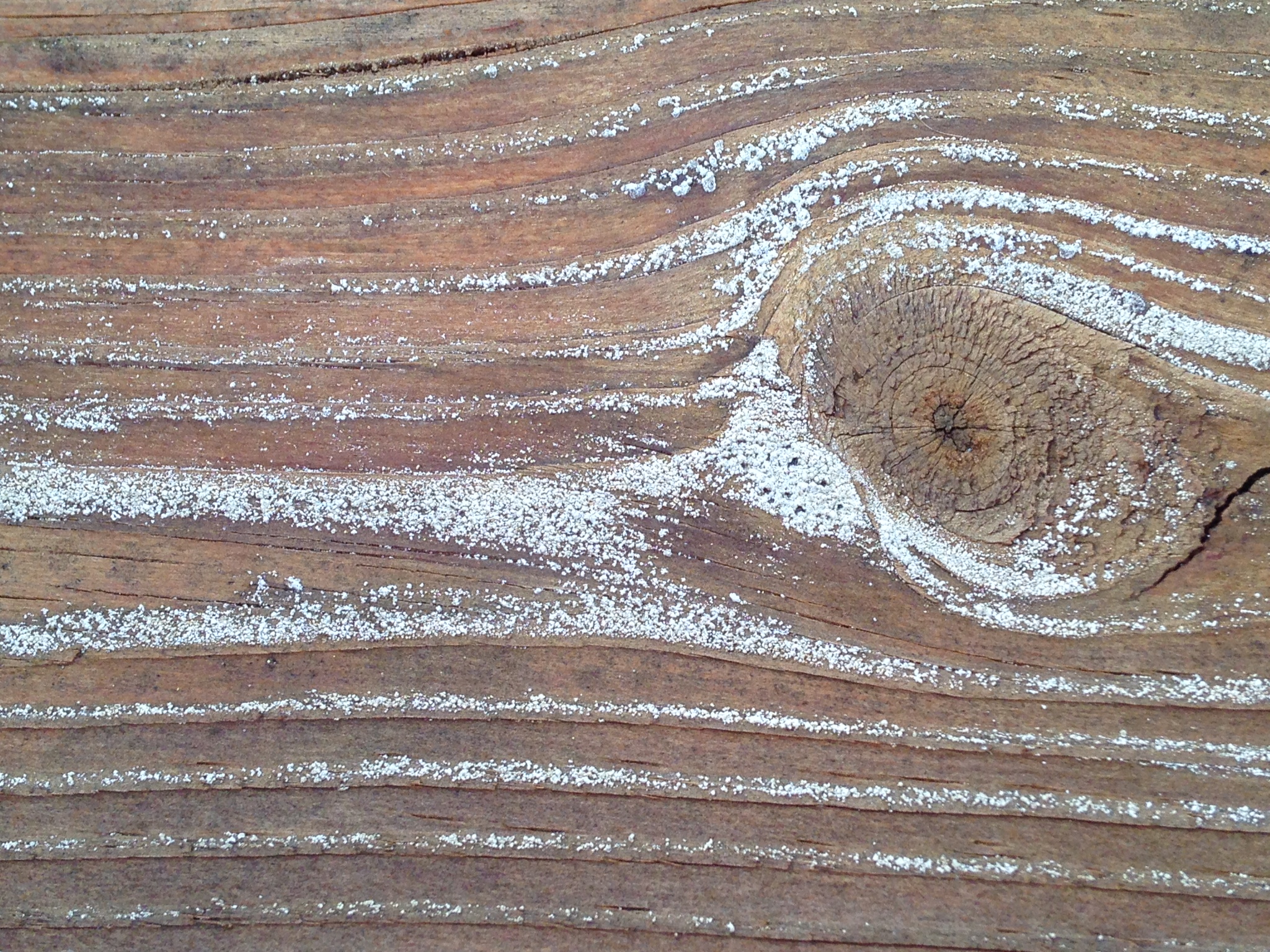

We're in a quandary. We had a brand new deck built with pressure treated pine in July 2014. Per the advice found on this site, we waited several months to stain, despite the fact that our contractor warned us that we'd be ruining the wood by waiting. In April 2015, we stained, using TWP 1500. By that time, as our contractor had warned, our wood was already quite warped, cracked and split. We were hoping that using the TWP would prevent further damage. We followed all cleaning, prepping, drying and staining instructions to a 'T', as found here and on the TWP website. We used the Gemini cleaning and brightening product as well. At first, it looked beautiful. After 6 months, however, the wood has further warped, split, and cracked. Very large sections have faded in color, to the point that it looks bleached. Other areas have bright orange splotches, as if the pigment in the stain had separated and is sitting on the surface of the wood. There is a mysterious white crystalline substance in many places, and large areas are covered in black mold. We feel we applied the stain correctly and evenly. But even if it wasn't perfect, it shouldn't look this bad. We are supremely disappointed, considering the amount of expense and work that went into the project (our deck is huge, so it was quite a lot). We're not sure what to do. Do we clean and stain it all over again, using the same products and hoping that another coat might enable the products to do their job? Or do we strip it, use different products, and hope that the second round of products actually works? Suggestions?

More pics

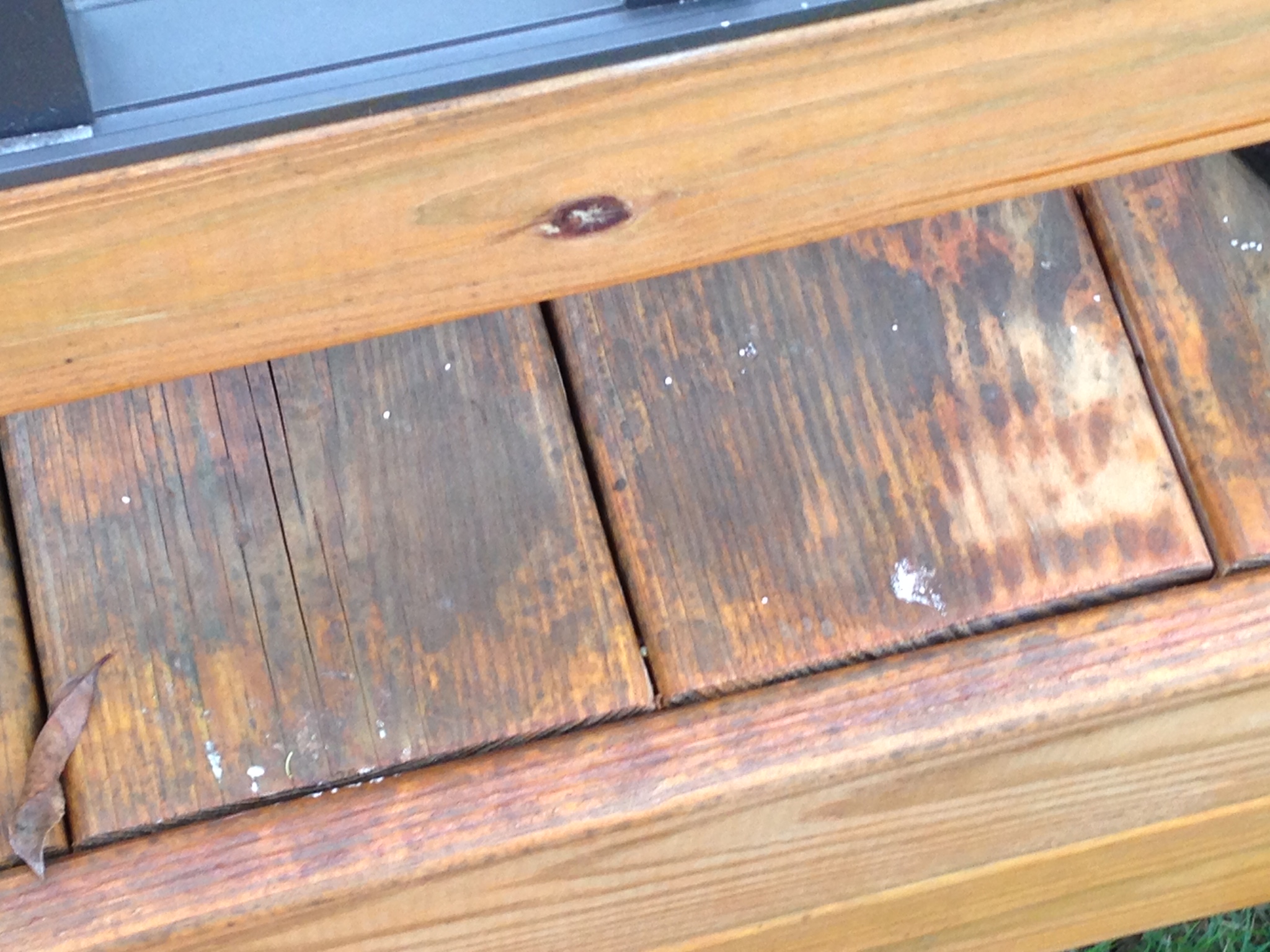

It looked so pretty at first (first 2 pics). Now colorless and cracked (pic 3) 🙁

The white coming out is sap leaching out of the wood and cannot be stopped. The thicker spots are your over lap lines from staining a little evenly. You can see that on the floors.
The real question is the mold. This is not normal and is not related to the stain specifically. I am guessing that pollen from one of your trees nearby was either on the wood prior to staining or fell on top the stain while drying. Pollen will feed mold growth when it rains.
At this point I would wait until Spring, prep the floors and reapply either with the same or another penetrating stain in a similar color.
FYI, warping and splitting happens to all exterior wood and is normal as well. Nothing will prevent this as stains do not seal out 100% of the wood. They need to breathe so they do not peel.
