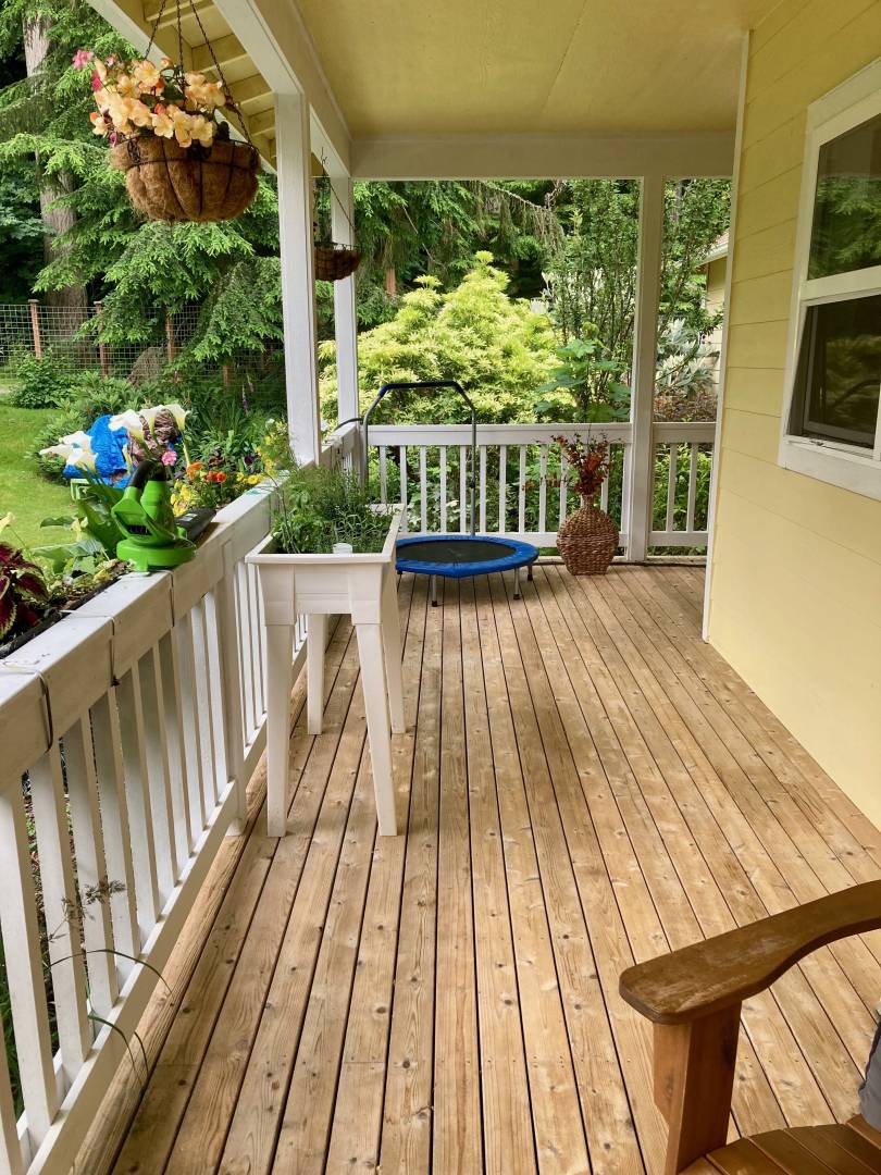

I used the RAD stripper and was very pleased with it. It was very effective. The deck is now exactly what it looked like when we moved here. Clean and natural. I am going to have it sanded towards the end of August and consider which application to use this season.  I will post a pic if I can figure out how....
Thank you for you help.
(@whidbey)
Joined: 5 years ago
Posts: 12
IMG 1358
Posts: 3343
@whidbey Looks great!

Continuing on I used Aussie Timber Oil on our rear deck last year. It help up very well and it was easy to strip and power wash off this year. I am tempted to use it on the deck pictured above. The most outer cedar board gets heavy weather. I want to stain that single board around the deck. I thought painting it while as the paint holds up year after year. Don't know if that would look "off". Ideas appreciated. Thanks
Posts: 3343
Sure you could try that.
(@whidbey)
Joined: 5 years ago
Posts: 12
completed the Australia Timber Oil Natural on the front deck. I really like the look
I ended up painting the most outside board white and will post that as well.
