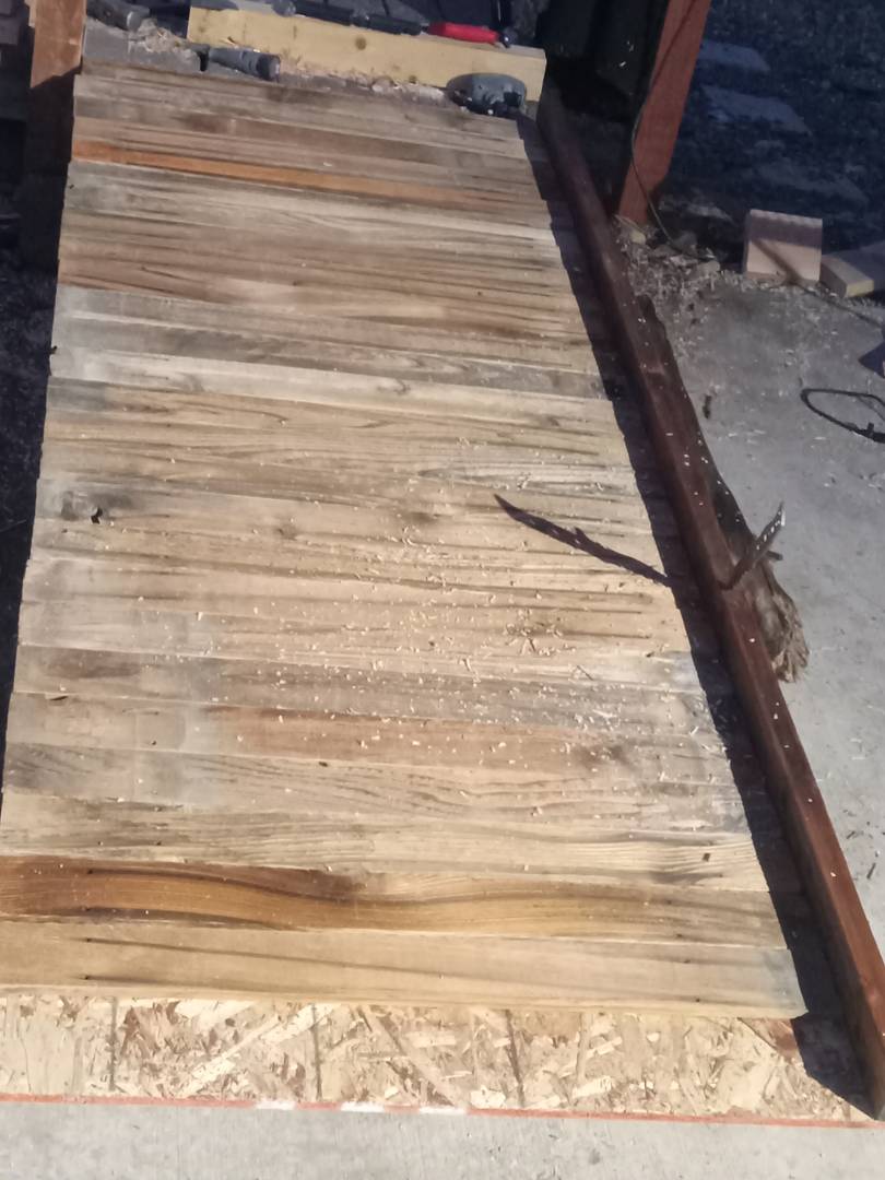

Anyway, he had me take out some old garden fencing that had some awesome weatherd features and colors.
20221220 170520
So I lightly sanded a couple arm loads of them and placed them on top of the plywood,glued them down before screwed down

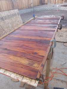

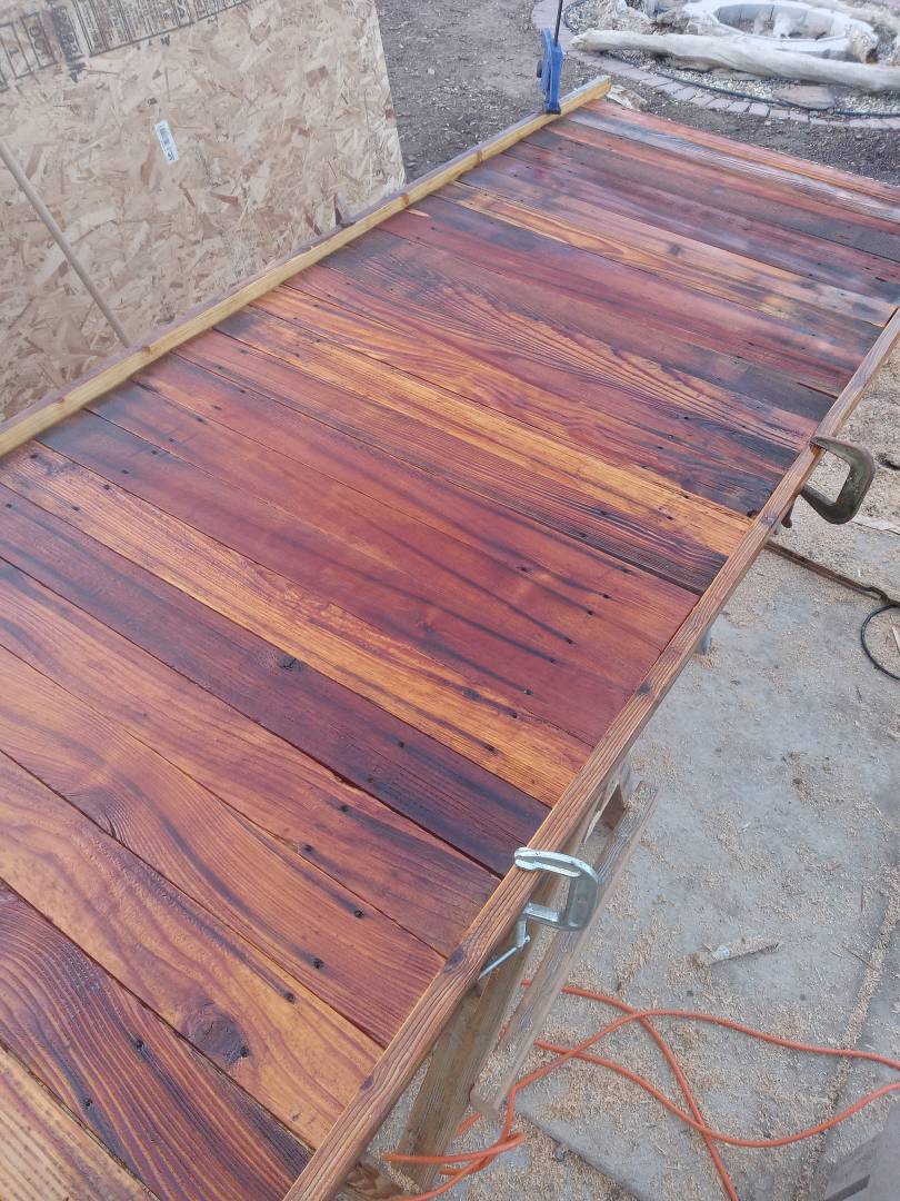

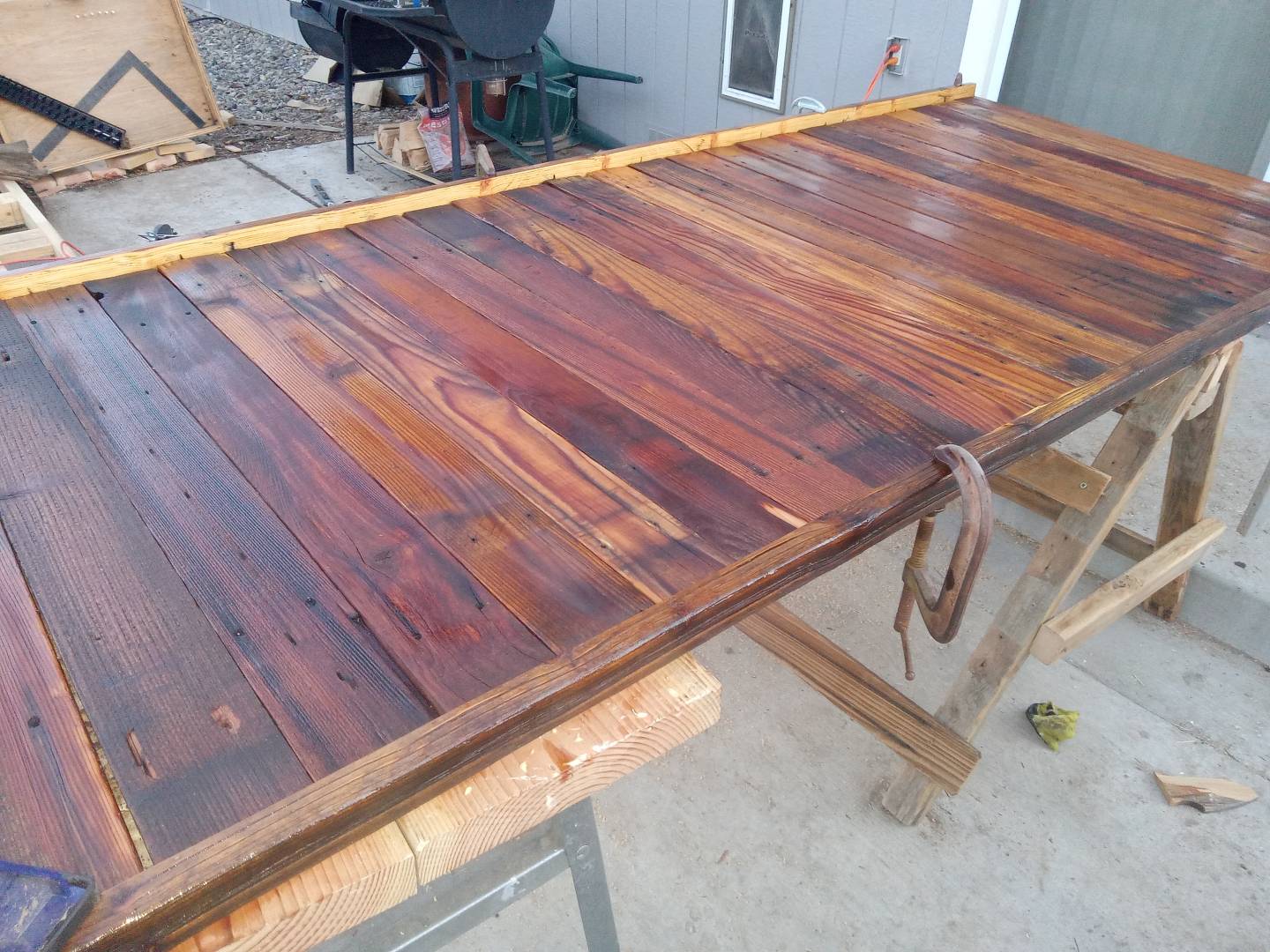

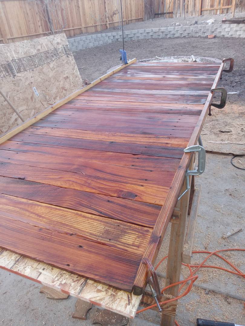

and gave them a couple coats of rejuvenation oil and boiled linseed oil.
20221224 163011
20221224 163000
20221224 163601
The colors came out great. So my question is, what type of stain/sealer should I use to protect this older wood from the elements,wheelchair use(occasionally)
and handle people walking/running up and down it? I'd like to keep the wood color if possible... any advise would be GREATLY appreciated. Thanks 😁
You cannot apply a deck or exterior wood stain over the linseed oil. It needs to be removed. In addition, it will attract mildew and mold. Strip and brighten to remove and then stain with Restore A Deck Stains or TWP wood stains.
