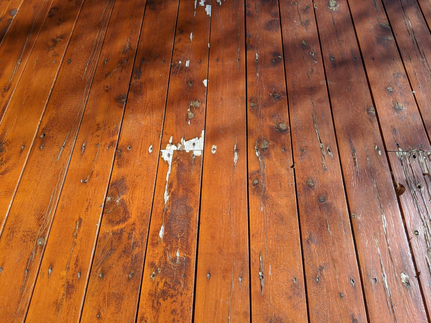

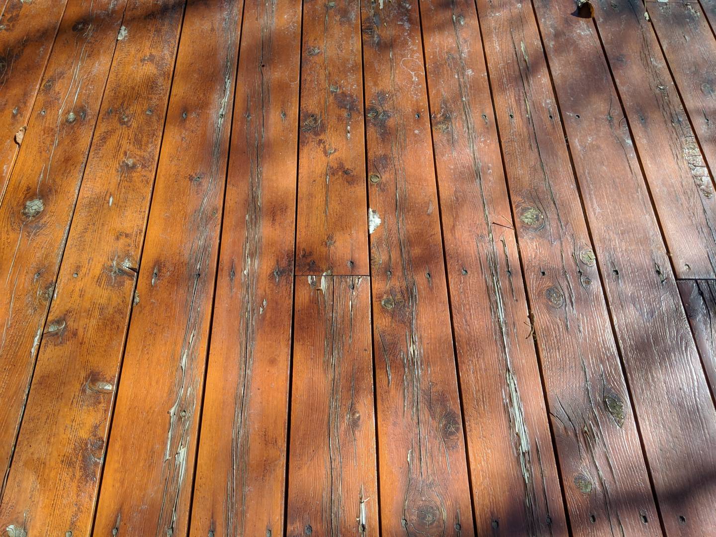

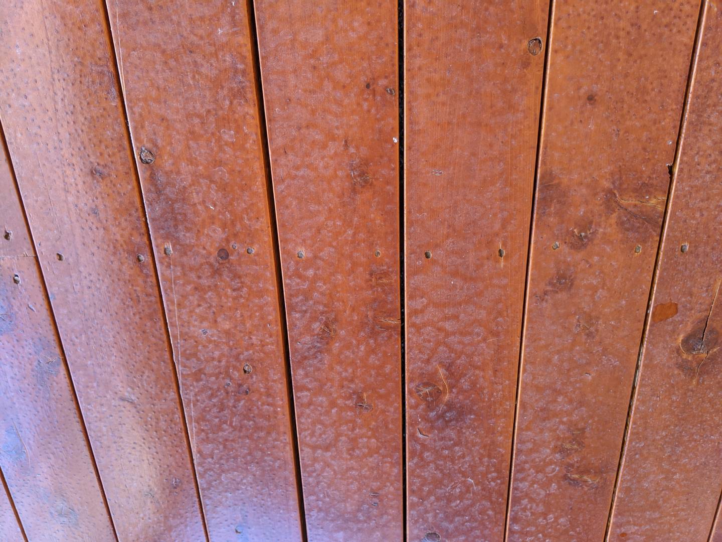

How much sun/shade does your deck get? At the overhangs on the house I get shade and those areas are ok BUT when I apply new stain over this ok portion it should match the portions that are exposed Portions of deck exposed to Sun, Snow, Wind are pealing, and some areas on boards are gone

Why/how did the previous stain fail? Its wood. Wood is not a good material for a deck, but I am stuck with it. House is at 8000 ft ASL and Sun Snow are brutal on the wood it pealed and eroded in places where exposed. Portions

 Left to right 1. Typical Exposed Deck to elements, 2. other area going bad 3. good section under overhang 4. another typical bad area
I am looking for a recommendation on a good SOLID Stain Deck product that will last

See some tips on prepping for a solid deck stain:
As for the Solid Stain, try Restore a Deck Solid:
https://www.deckstainhelp.com/restore-a-deck-solid-color-stain-review/
or
Defy Solid Stain:
https://www.deckstainhelp.com/defy-extreme-solid-color-stain-review/
