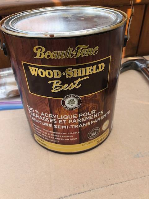

Used BeautiTone Wood Shield Best Deck Stain 5 years ago (refer to photo for this product).  Pressure washed and recoated it 2 years ago using a paint sprayer.  Incurred no problems, looked great.  Now 2 years later I have a few bare spots where it has peeled off.  This area gets direct sunlight.  I lightly sanded it using 240 grit sand paper, then cleaned that small test area.  I wanted to only do a small test area first to see if my logic worked.  I applied 2 coats on this bare area using a paint brush, waiting 24 hours until I applied the second coat.
My problem is that this bare area hardly changed color at all.  It basically still looks bare with a very light coating of deck stain that looks more like transparent which this color is not.  So after my 2 coats I went back to the hardware store and had them mix my can using their machine.  I then tried another small bare spot area using the same procedure as above.  Same problem, the colored stain barely covers that bare spot.  Any suggestions please.

Not possible to spot fix a semi-transparent deck stain and then have it blend. You would have to remove all old stain and start over with an even coat.

Thank you for your prompt, professional reply.  I need to better understand what type of deck stain to buy then for the future.  If I completely sand the entire deck, what type/brand of deck seal should I purchase in order to have it blend the bare spots if they occur.  Thank you.

It is not going to be possible to blend bare spots with any deck stain brand and type. When they occur, it will time to do a full restoration.
