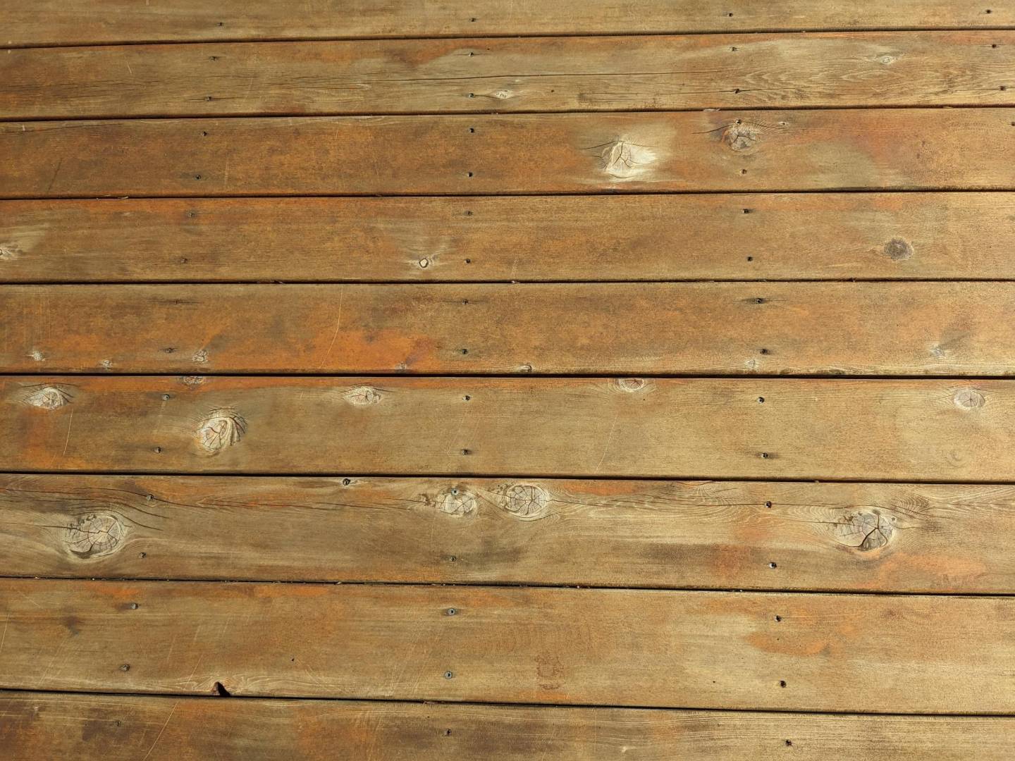

Thanks for putting together this great website! Here are my stats:
1. I am in New Jersey
2. The deck is in full sun
3. The wood is Alaskan yellow cedar, a.k.a. cypress
4. No mold or mildew
5. The results were very blotchy. I used TWP Total Wood Preservative oil.
This is a new deck that I stained after one year from the installation. I applied Restore-a-Deck cleaner, pressure washed the deck, applied the Restore-a-Deck brightener, wait for a couple of days and then stained with TWP.
Also, I had to sand the whole deck extensively because power washing it raised the wood grain quite a bit.
I don't want to simply strip the deck and start all over, until it is clear what went wrong. Any suggestions? Any help is greatly appreciated. Thanks. Al
deck
Posts: 3384
Looks like it was applied unevenly or possibly the stain was not mixed evenly prior to and continually while applying the stain. Also could be an issue if applied in hot sun when the deck temp would soar into the 100s. To redo, strip off first and let dry. Sand evenly with 60-80 grit paper. Brightener would be last.
(@b3ll0v1c)
Joined: 5 years ago
Posts: 4
@administrator You gave an idea. When I stained the deck it was a hot day, still within the temperature range indicated on the product. However, it was also a very sunny, so the temperature in the sun was definitely above 100F. That said, does it mean that the maximum temperature indicated on product labels has to be intended as the temperature in the shade? That would make a huge difference, obviously.
Posts: 3384
Wood temp can be 20-30% hotter than the air temp. I would suspect this is the reason and you "flash" dried causing the uneven appearance.
https://www.deckstainhelp.com/applying-a-deck-stain-in-full-sun/

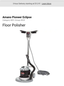

 elav
(@elav)
Screenshot 20230621 214551
One of these you mean? Do you have a pad or grit size you would recommend? Thank you.
This post was modified 3 years ago by elav
Posts: 3384
Yes. We typically use just a white or red pad to buff off fuzzies. If needed, you can also get the sanding discs and use them under the pads.
