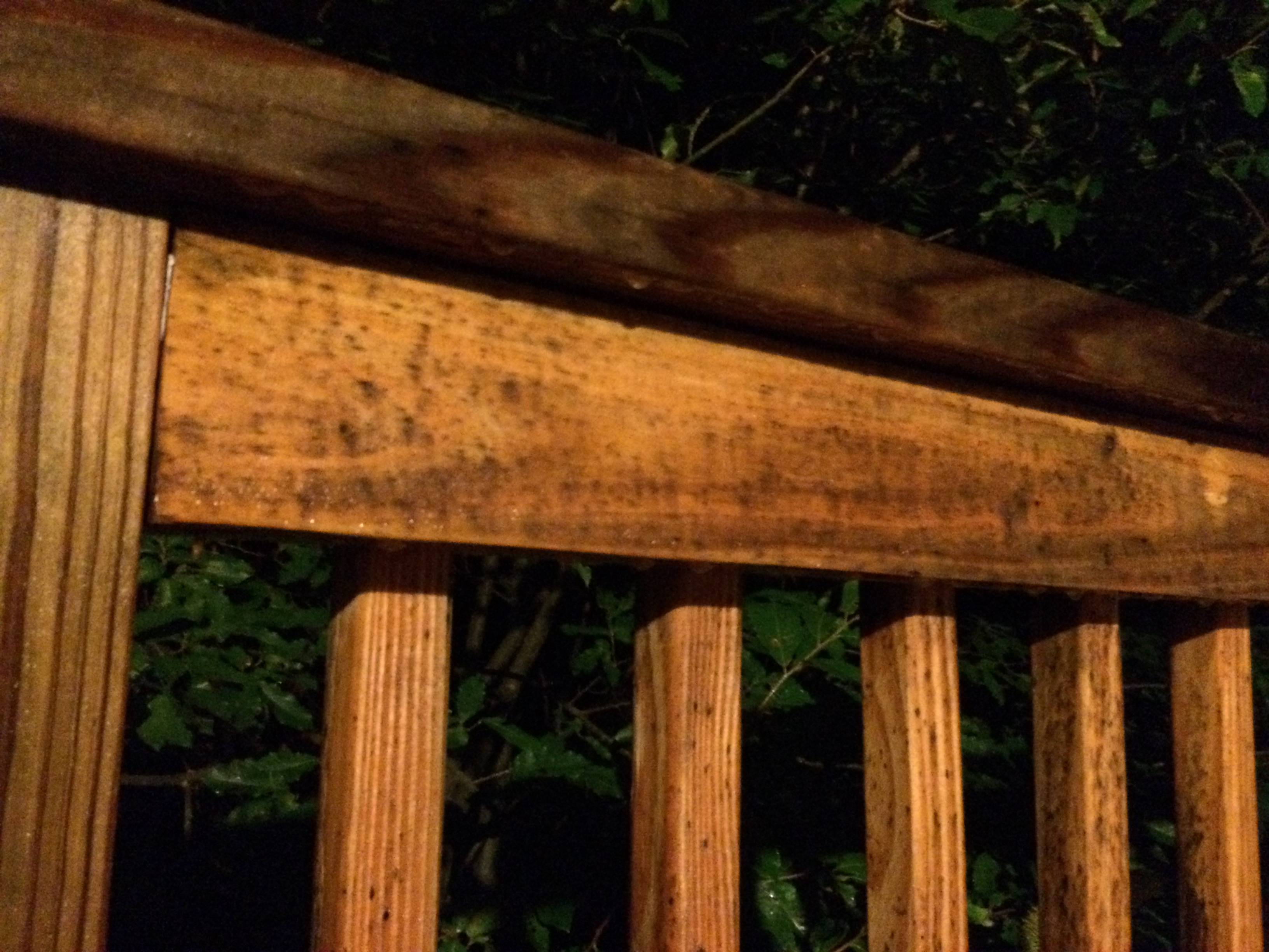

I have a two-year old deck that was never stained. It's pressure-treated pine and I live in a humid climate. The deck has lots of dark spots that seem to be mold or mildew, although they are mostly on the sunny sides.
This evening I used Defy Wood Cleaner and Defy Wood Brightener, but it doesn't look much brighter. For each product, I sprayed it on, let it sit (for cleaner, then scrubbed with a car wash brush), and rinsed with the hose nozzle. A small amount of the dark spots came off, but lots remain. I just tested two areas, one with chlorine bleach and one with straight Wood Brightener (oxalic acid, supposed to be diluted 4:1). I scrubbed, let sit 20 minutes, rinsed, and no change. My after pictures are below.
I also see furring in some spots and raised grain on the rails (picture attached) - maybe I used too much pressure with the nozzle? Or is that the dead wood I'm supposed to be removing? I skipped renting a pressure washer because I didn't mind scrubbing and figured there was less risk of damaging the wood.

You need to pressure wash off after using the cleaner. The oxidation/graying will come off and so will the mold. Brighten all after.
Definitely prep better before applying the stain. You can try a store bought cleaner but look for one that is a powder.

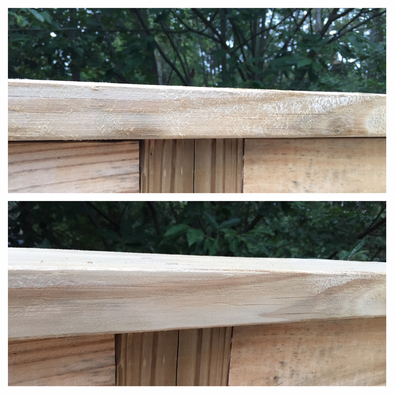

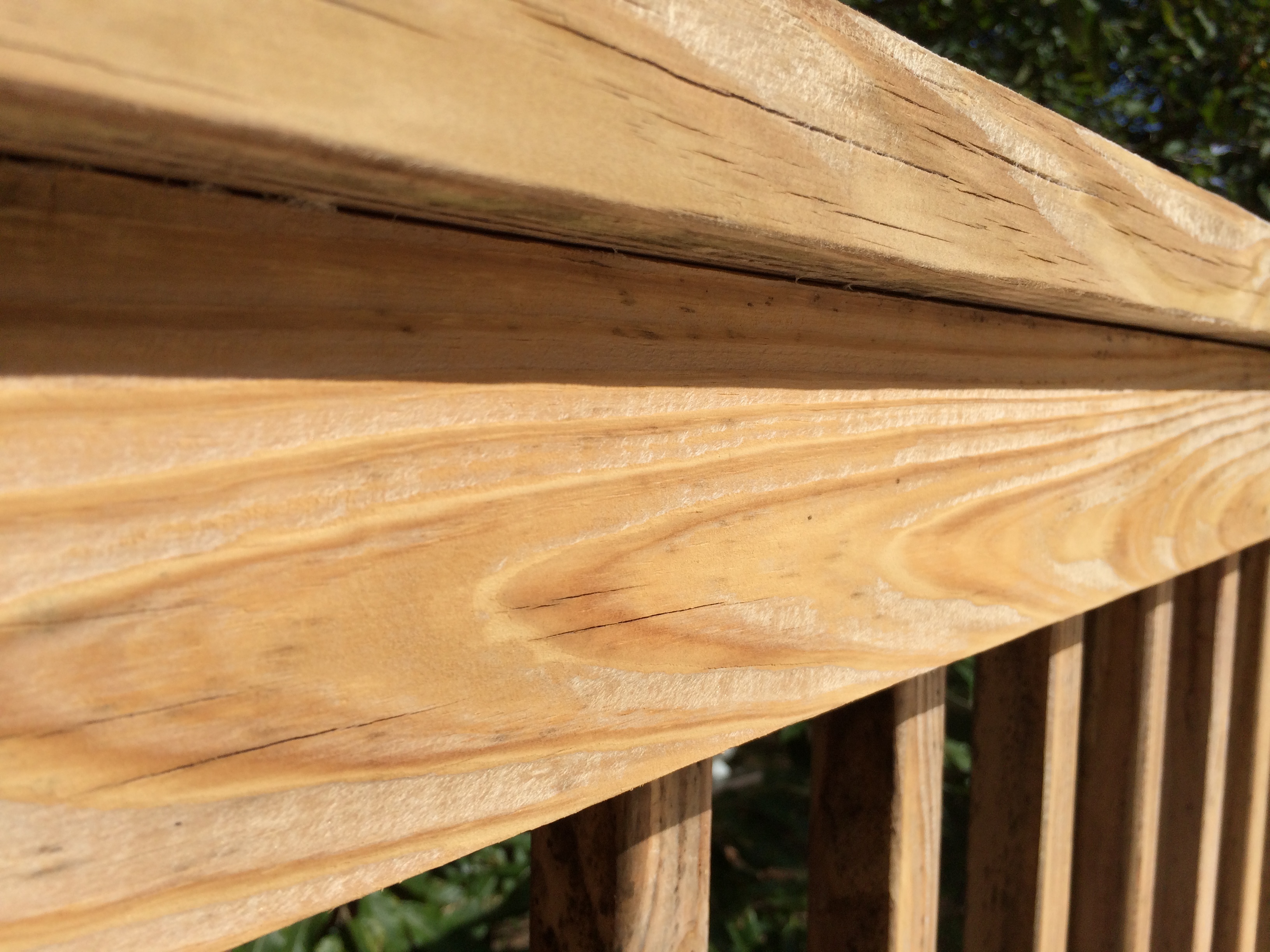

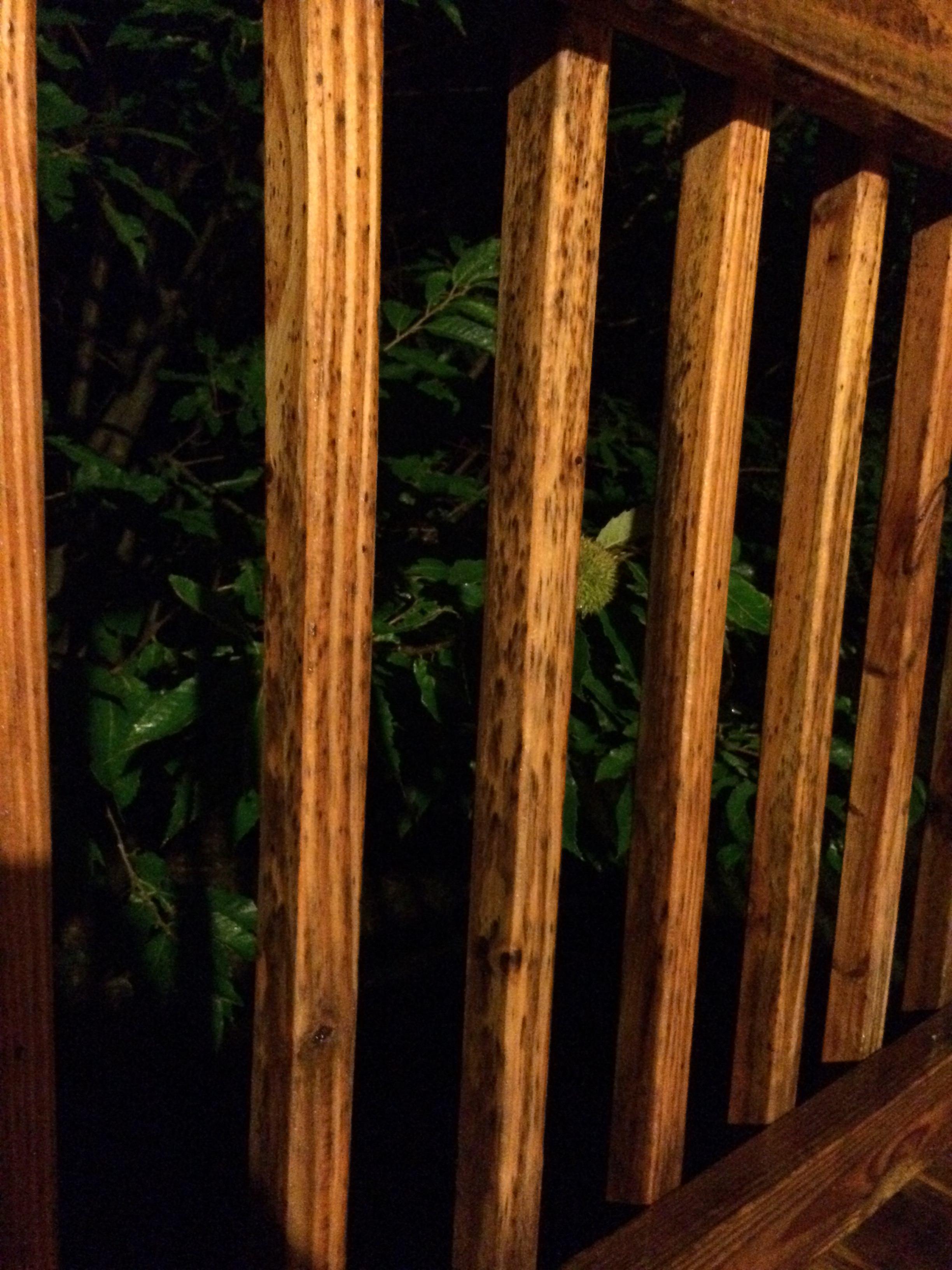

The deck now looks bright and new, but with lots of fuzzies. I'm sanding with 80 grit to get them off (using instructions from http://www.deckstainhelp.com/wood-fuzzies-furring-on-deck/ ), and I have a question about that.

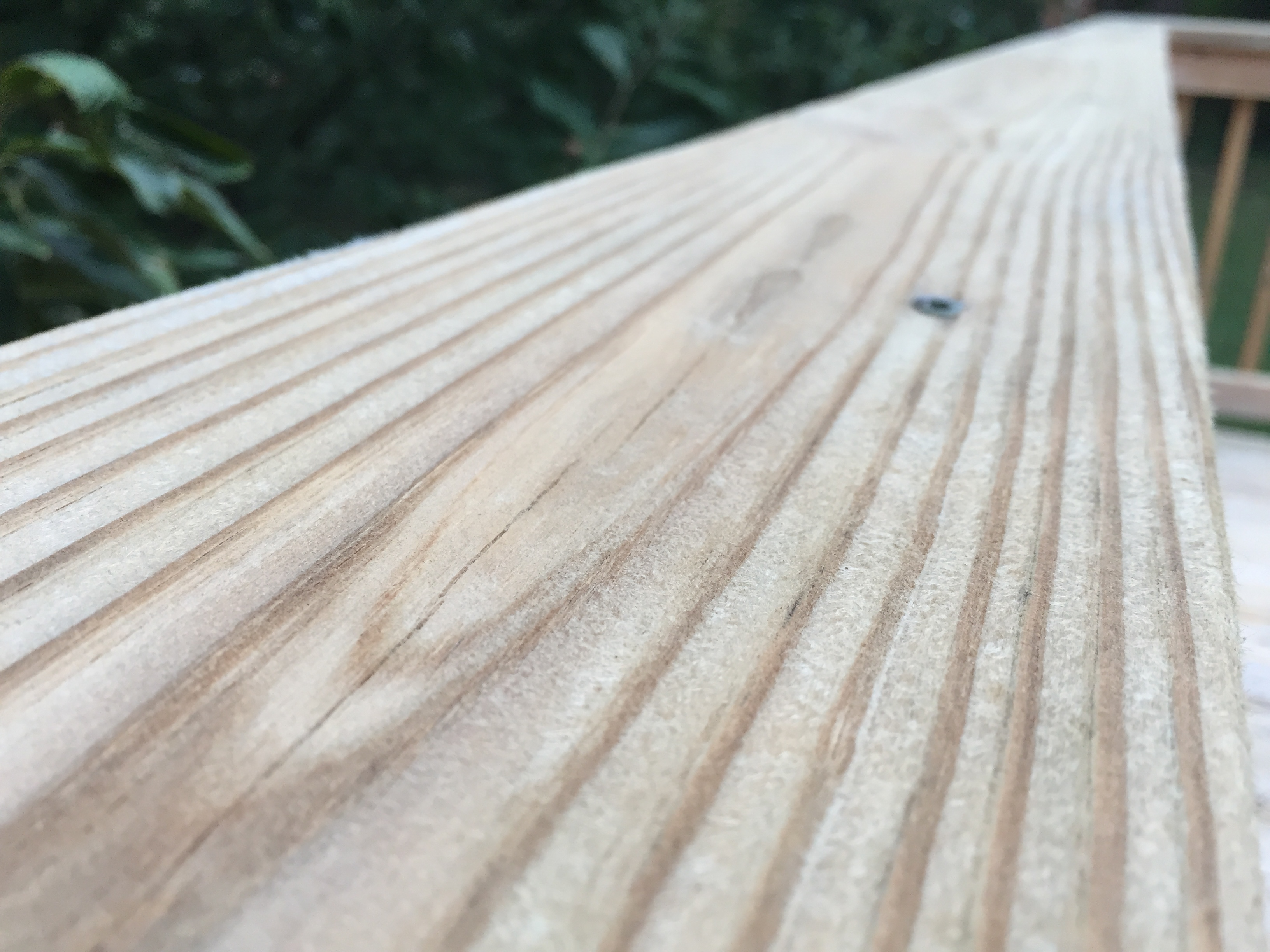

In many places, the amount of gray removed left behind raised grain. Should I sand that down to a smooth surface? What grit sandpaper would be good for that?
First image is before and after of removing fuzzies on a rail with 80 grit. Second image is of the raised grain. Third image shows how the fuzzies are down between the raised grain, so I might need to sand it all the way down to get rid of them.
Much easier to get a rotary buffer and use sanding pads. If you use paper, use 60-80 grit. You do not have to remove all the fuzzies as they will darken when you apply the stain.

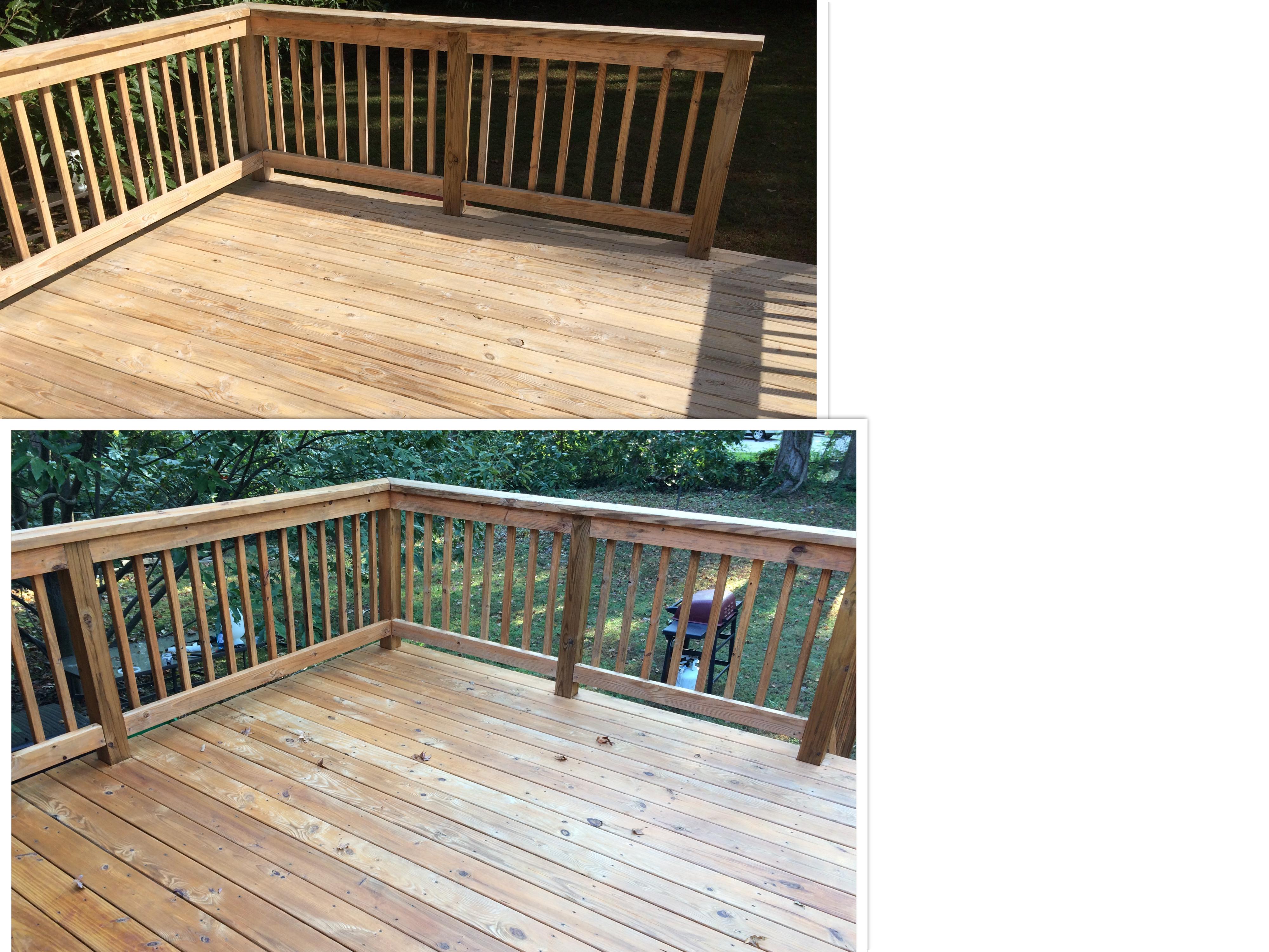

After a bunch of rain we finally had several sunny days in a row, which was helpful because the remaining steps took a lot longer than I expected. I sanded everything with a mouse sander because it was what I had and there was a lot of sanding to do on the rails. That took maybe 6 hours, not too bad. I was able to improve the raised grain areas and get off a lot of the fuzzies. Not all the mold came off but it lightened. Since it had been over 2 weeks, I cleaned and brightened again afterward.
My husband and I started staining the next day and it took about 20 person-hours over 4 days, most of it on the rails. I'm happy with how it turned out, but the deck boards are uneven in color and I'm curious why.

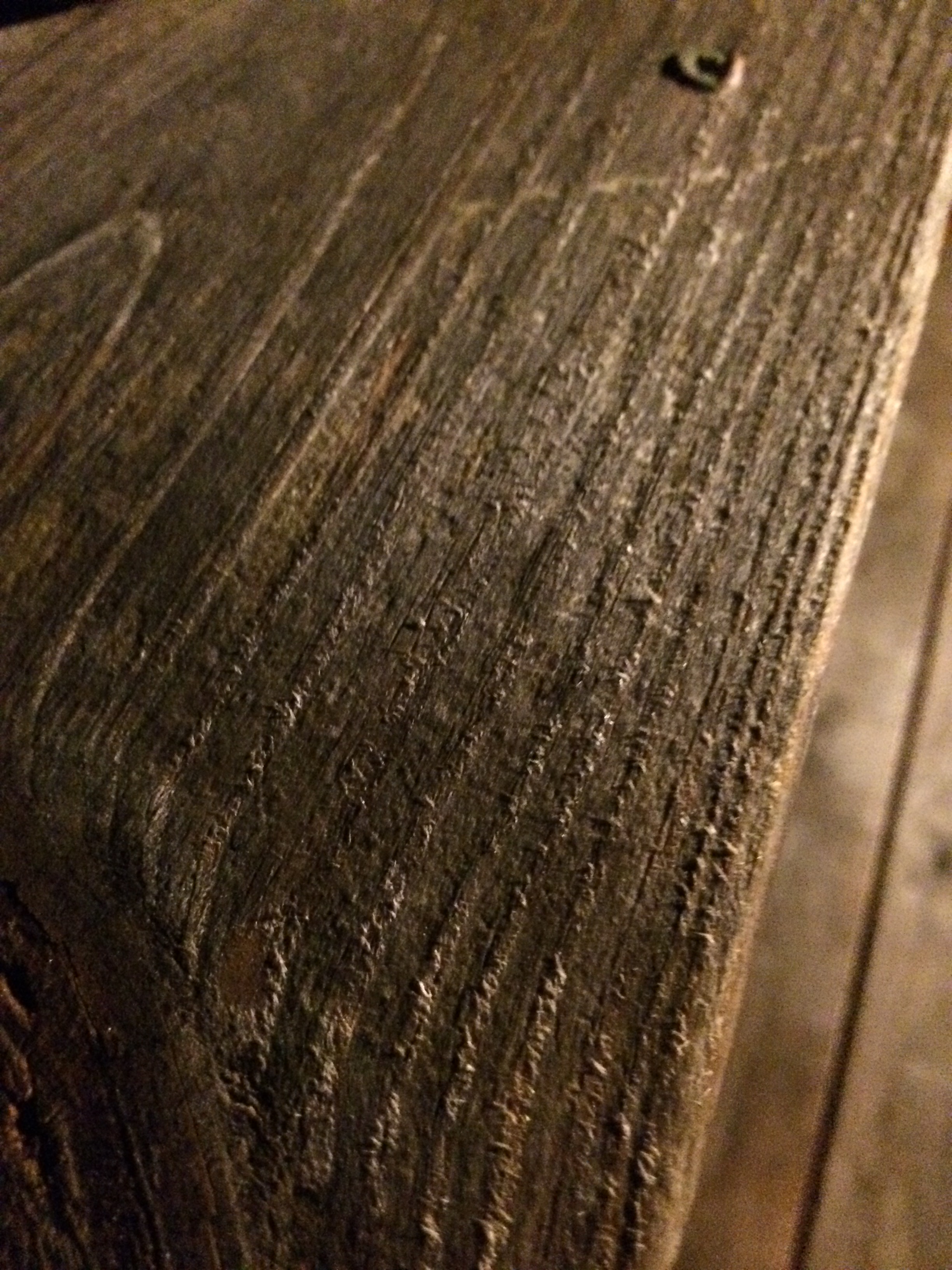

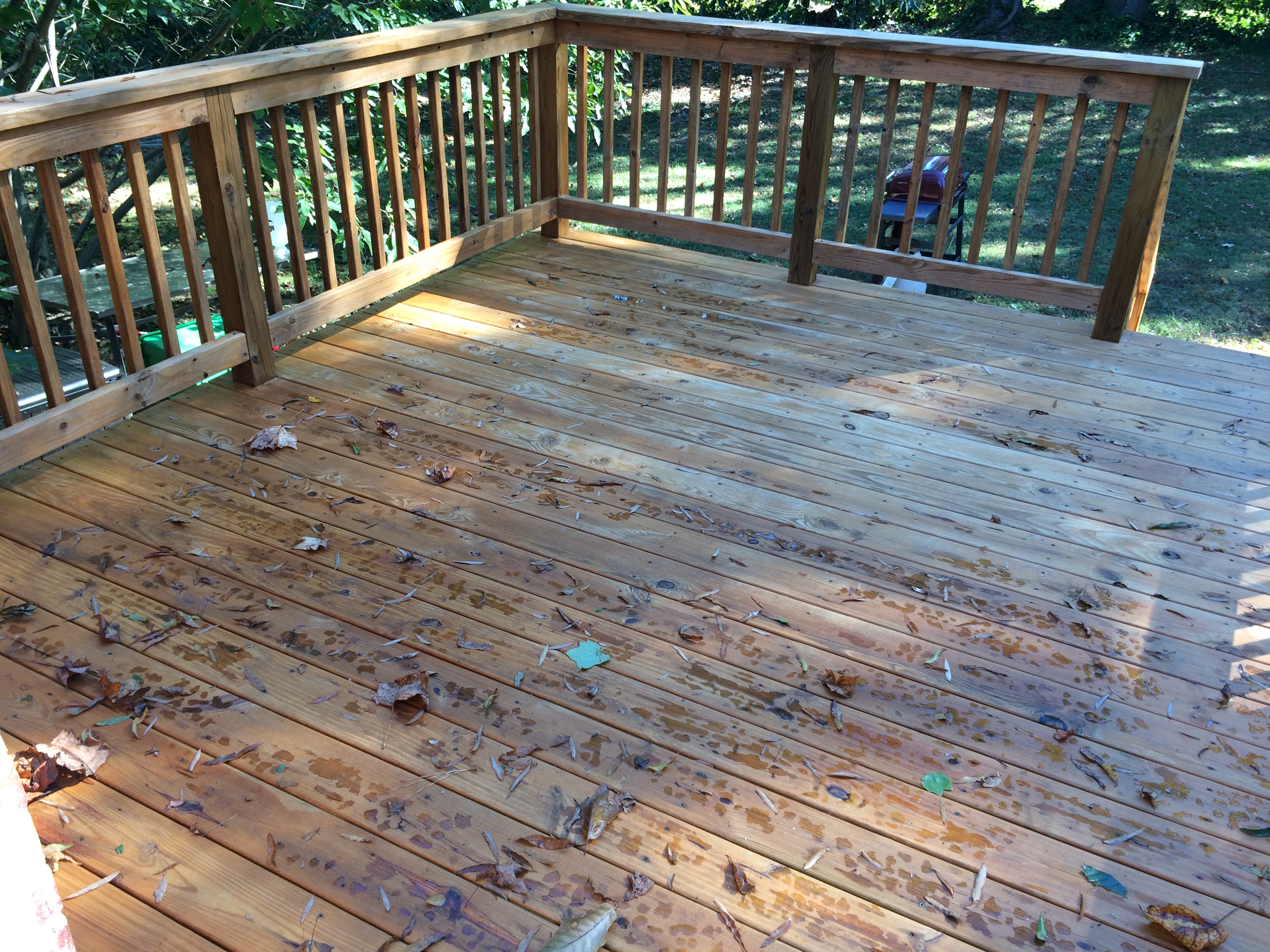

Photo 1 below shows post-sanding and post-staining. Photo 2 shows how water beaded up on the areas with deep color but not on the areas with light color. I assume that means the stain didn't penetrate well. (Photo 3 shows how the rails looked after sanding, just as a follow-up to my previous posts.)
We did the deck in 2 portions to meet the 20-minute wait time between coats. The second portion has uneven color and the first (closer to the house) looks pretty even. Here are possible differences:
1. We traded jobs of using the car wash brush and cutting in the edges - my husband brushed the boards on the first half, and me on the second half.
2. The timing might not have been exactly 20 minutes on each - I'd guess longer on the first half but I can't remember.
3. The second half needed more sanding than the first. (I used 80-grit sandpaper and I did clean and brighten again after.)
4. The second half looked to me like it might still have more fuzzies left than the first half.
Any insight as to why this happened? And should I try applying a third coat on those lighter boards now (likely to penetrate since water isn't beading up)?
Looks like the stain absorbed really well in those areas. Leave alone. In the Spring, lightly wash to remove any dirt and apply a light coat over the entire deck.
