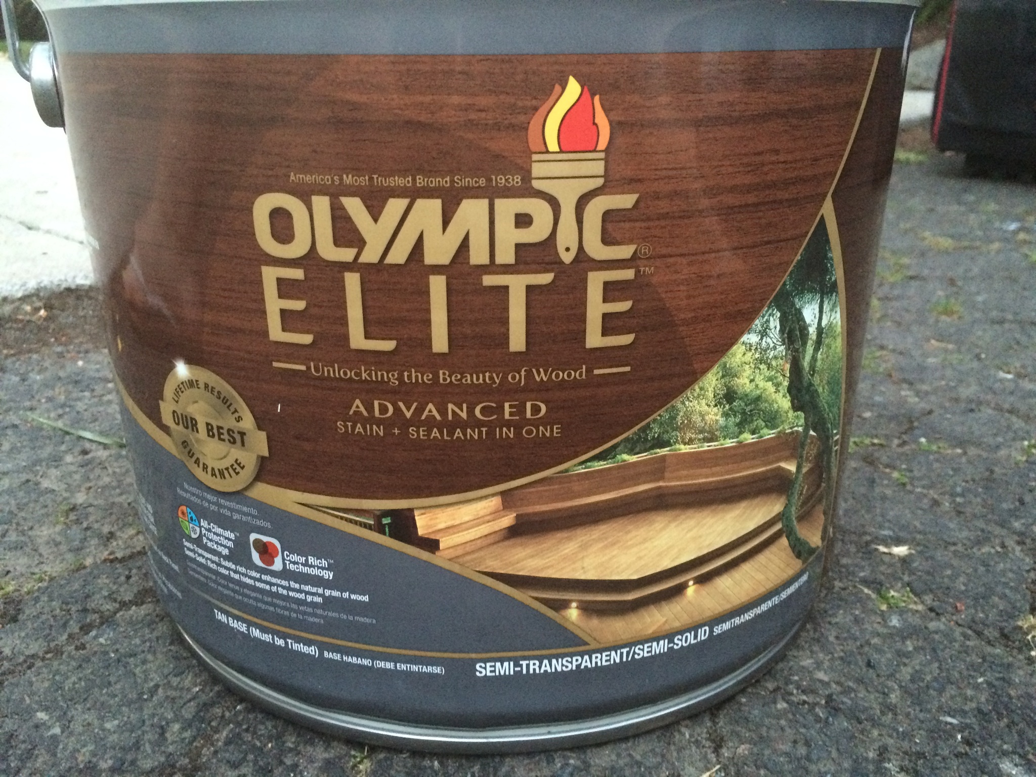

Location: Portland, OR
Deck is 500sqft, about 15 years old - partially covered, partially full sun. Well maintained with yearly "re-staining" by the homeowner. Two years ago, it was starting to show it's age, so we were hired to sand and stain it. We pulled every board (interior screws were used previously which were snapping off and rusty, they needed to be replaced anyways) and sanded down to bare wood top and sides of all boards. Stained with Olympic Elite, which faded after a couple of months.
Side note here- is newly sanded (with 60 grit paper) old wood more porous than new lumber? How do I find proof of that?
The next summer, we cleaned with Olympic Cleaner, then pressure washed. Waited a few days to dry and then stained (lightly with sponge applicator). Dried tacky, oily, and splotchy. Never completely dried. Side note here:the stain from the previous year was no longer any good and so we had to buy more at $50+/gallon.
To try and rectify this, we lightly sanded and tried again. Dried the same way, just now with dark and light spots.
I used to consider myself moderately experienced- yet this stain is not responding in any way I've seen before.
What on earth do I do now?
Posts: 3343
The only thing you can do is remove all and start over. It is not penetrating into the wood and is not curing/drying properly. Basically you have too much stain on the wood. You cannot add more as it will just make it worse. Stripping may remove some of the stain but you will need to sand to get off all of these layers of stain.
