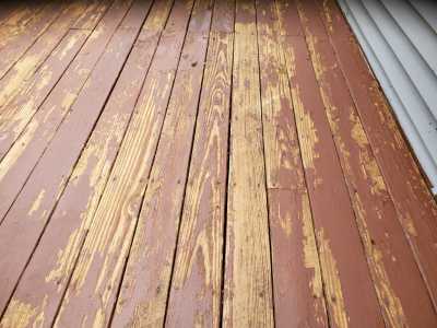

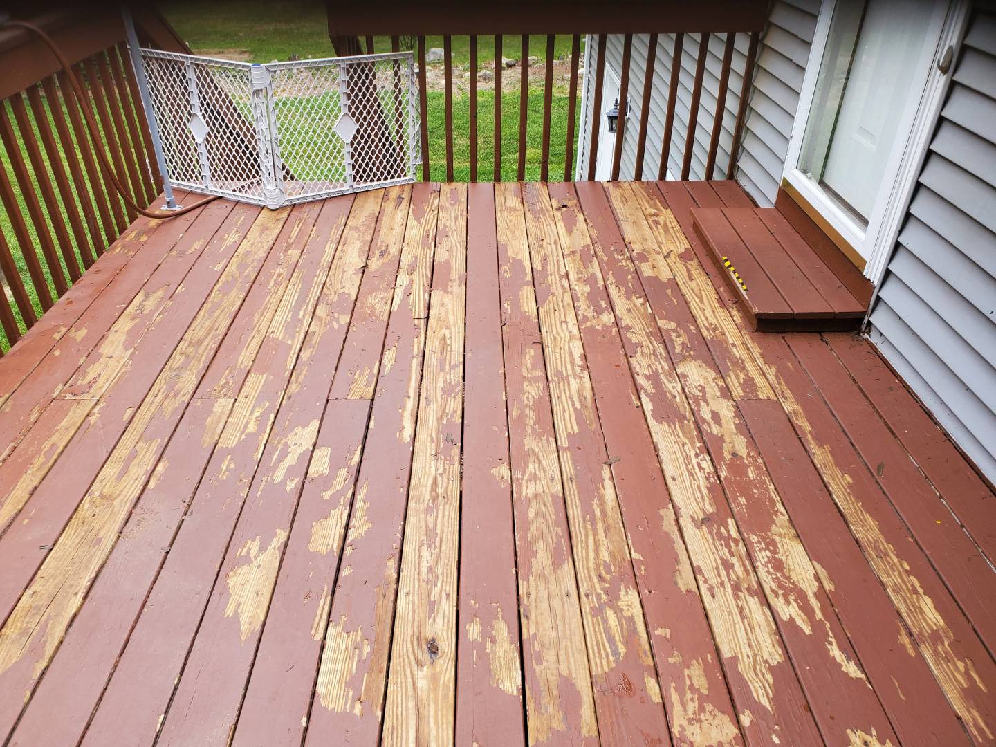

My 20 yr old
20230515 165150 (1)
deck in central CT. is in good shape. I have recoated it with Behr every 2 or 3 yrs. I went from transparent to solid stain. If I use a blower I get edges lifting  on stain and bare wood under it. I have been peeling and restaining. I`m wondering if I should or can use some Premium coating over it to stop the peeling. . Its about 40X10.  Restore a Deck looks good but who sells it? And will it stay down over the Behr ( that dosen`t seem to want to come off except for the peeling) or  will I need to spend $$$$ to redo it with Restore every few years?A local lumber yard recommended just going over it with BM Arbor coat that seems to get a bad rep here.  Or...If any has a recommendation I`ll appreciate it. Regards Thomas
Posts: 3369
You cannot fix this unless you fix the root of the problem which is the peeling Behr. To fix it, you have to remove it and start over. This would require heavy stripping and or sanding.

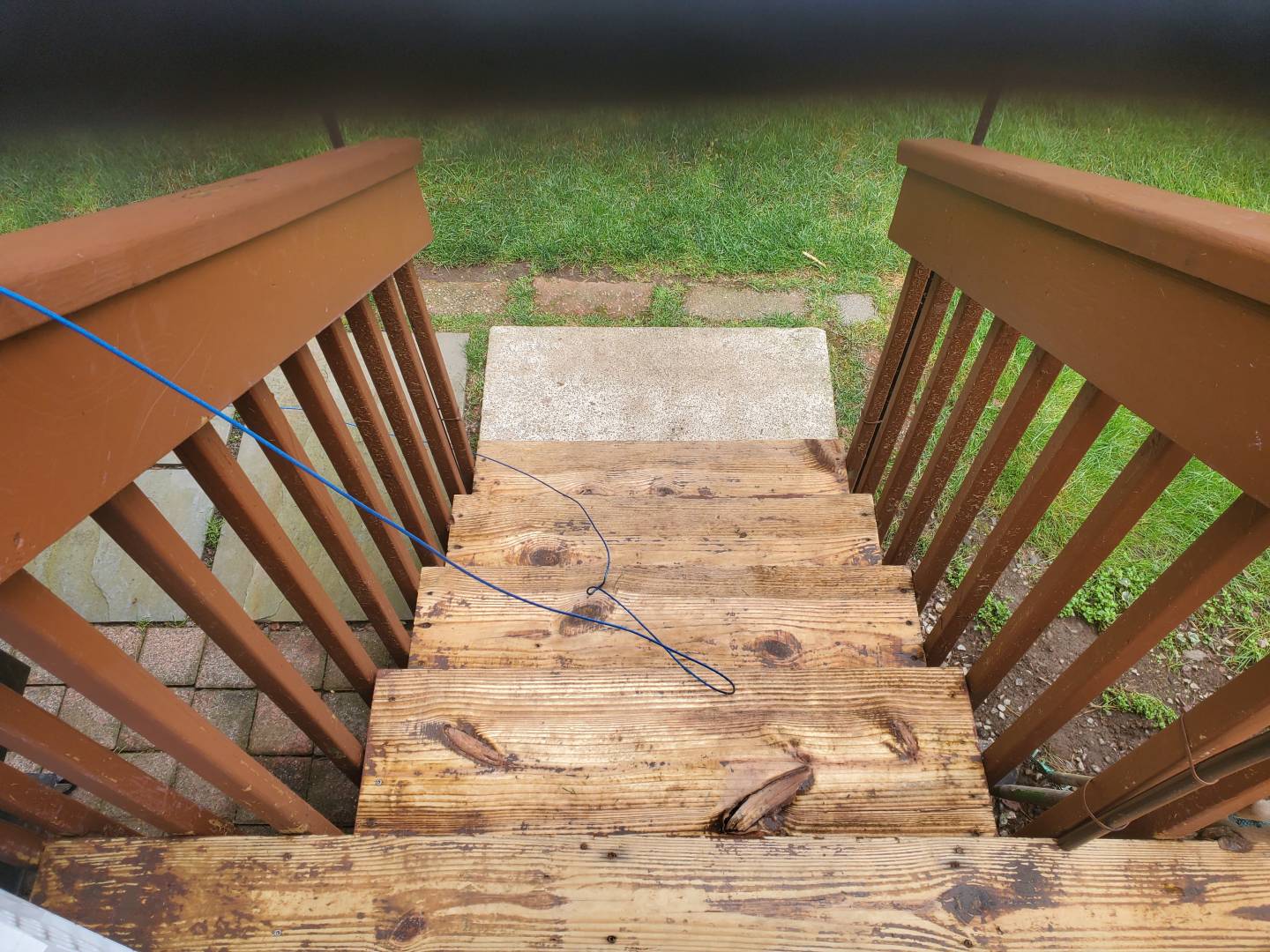

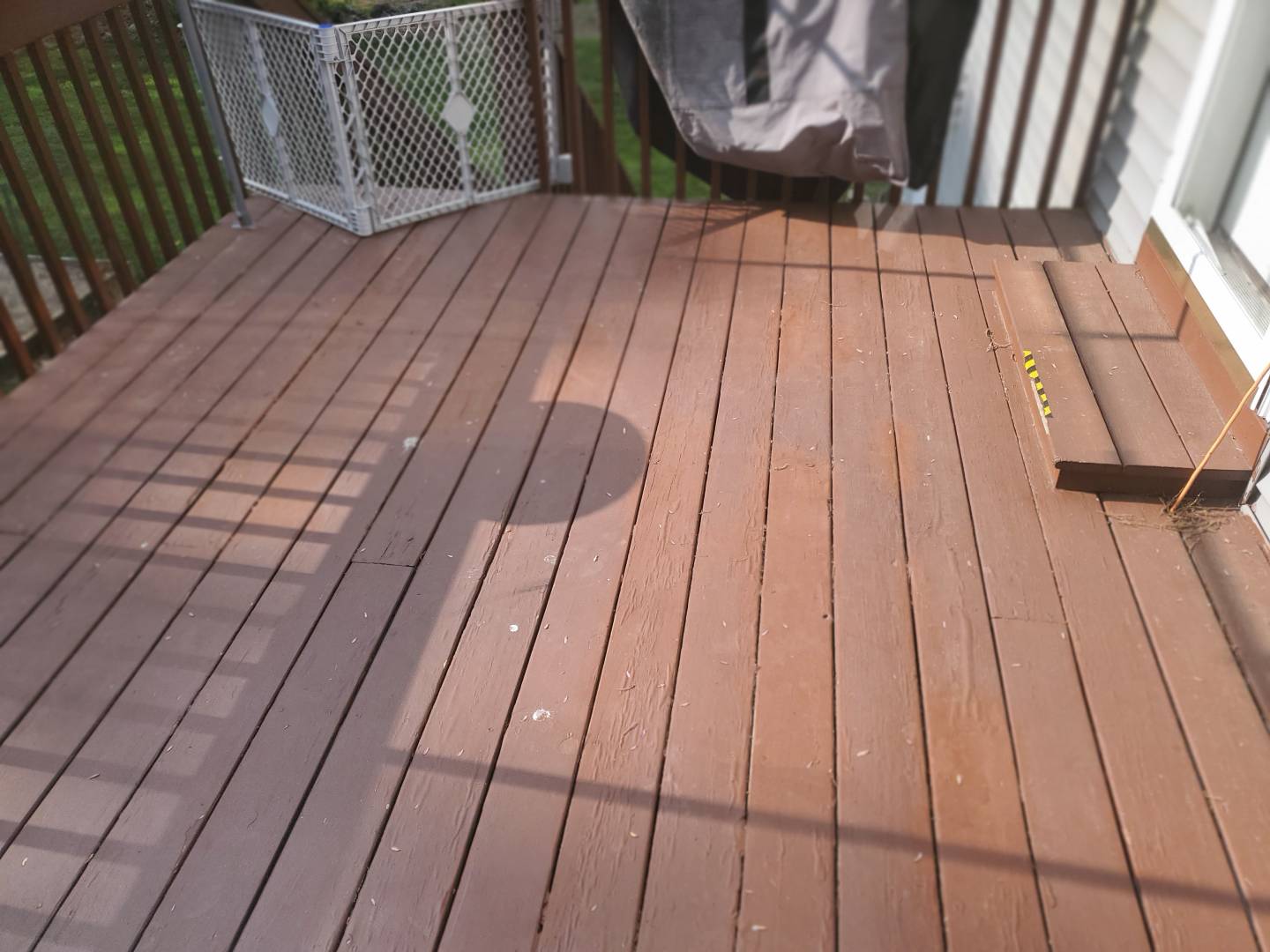

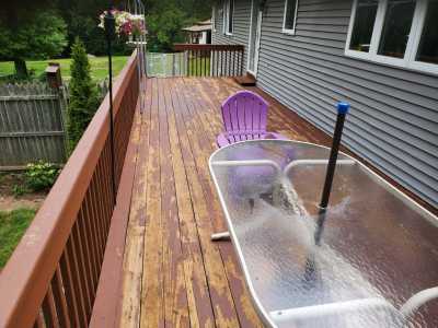

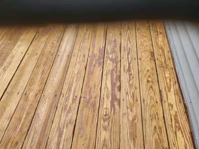

Hi Scott  So I purchased 4 gal of RAD deck stain remover. I only put down about 1/2 gal as a test with a brush. It was like spreading Greek Yogurt!I can imagine trying to spray it.  It came out white but turned clear. I left it on about 20 hrs in the right corner of my deck, but not the step. It didn`t seem to work that well.. possibly I did not put it on thick enough? It did bubble and soften some stain but not enough to clear down to wood. Some areas did not even bubble. So after hauling the power washer up to take of the RAD, I continued to clear away the peeling areas.The pictures show where I am at. So my question now is should I keep going with the RAD remover in spots where there is still solid stain?I can try a heavier coat....or  Do I rent an edge  sander? I`m thinking if I got off all the loose or peeling parts maybe I can just  recoat with solid stain? But probably I should continue until I get to the wood somehow. I was thinking about the 2 tone suggestion .....Any advise on continuing from  my current  point?   Thanks

I assume you mean the RAD PaintStrip, not the RAD Stain Stripper? Did you test spot first to determine how thick to apply and the needed dwell time?
From Description
Before general use, test on a small area to determine compatibility, required dwell time, and coverage for desired results. For an estimated 5 or less coats, scrape a section of the area with a stripping tool after one hour of dwell time. If not easily down to wood after one hour, leave on longer and test again hourly. For 10 – 15 coats of paint, cover with plastic and wait 24 hours to test. For best results, cover the stripper with plastic and do not allow to dry.
Two tones are great if you want easier maintenance in the future and you can get the rest of the solid off the floor by stripping and or sanding:
Tips on recoating with a solid stain:
(@fishman57)
Posts: 10
Yes I did use the Paint stripper! Looks like I bought the wrong remover!   I did test but didn`t see much activity after 20 min so I left it on.It was fairly thick coat.  And a small area. About 3X5. So I guess I will have to get the stain stripper!(oops I guess there isn`t one!)  And try again. If I use the right product ( Stain Remover), should I try to remove all the stain areas with it or sand?

@fishman57 You had the correct stripper.
Posts: 3369
@fishman57 We would strip as much as you are able to with the RAD PaintStrip and then spot sand after if needed to get off the flooring.

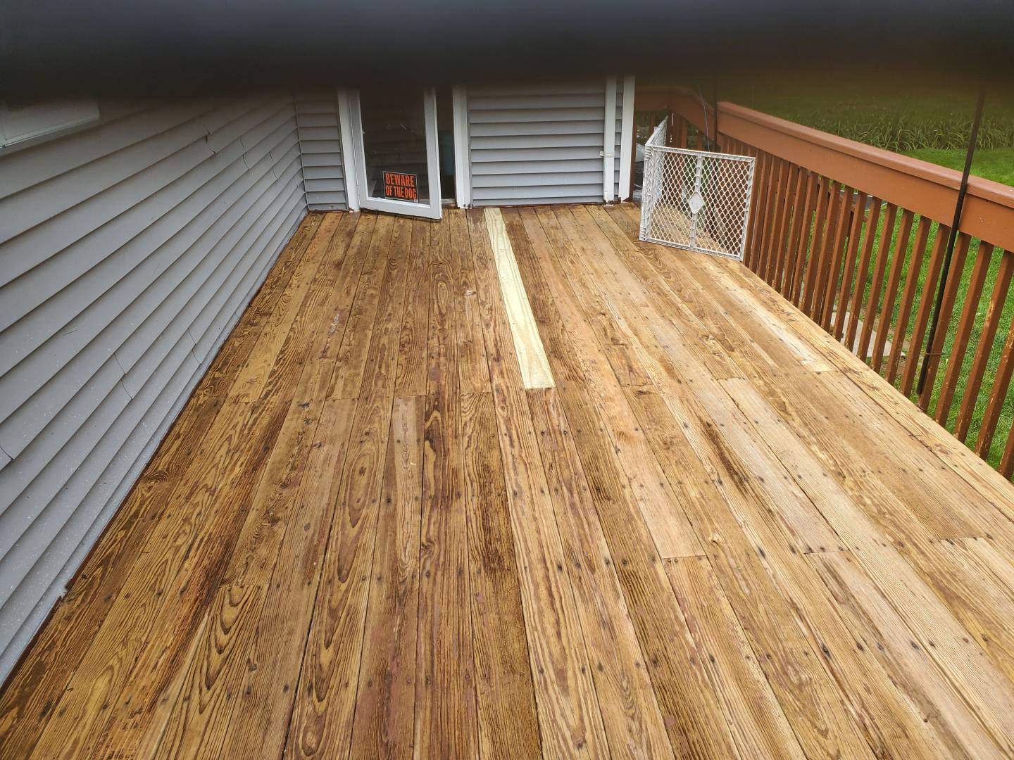

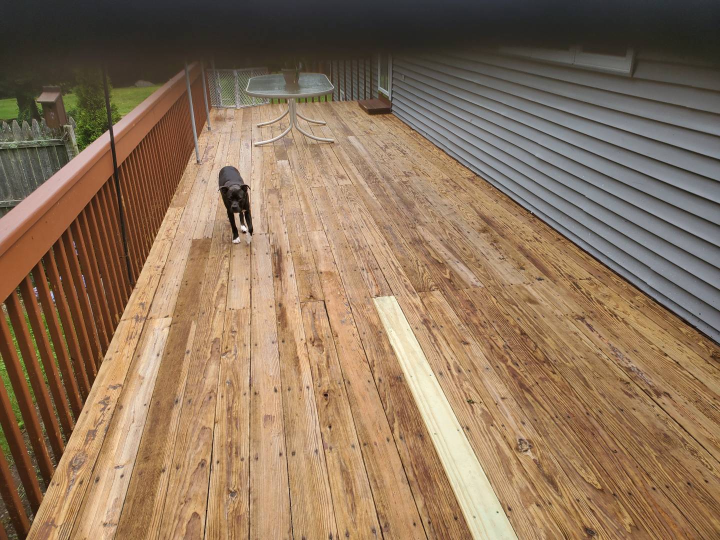

So I have removed most of the solid stain using the RAD. There are a few tough spots that need either more RAD or sanding.I choose to leave railings and spindles solid as they are mostly good. I`m leaving the 12 back stairs as no one uses them or sees them.Stripped the 3 to the yard. I had to replace a rotted floor board,and handrail.I was not able to complete this yet as a few personal issues arose. But I`m back at it now. I ordered the cleaner and brightener and a large brush. I think I need a rented floor  sander ,and borrowed power hand sander. I think the power washer beat the wood up pretty good in a few spots. Tried to back off , but not great removal results ,so hoping sanding will help Alot! A few questions as I proceed:  Should I use RAD on the stubborn spots or go to floor, hand sanding? How to I deal with the new replacement PT boards that really stand out? Can  sanding or brightening  help  match?  I think with the age and condition I will order oil based semi transparent in a mid or darker shade.Any ideas on that? Should I plan on waiting for dry warm weather for a 2-3 days first and try to sand and stain ASAP after ?I will read up more as its been awhile since I was working on this. Its been raining on and off . Despite covering the vinyl siding with plastic the power washer did get RAD spray onto it and I have some white speckles I belive are the gray color bleached out on the siding  by the RAD.Not much I can do except replace siding  I think? Didn`t think it would go up that far! Thanks for your help ,I`m learning alot and getting closer to finishing.. I hope
