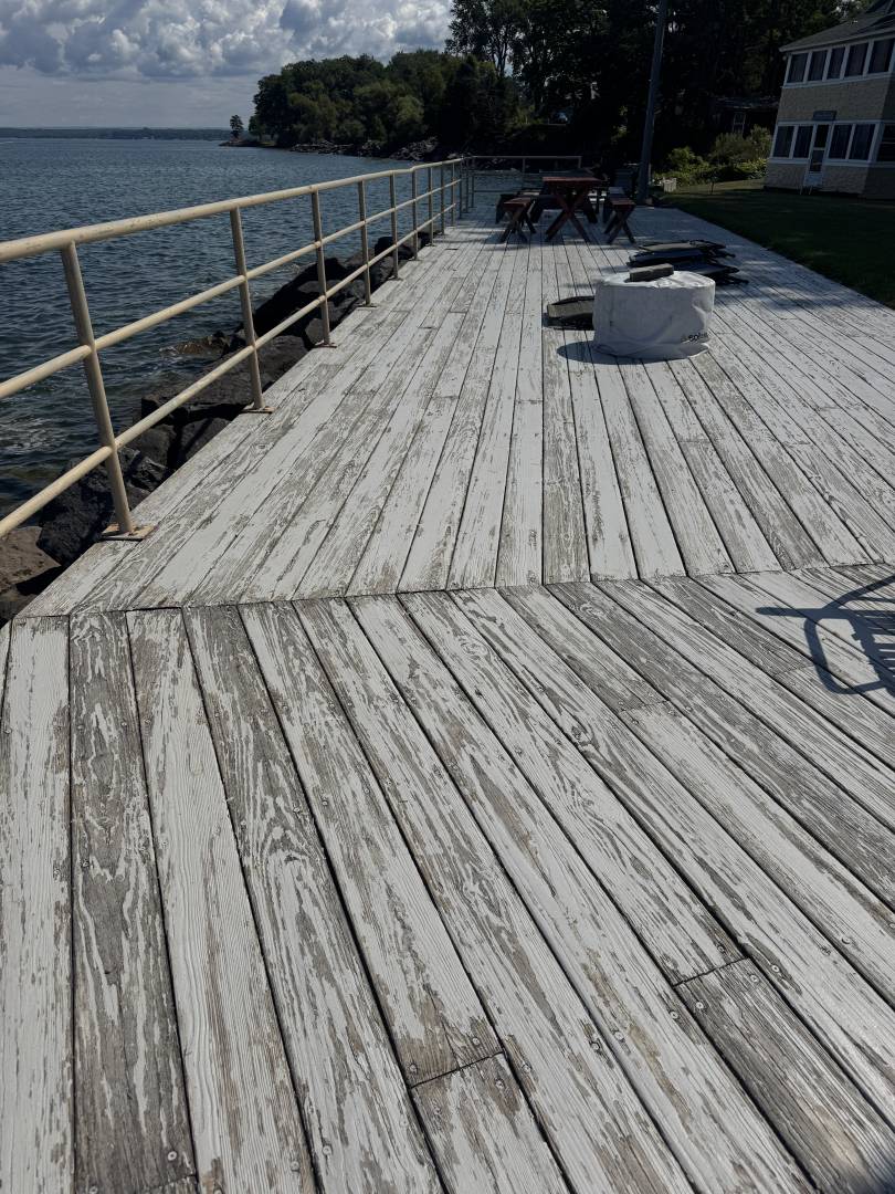

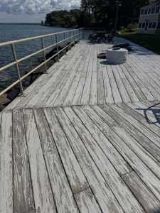

@deckstainhelp photos:
IMG 4268
IMG 4269

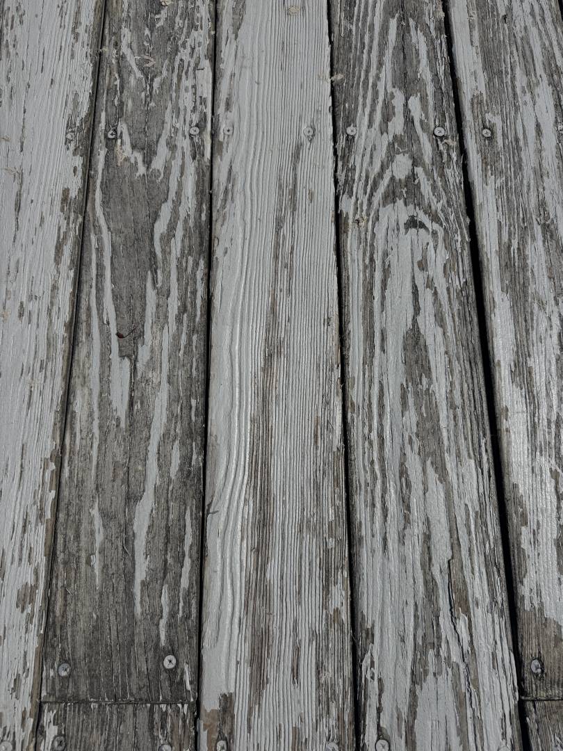

Dear Scott,
Please see photos of the deck. I rented a floor sander, started with #60, however the sander isn't working very well (although it may be the user!) as not much is being removed. I plan on returning this machine and renting another. I'll try a coarser paper as well. Any guidance from you would be welcome!
thanks,
Kathy
Posts: 3384
Is that paint or a solid color stain? You do not need to remove all of the old solid stain (just what is loose and peeling) if you plan on going with a new solid color stain in gray. See these tips:

ARMORSEAL® TREAD-PLEX Water Based Acrylic Floor Coating
Deck Gray
Calcium Carbonate ≥10 - ≤25 1317-65-3
Titanium Dioxide ≤5 13463-67-7
2-Methoxymethylethoxypropanol ≤3 34590-94-8
Carbon Black ≤1 1333-86-4
Heavy Paraffinic Oil
I would be relieved if in fact I don't have to remove all this paint!
Kathy
Posts: 3384
It doesnt really say, but it does look more like a paint than a solid stain. Sand off as much as you can then use a solid-color deck stain in gray after:
