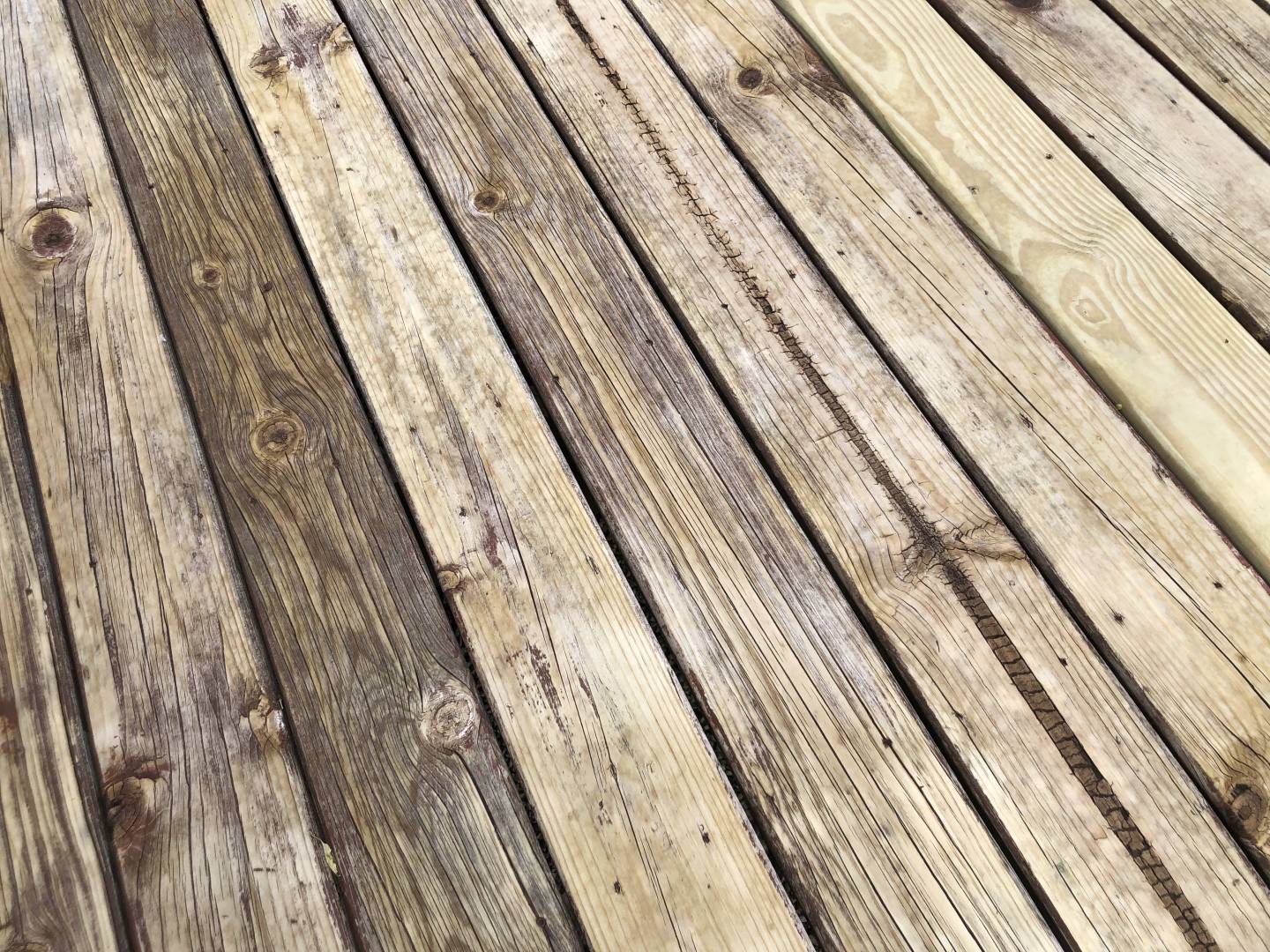

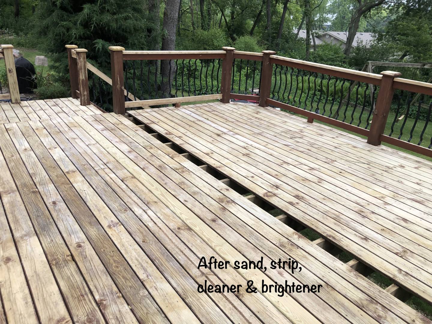

We live in  Illinois, have 17 year old (2 new pieces), pressured-treated decks, part shade/sun, no mold/mildew.  Previous stains have always peeled. Last was Behr Premium! semi-transparent which came off few months during snow.  So now its our 1st time using cleaner and brightener chemicals for prep: we have orbital sanded down to bare wood, stripped whole deck to try to get rid of stuck stain (did not work), dried and sanded even more, cleaned and brightened. Is splotchy now so thinking have to do more brightener (faulty pump sprayer). Rain for past few days, but if you think this might be is ready after more brightener, we are now trying to confirm the stain choice.  I thought you were recommending the 'penetrating oils' to your readers .  But now I see you are also recommending the Restore a Deck water-based penetrating stain.
Which might be best for our situation?

You do want a penetrating stain so that you do not repeat the issues you have had. RAD Stain, Armstrong Clark, or TWP 1500 Series for IL would work and are penetrating. If you want oil-based, then the AC or TWP 1500.
What are you doing with the railing that has not been stripped? You might want to consider a two toned deck.

The non stripped railing elements yes will remain and get maintained as is since that stain application is working.

Does not matter if oil or water as long as it is a quality penetrating stain brand. You can use the TWP 1500 in IL. You still have some old stain on the floors in that last pic so redo the stripping and then brighen all when done.
