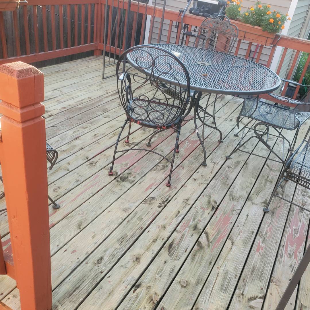

Our deck is in desperate need of some tending too. We would like to DYI but need some guidance as to if we need to use some sort of stain remover since we stained last year but majority of the stain came off of deck (see attached photo). If so, what remover do you all recommend. We would also like to purchase items to complete the pro in a physical store such as homedepot, lowes, walkmart, ace hardware menard etc. May you please send suggestions.
20220520 153943
20220719 065503

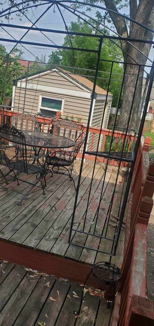

 image one is our deck prior to power washing it . The second is how it looks now after the powerwash.
Posts: 3381
Strip off as much as you can and then brighten the wood. Stain over the intact solid stain with a new solid stain:
There are not any decent products in big box stores, sorry.
