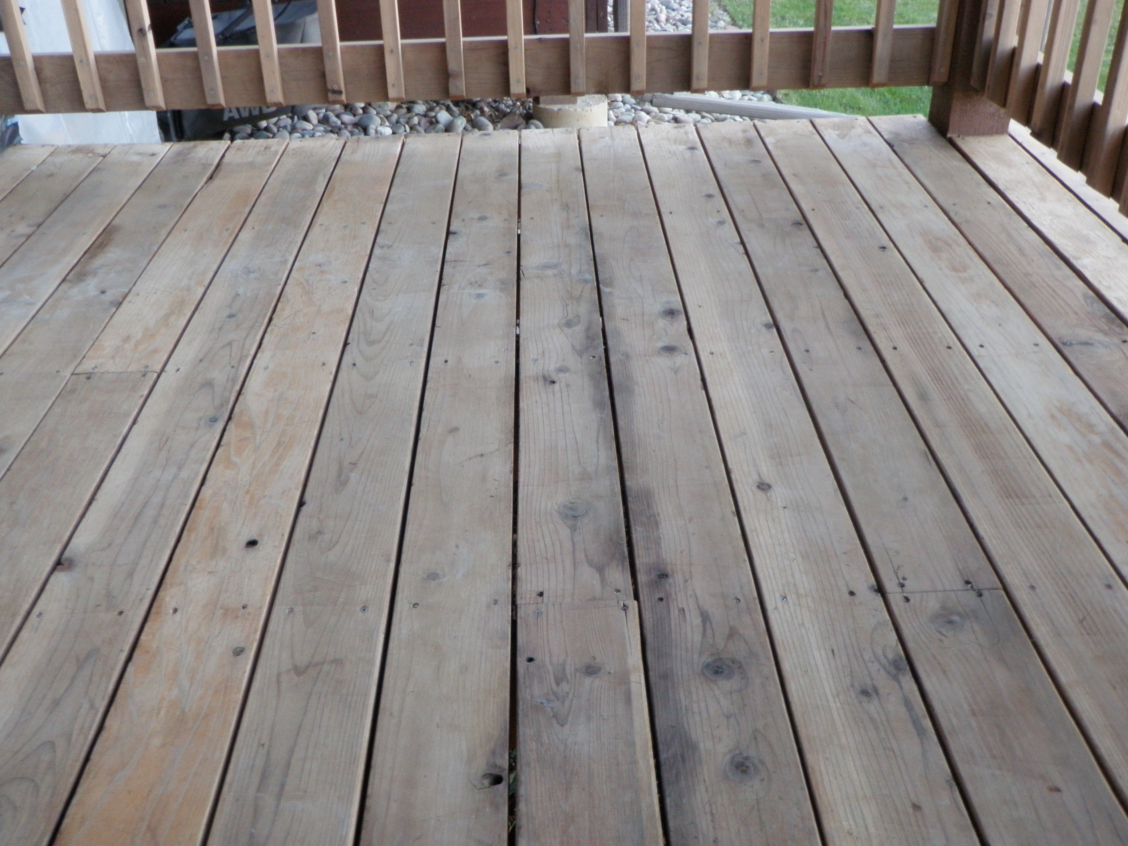

I’ve finished stripping and brightening my deck in preparation to stain with TWP-100. Also sanded the railings with 80 grit. Attached is a photo of the stripped/brightened flooring. Planned to sand with a rented orbital deck sander, but have quite a few un-recessed screw head, which are Phillips, and can’t be tightened further. I did a few boards with a hand orbital sander, and calculate I can do the deck in about 8 hours. Here are my questions.

1. Yes I would replace the screws where you can.
2. Too smooth and it will not absorb very well. Try the 60 grit and use a deck cleaner/brightener after the sanding to remove sand dust and swell the pores.
3. Yes
4. Maybe. Old trick and not sure as to the effectiveness
5. Honeytone is lighter then the 101. Darker colors do not hide imperfections but can offer slightly better UV resistance.
