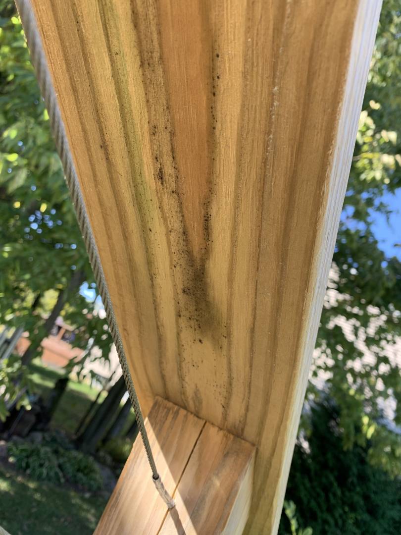

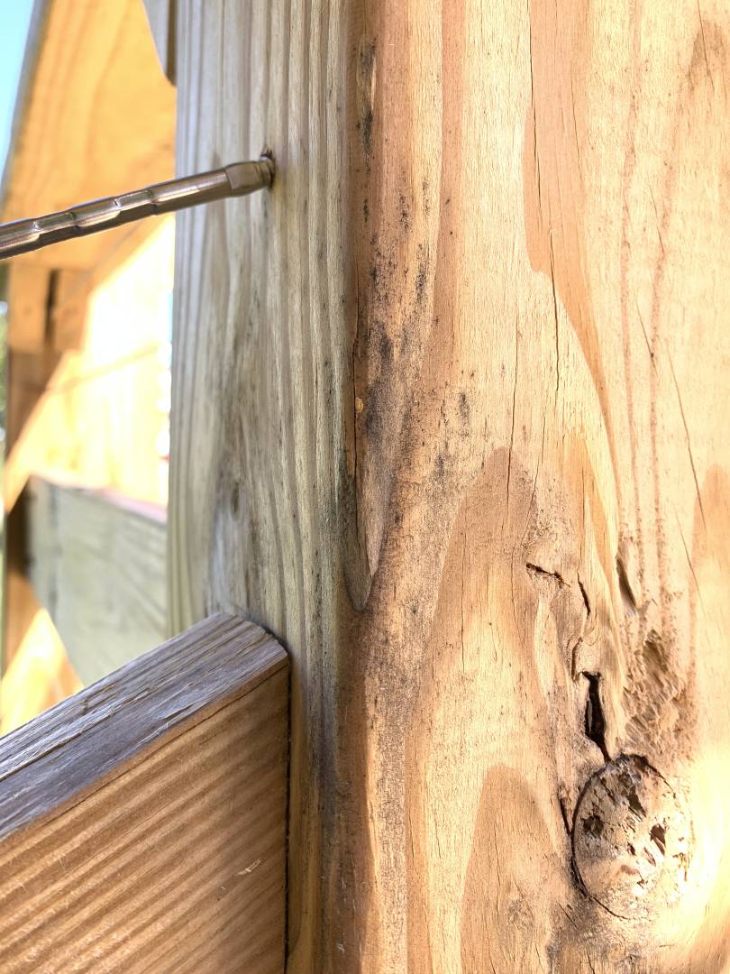

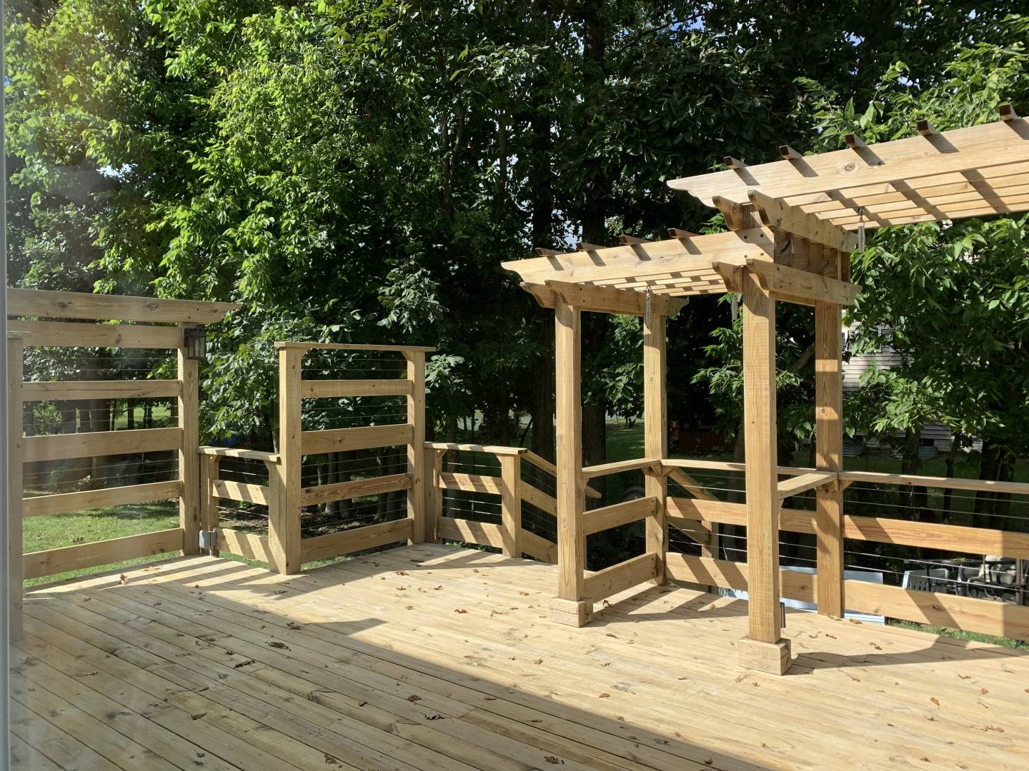

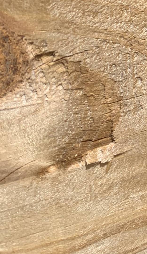

pine deck built. Pergola, metal skirting, wire cables. It sat from August 2021 to June 2022 before we could get a contractor to agree to come out to stain. I bought RAD cleaner/brighter and was very careful to point out instructions. Well the contractor came in and used RAD but with very aggressive pressure washing and knocked knots out, split and badly splintered wood, left corners barely hanging on, and yes furring on every board. I’m not sure the brightener was used right because while some boards now look like toothpicks, some are darker than they were.

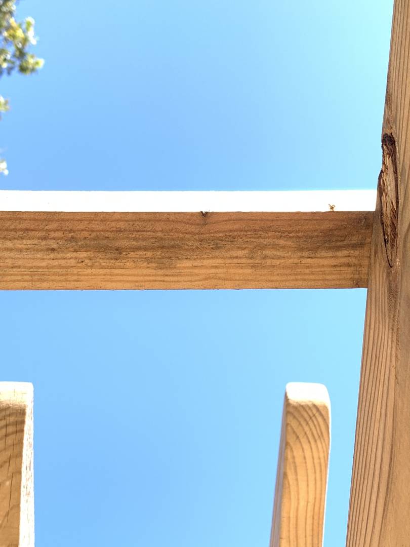

We then had to hire someone to sand when it dried to try to correct some of the splitting, splintering,  gouging, and furring. Then rinsed and let dry. It’s been more than 4 weeks now, and deck floor boards are graying. I just looked again and there is the presence of mold in crannies and undersides of hand-rails that was never removed in spite of the overly aggressive approach to cleaning most of our deck.
We need to know if it’s safer to wait and get another contractor to clean with RAD in late spring after an Ohio winter (wet, snow, and ice) and or should I go try to spot-clean what I can and let this guy stain now in two days? Temps will be mid 70s during the day but mid 40s at night for a two day timeframe this week. I have 1.5 days to clean and get it dry if I spot-clean.
The concern is the condition of the wood if we go all winter with no stain after it’s been so badly damaged with aggressive washing and subsequent necessary sanding?
Please let us know if it’s better to stain now knowing that it’s not as clean as it should be or if it’s better to wait. Should the wood be okay to wait all winter and go through the cleaning process again in spring even with all it’s been through?

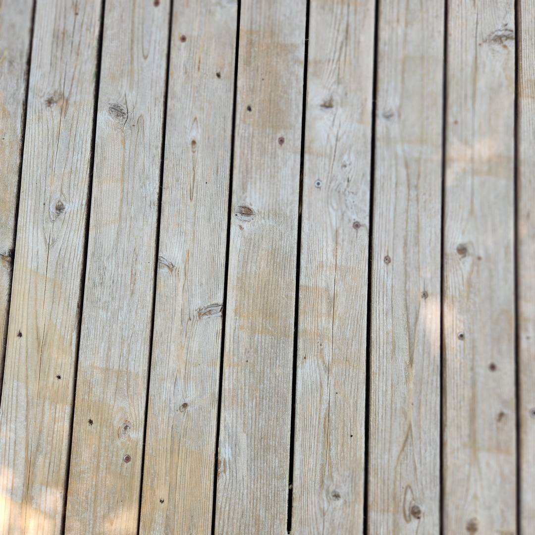

pics of current mold spots and, part of the deck after it was sanded and one small example of the reason we had to sand it (this pic is of extreme furring and splintering)

You cannot spot clean. Best to do it all correctly in the spring.

Now that you know what the deck has been through, what is the most gentle but effective approach to prepping the wood for Armstrong Semi-Transparent Oil Stain in the spring, then? I’m looking for product names, order and method of application/technique including any wait/dry times and what to do if the dreaded furries pop back up.
I know now not to go ahead with Armstrong on top of fuzzed up wood. A test board looks like old chocolate with uneven splotches and what looks like waxy white film all over. So to anyone that thinks you can just ignore the furries and stain anyway.. it won’t work.

Posts: 3343
Pressure wash with water and brighten the wood should work.

1200-1600 PSI with 25 or 40 degrees tips. Using a deck cleaner as well will help.

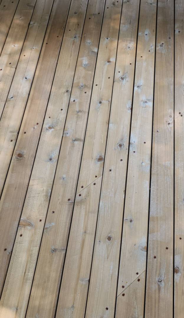

We cleaned our cedar deck with a cleaner/brightener and after power washing there remains a stubborn white residue.  Do you have any way to cleaner the residue off?

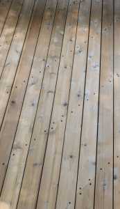

The deck is two levels.  It is cedar and
20230623 143708
20230623 145213 (2)
one level is 1 year old and the other is 5 years old.  Neither has been stained.  I used a cleaner and brightener combination and power washed it off.  The newer section cleaned up with less white residue, but the older section has quite a bit of white residue.  The manufacturer of the cleaner said I might try a stripper.

Posts: 3343
That is oxidation that you did not fully remove when using the cleaner. Redo the prep and make sure to use a pressure washer while using the cleaner. You may have to get a little closer to the wood when washing.
You do not need a stripper.

I'm curious as to what you think would happen if I were to just stain over the oxidation? As you suggested, I re-cleaned a small section and power washed it off and it didn't remove it. I'm at a loss as to what to try next.
