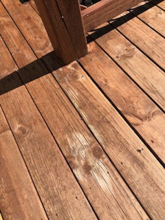

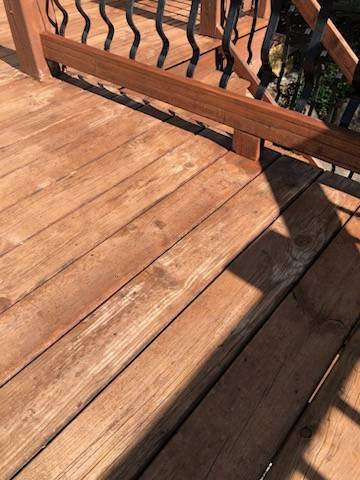

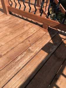

@administrator Hello, We stained last week after sanding and stripping, then brightening and the bleaching of the berry stains and 2 days of drying.  After using Armstrong Semi transparent Chestnut single coat, we are now seeing bare spots.  Should we just go over it again with stain?  Thanks.
FullSizeRender
IMG 8877
This post was modified 3 years ago by franz
Posts: 3381
Yes. Light coat.
