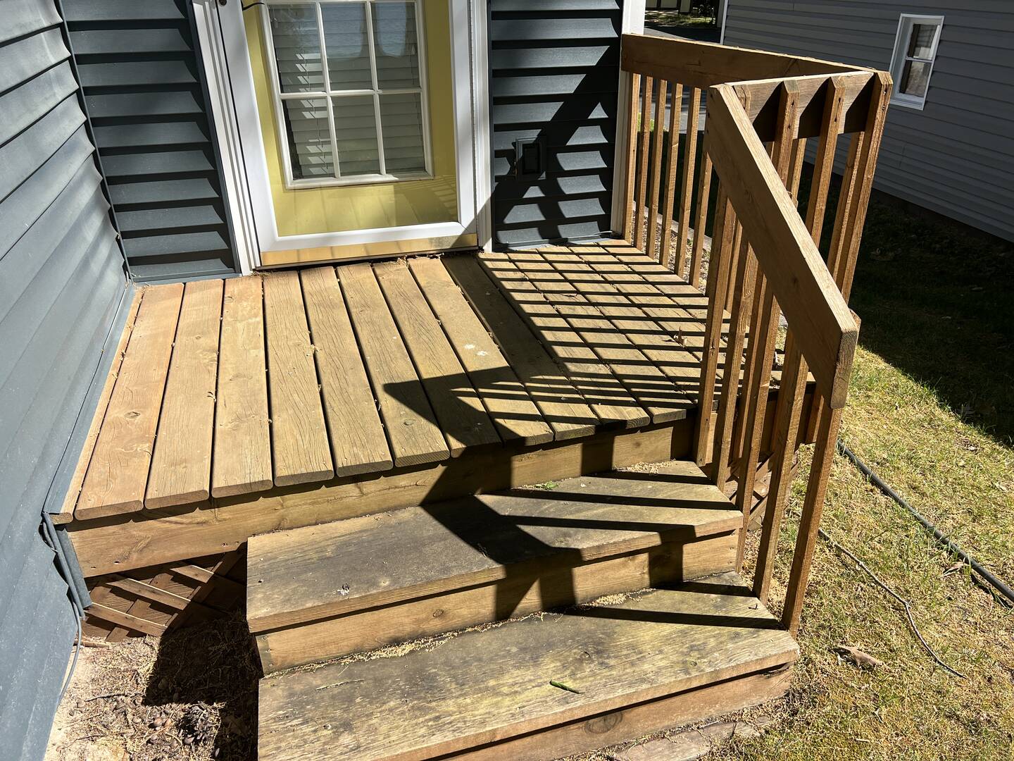

Can you give me some tips on how you would fix this side deck? Would you strip it or clean it?
IMG 3859
Are you using the same stain brand and color or switching?

We do not know what is on there now so switching. We want to try the Restore A Deck stain since it can be done on the same day as prep.
Posts: 3381
@sp-decks Strip and Brighten. This will ensure your new stain properly adheres and penetrates.
