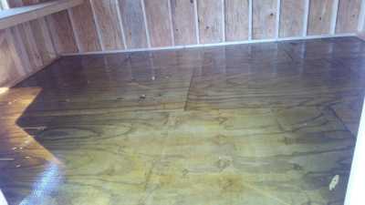

So. am a new first time user. I used the above BEHR product, given to me by a co-worker. I used it on my pressure treated floor in my brand new shed at his urging. Now it won't dry, been 4 days.
What should I do, how do I remove it so I can use my shed ? thanks...Dave

I am trying now...thks
(@wymerdad)
Joined: 4 years ago
Posts: 4
floor4
floor5

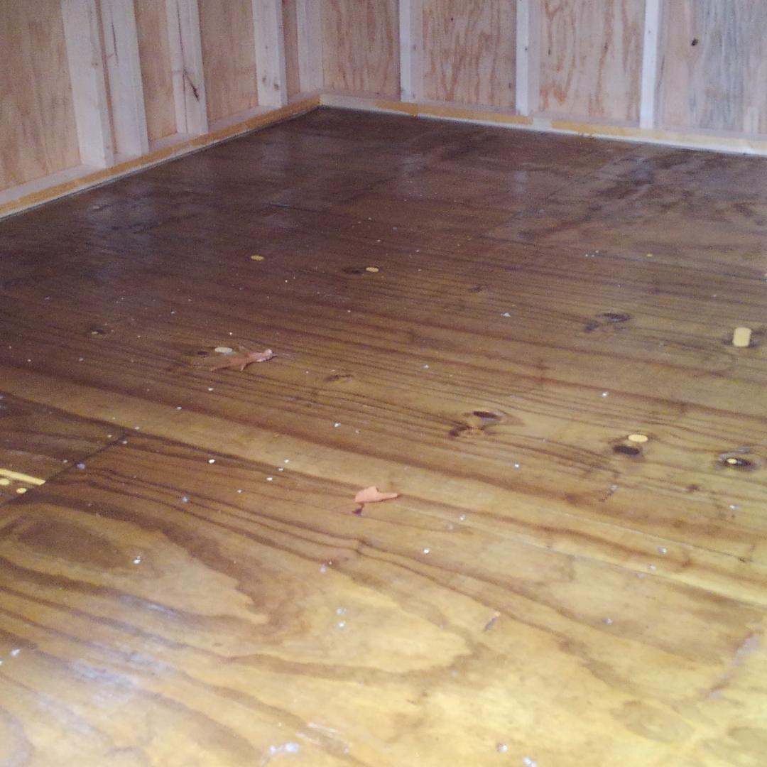

(@wymerdad)
Joined: 4 years ago
Posts: 4
floor2
thumbnail (1)
See if it does not fully cure after a week or so. If it does not, you will have to power sand this off and that will be messy. It will ruin a lot of paper as it will gum up.
There are no other options to remove it.

no mineral spirits?
Doubt that will do anything but you can try. Behr is a very poor stain and you severely over applied it.
