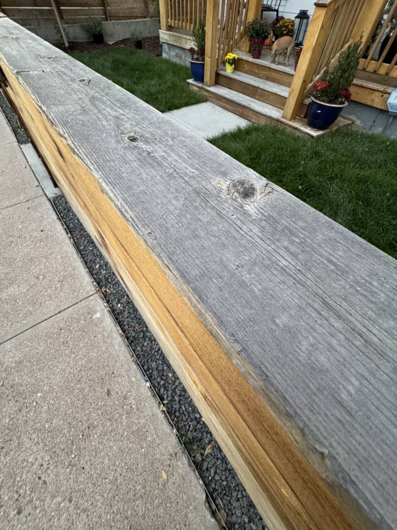

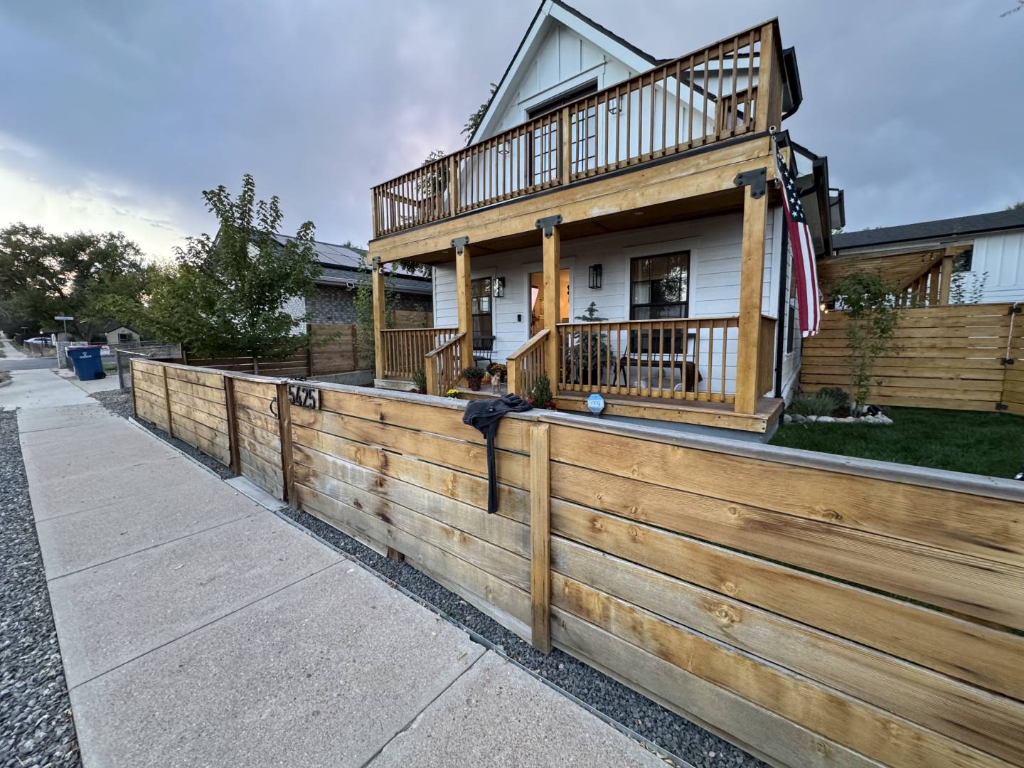

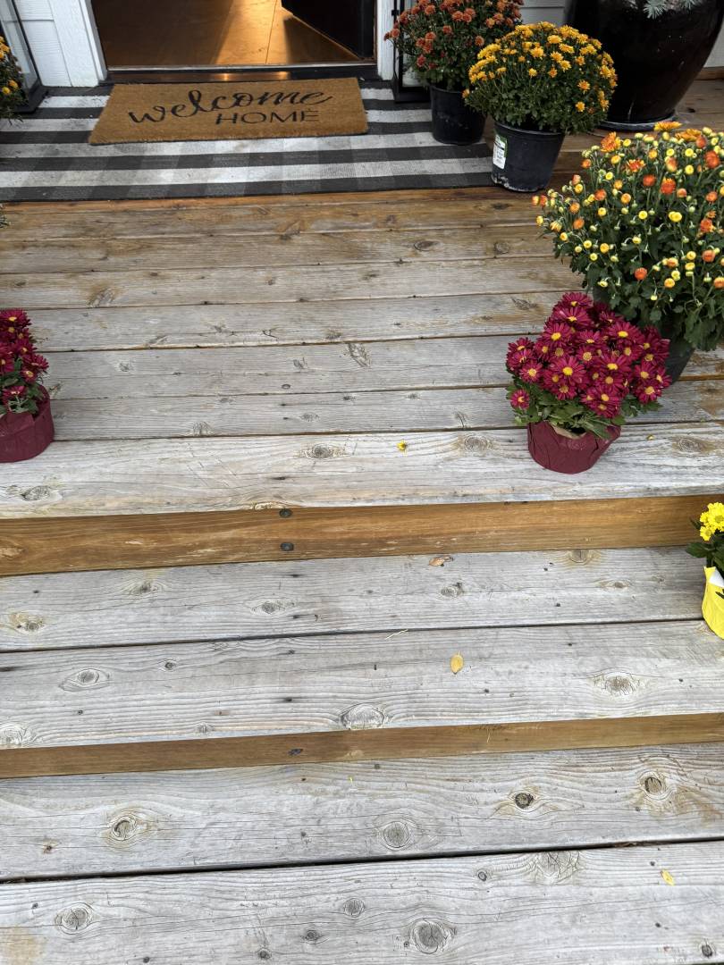

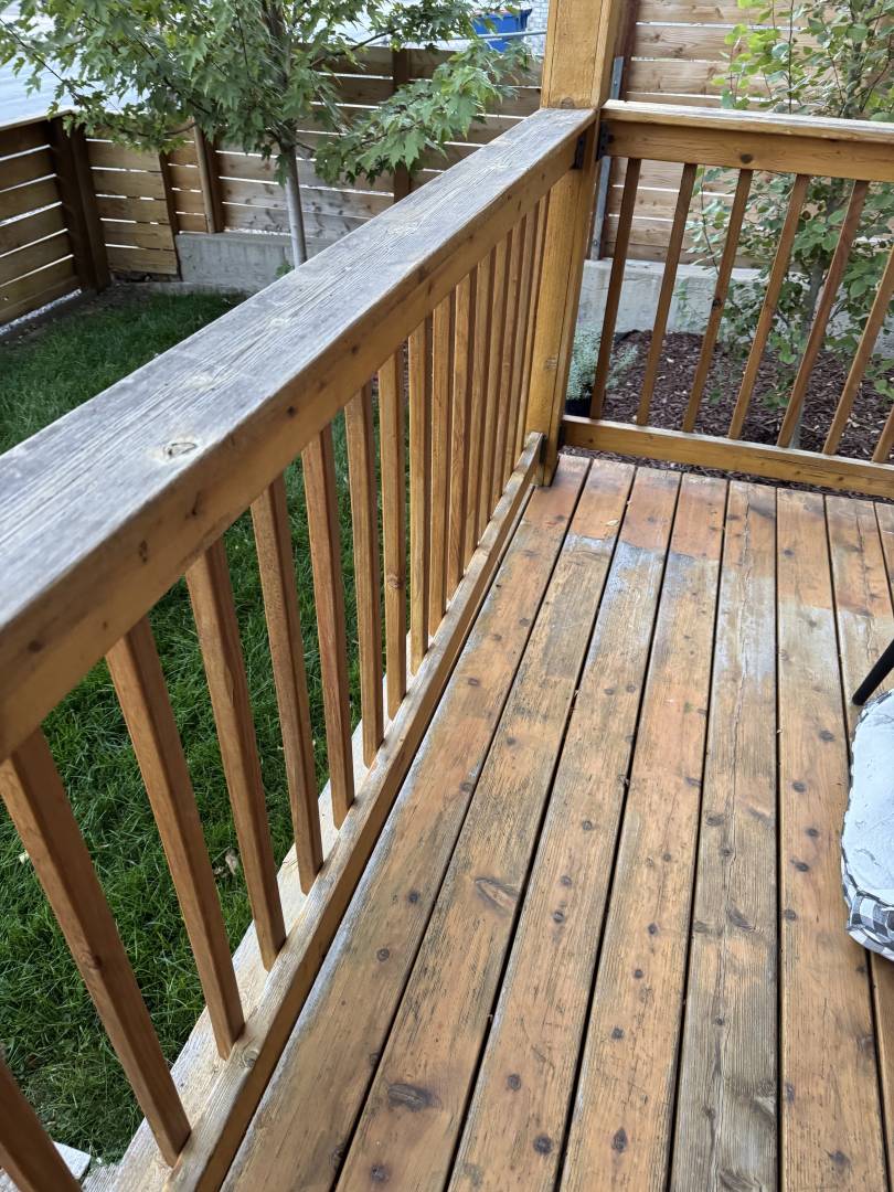

Hello everyone! I really need advice on my deck and fence. I live in denver and I built this deck and fence 5 yrs ago. The story goes... I initially applied behr clear stain on the 1st year. It flaked and Behr came clean and said there was an issue with their batch. A yr later, I washed, sanded and applied the same stain again ( behr sent me $1000 in credit and had the same problem. Fast forward to 2022, I went with Sherrwin Williams Super deck semi transparent sealer. I power washed, sanded some areas and the applied it. Now i'm left with this. The deck is peeling and I need to find a way to persevere this expensive deck and fence.
Can anyone please guide me through this? Do I get the Super deck sealer removal and apply and use a stiff brush to remove it? then sand? and apply a wood reviver product? Then seal it?
We want to keep the look of a semi transparent look.
In what order should I perform this project and what products do you recommend?  Power wash?
I can't thank you enough for everyones professional opinion!

Yes, strip and brighten all wood while using a pressure washer. See here for tips on stain strippers:
https://www.deckstainhelp.com/best-deck-stain-strippers/
Once fully removed, use a proper penetrating stain so it does not peel again:
