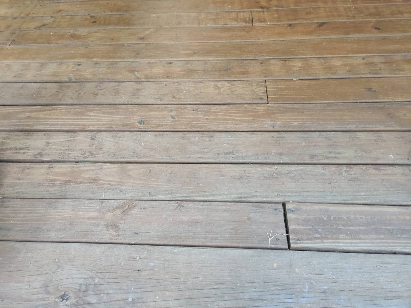

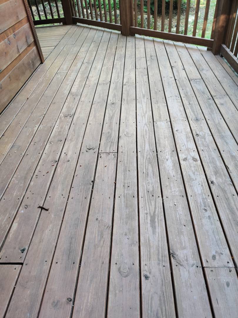

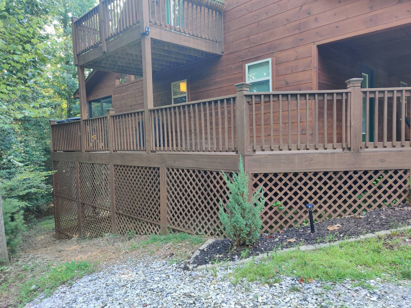

First time home owner, thank you for creating and maintaining this site. I live in the mountains of Georgia and recently purchased this home. I found these two products in the basement, but no idea if it was used for the siding, the deck, or something else:
  • Sikkens Ceto 1 077 cedar
  • Structure Wood care base coat
Based on the photos, what stain/color would you recommend? Should I apply a clear sealer on top once the stain has dried? I think the wood is pine. I've never stained a deck before, will be following the tips posted on this site.
IMG 20220728 082246
IMG 20220728 082307
IMG 20220728 082336
You will need to prep by removing the prior coating first. Use a stain stripper and then a wood brigtener while pressure washing. Stain after with TWP 1500 Series or Armstrong Clark Stains.
Do not add a sealer or coating over the top of a deck stain.
