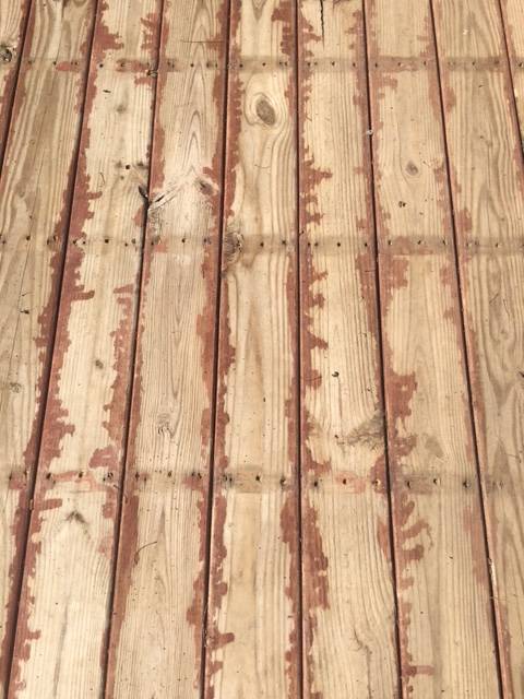

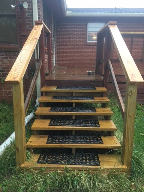

6 months ago, I had my old deck floor boards flipped and 3 of the boards were replaced with new treated boards. I also had new treated top railings and stairs installed at that time. In order to protect my deck from the direct sun this summer, I would rather not wait another 6 months to stain it with the semi-solid Armstrong Clark wood stain that I used previously.
I was wondering if I could use TWP semi-solid on the entire deck now? If that's not feasible, would it be okay to just stain the old boards with the semi-solid Armstrong Clark stain now and then only stain the new treated boards in 6 months?
IMG 1125
IMG 1126

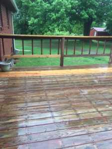

Also, I live in Tennessee. I believe the new wood is pine but not sure about the old wood. Full sun. There's some green on the railings so I'm assuming that's algae? No problems with prior stain (Armstrong Clark semi-solid).
Posts: 3381
After you strip and brighten the stained wood and then clean and brighten the newer wood, you can use the TWP Semi-solid colors. The algea will come off with the prep.

Since there isn't any stain on the flipped boards, do I still need to strip them? Also, do I have to strip the old stained railings before staining with TWP or can I just clean and brighten them?

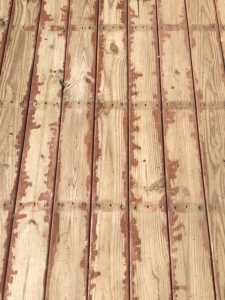

There is a little bit of stain on the old deck floor boards but not a lot. Here's a pic..
IMG 1131
Posts: 3381
Strip the turned boards and any wood that has a previous stain.
