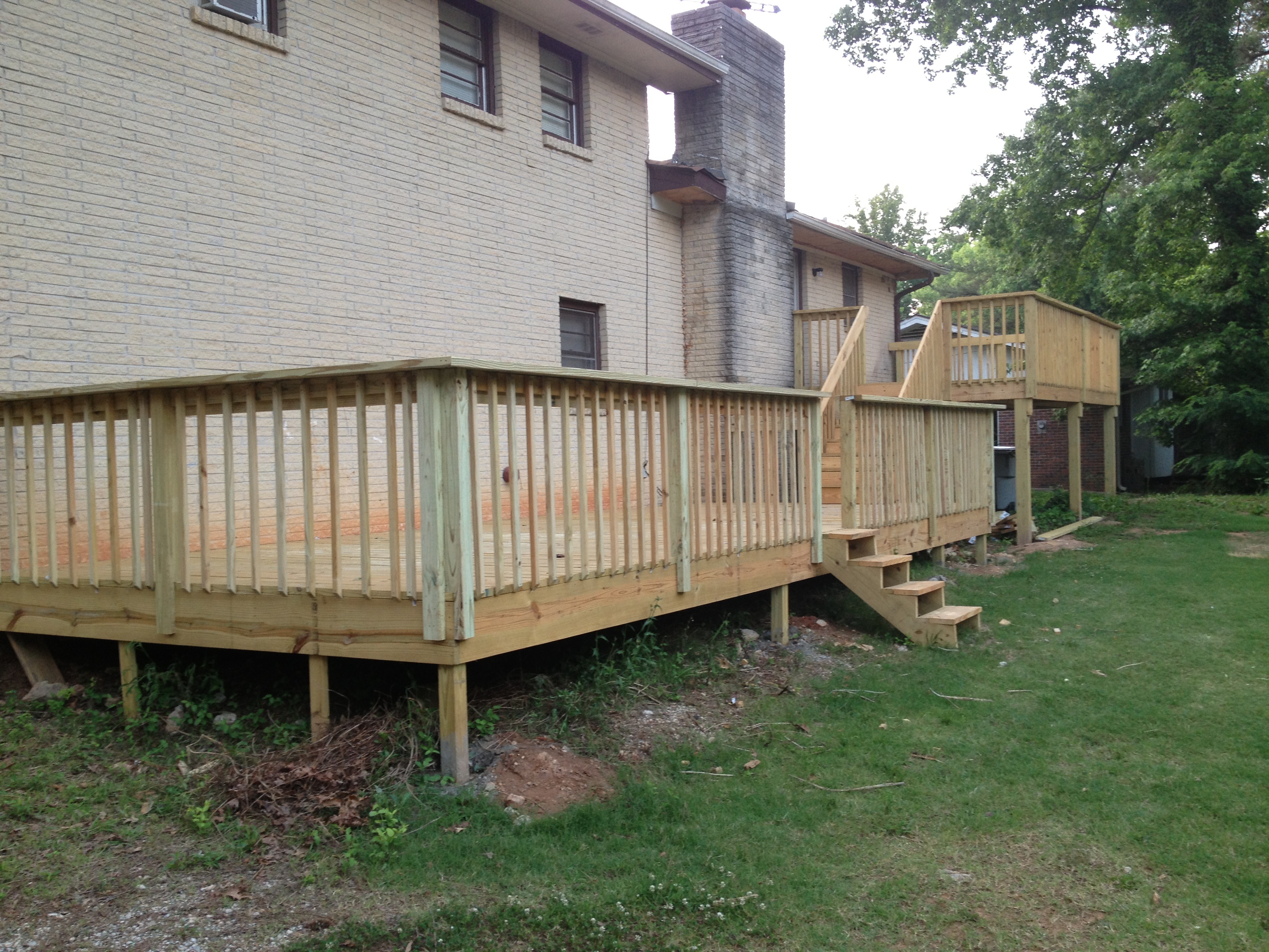

I live in Atlanta, ga. Just had a good sizable deck built about a month ago. Looking for a stain. Locally I have found Cabot, Flood and Behr. What do you suggest and should I still look local or order online?
I would not use any of those. Let the wood weather for a few months. Clean and brighten for the prep after the weathering. Look for TWP 100 Series.
