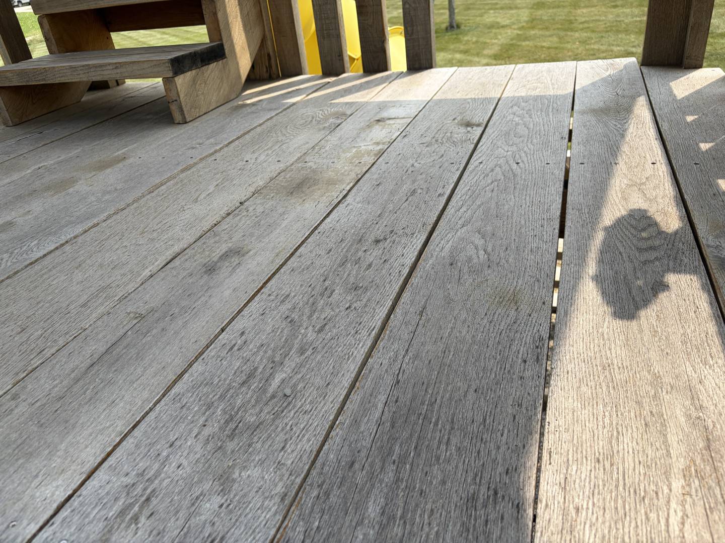

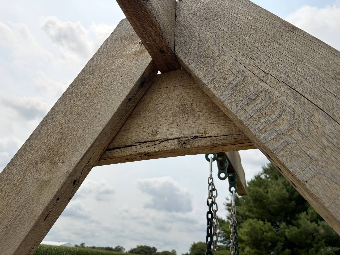

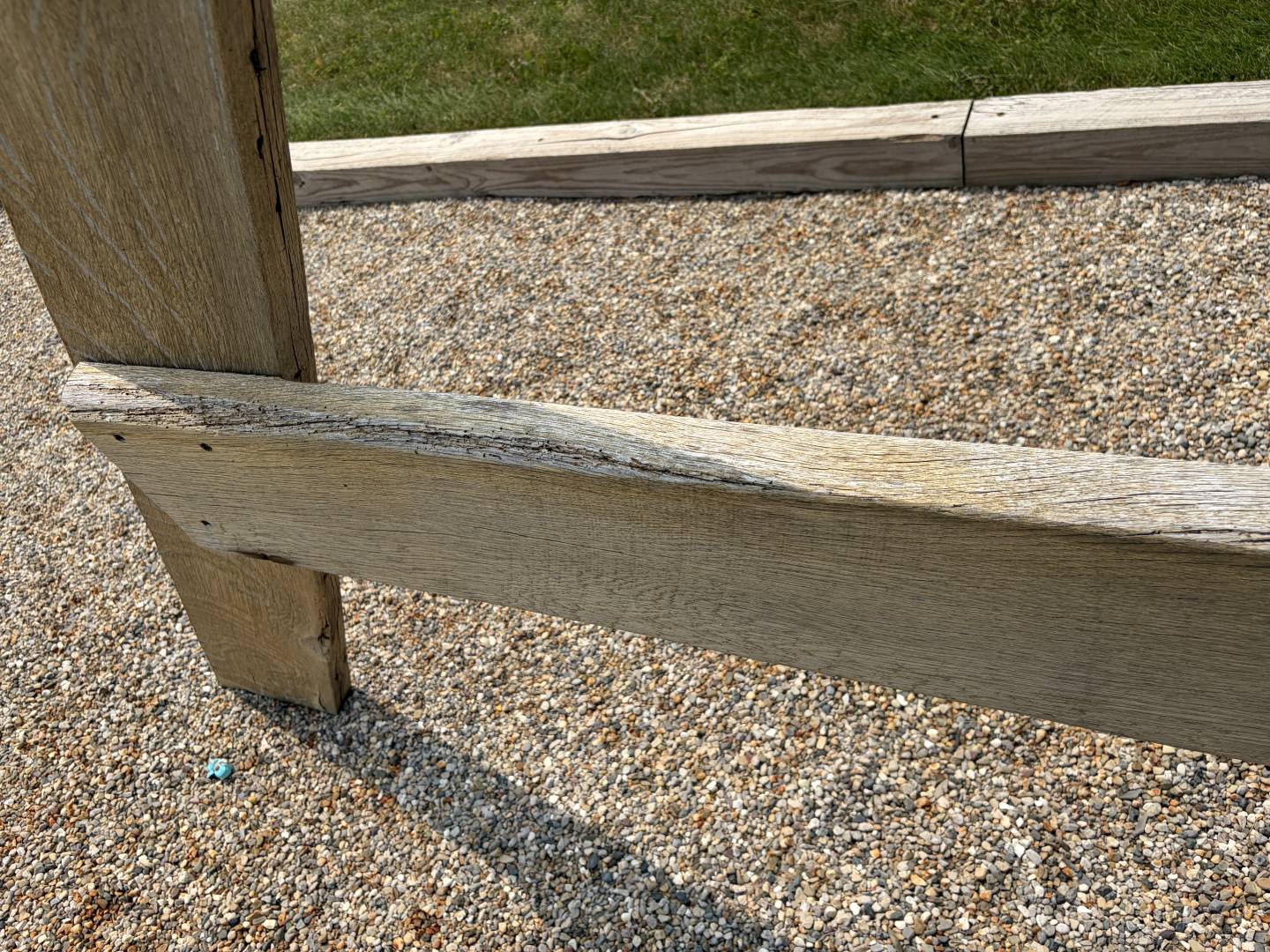

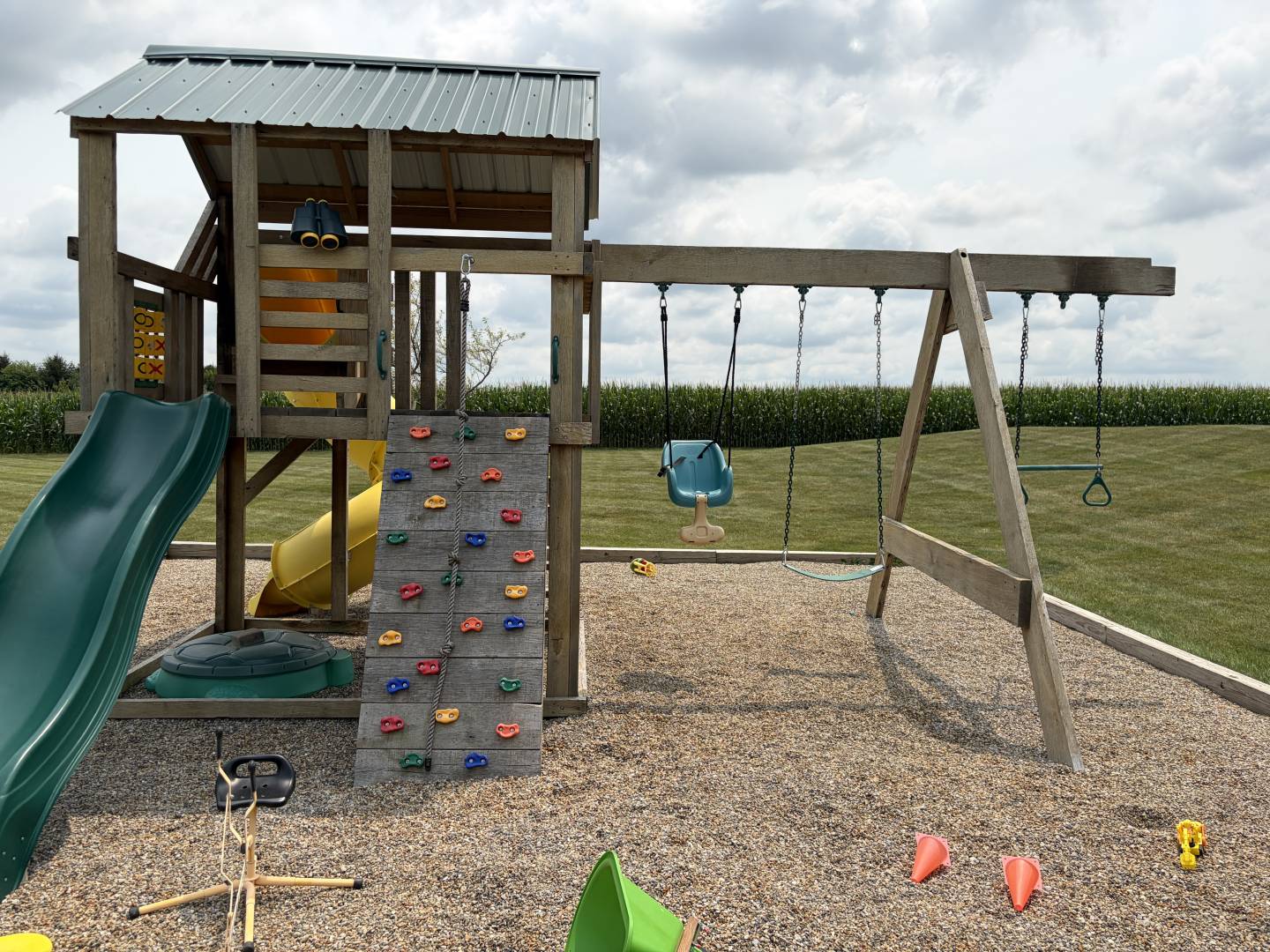

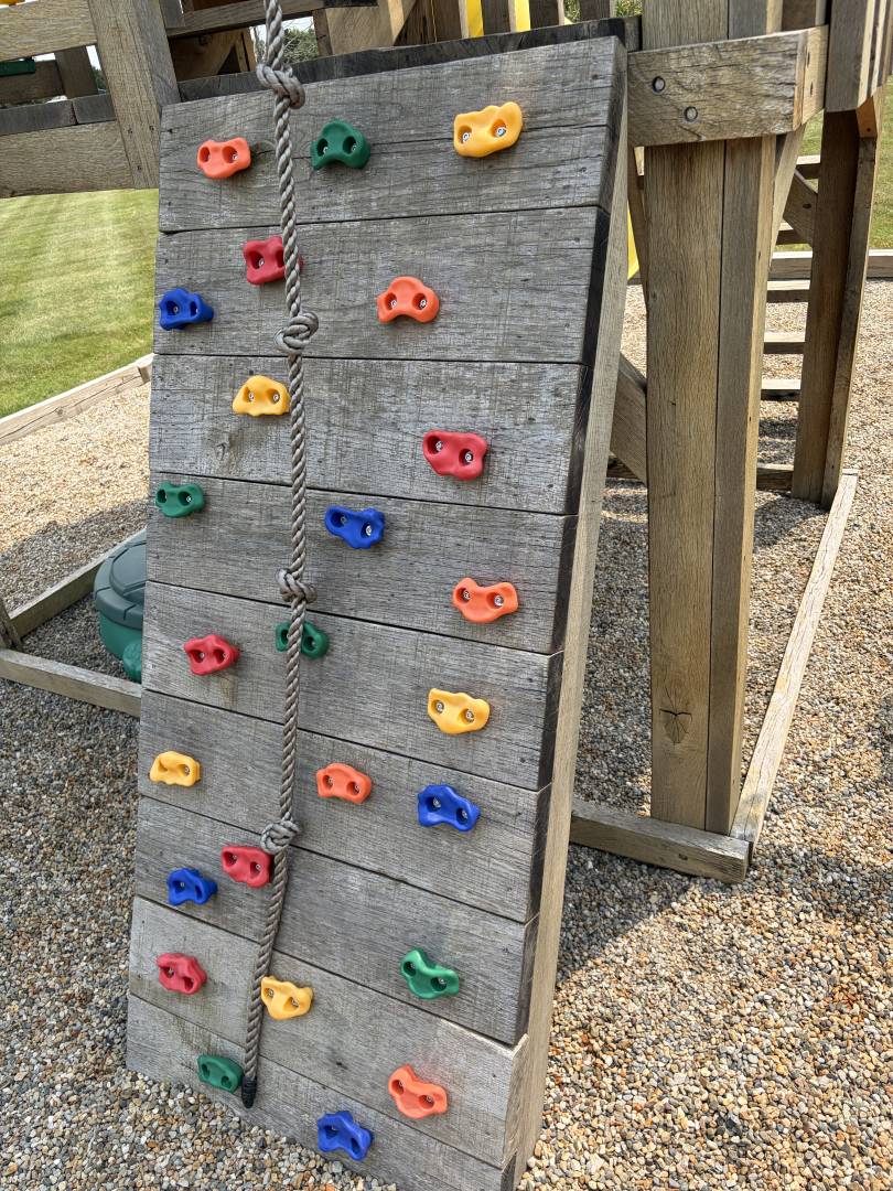

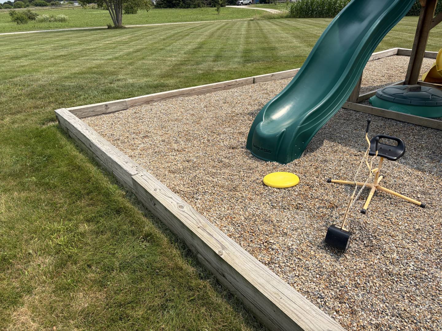

Hello, I have a play set that I built using reclaimed barn wood that needs a new coat of stain. Also, around the playset I have a border that I used treated rough sawn southern yellow pine 5x5's for, these should be plenty ready for a first coat of stain as well.
A. The previous stain was applied 2 years ago (barn wood only), about when the wood started seeing daylight.                  Before that the wood was inside a barn built in the 1890's.
B. Most of the wood is rough and not sanded, this includes some decay and bug damage.
C. I assume the old stain needs stripped and I should use a wood cleaner or brightener? I would like to remove the UV damage to bring back some color, such as using the Armstrong Clark.
D. Best application method? Brush, pump sprayer, airless sprayer?
IMG 4467
IMG 4470
IMG 4469
IMG 4471
IMG 4468
IMG 4472
  • 1. Indiana
  • 2. Full Sun
  • 3. Unsure, whichever hardwoods were cut down nearby to build the barn
  • 4. North side, which is the rock wall seems to be the only area with mold/mildew
  • 5. Previously used Sherwin Williams super deck oil based transparent stain (6511-52639). While it looked great at first it did not provide protection for much longer than 6-12 months and weathering/discoloring started to appear, so now a lot of the wood looks gray/white.
Posts: 3384
Most of the old stain is gone, so no need to strip. Clean and brighten for prep while pressure washing:
For the stain, look at the Armstrong Clark, TWP 1500 Series, or the Restore-A-Deck semi-transparent.
Use stain pads or brushes to apply.
