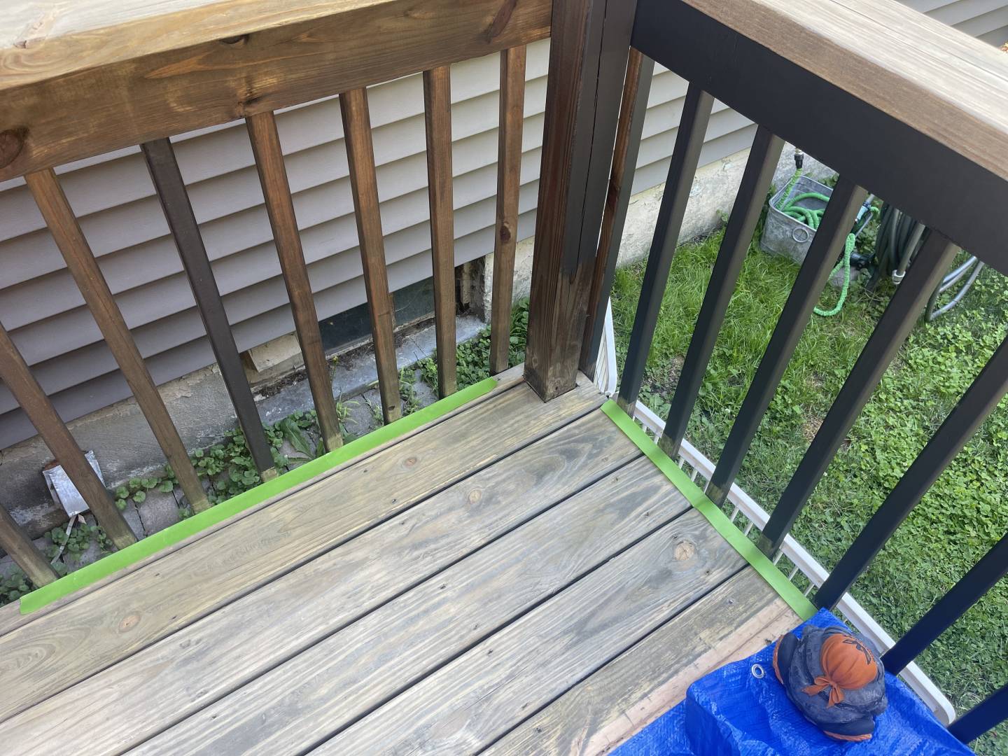

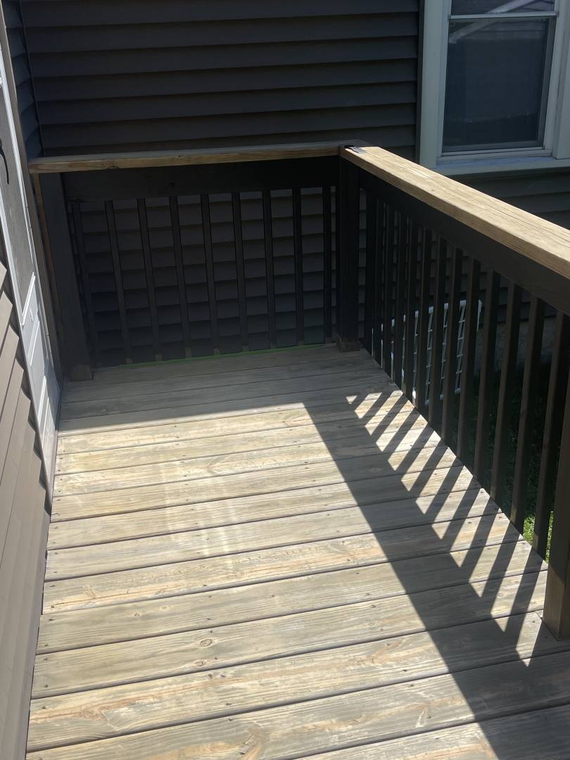

Previously had ready seal mission brown we have tried stripping the deck a few times and in spots it won’t lift at all what should we do I’m over this deck
IMG 4544
IMG 4542
 And ready to throw a solid stain on it! Any advice would be great! Was looking to do a semi transparent stain
Posts: 3381
Ready Seal is easy to strip. What stripper did you use? Did you brighten the deck after? The stripper will darken the wood internally, and the brightening restores the color.
FYI, some of your spindles look like a solid stain, not Ready Seal.

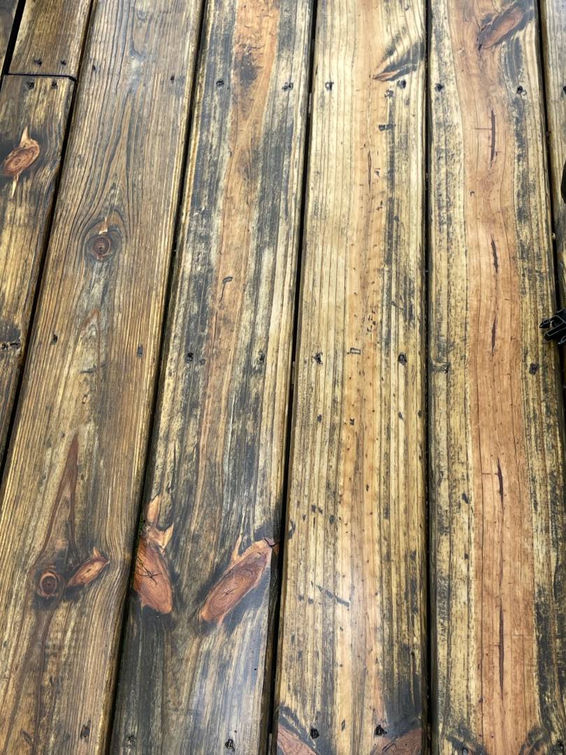

(@harleygirl72)
Joined: 2 years ago
Posts: 7
IMG 4564
This is wet 😔
Posts: 3381
That looks internal. It may not come out. You can use a dark brown or black color stain to blend.
