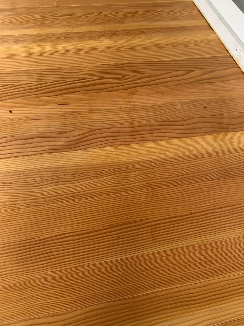

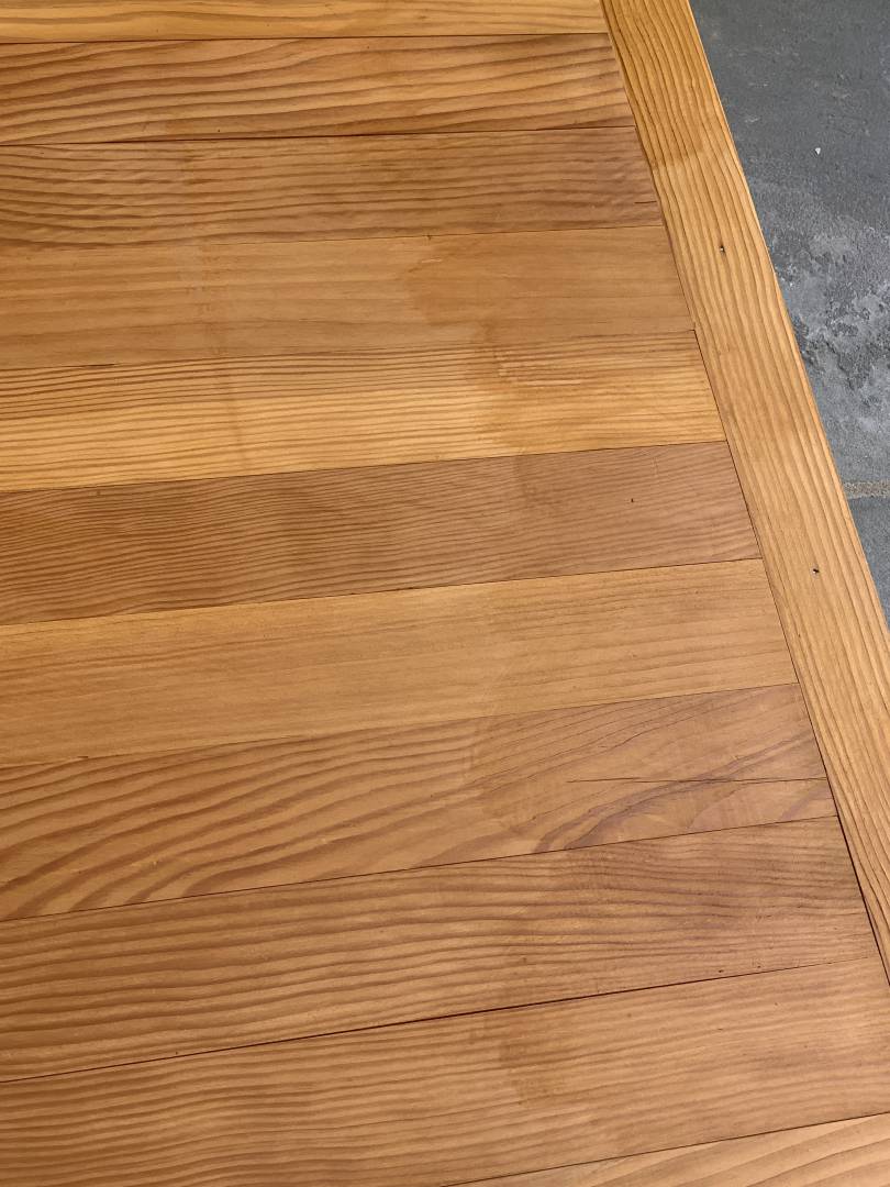

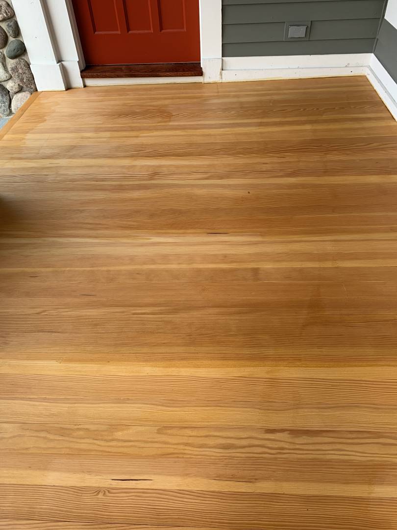

I stained a Douglas fir tongue and groove covered porch in SE Michigan two days ago. No direct sun, 80 degree day, 40 percent humidity. I had excellent results with the cleaner/brightener RAD combination. The boards were three months old. I stained three hours after brightening; the boards were dry to touch, but not hot or warm. Despite my best efforts, and staining along the length of the boards with a deck pad, I ended up with lap marks. The stain seem to soak in so quickly I couldn't complete a 10 foot length of board with a single load of stain on the pad. I used the RAD semi-transparent stain in Natural. The entire 180 square foot porch had dried to touch in 2 hours. I plan to stain again in 10 months or so. (next Spring). Will the second coat even out the look? Is my only recourse to strip and start again?
IMG 4075
IMG 4076
IMG 4077

Not sure if another coat will even it out but if you use the prep kit and pressure washing, it should.
