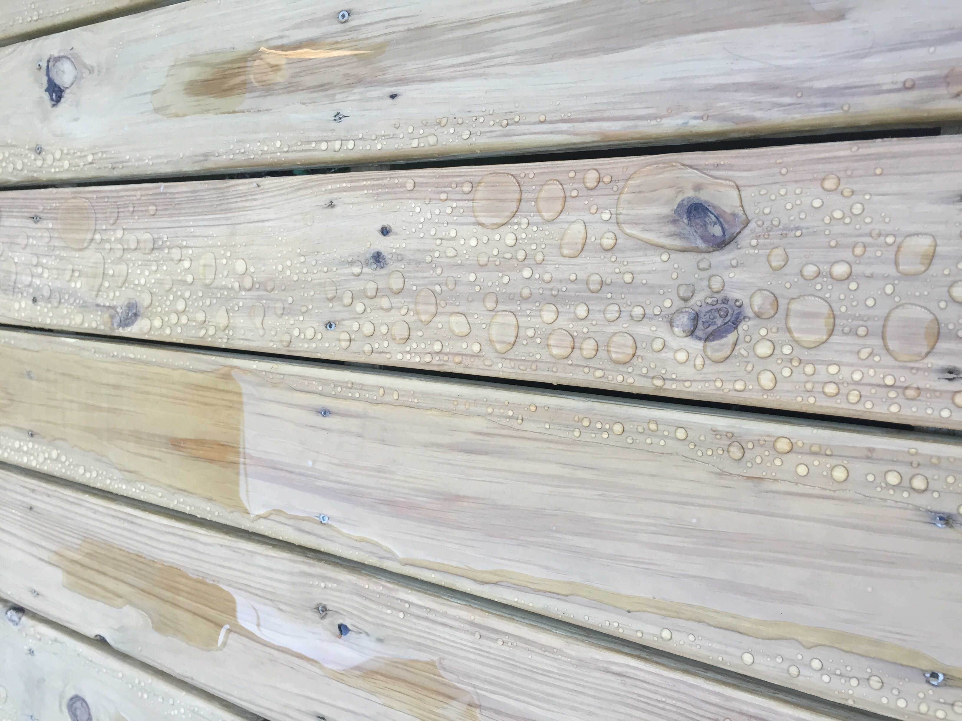

Wondering if I messed up too. I stained my new deck two days ago. It rained one night later and earlier today. The color to very nicely but I'm not sure what a "good job" should look like. I have some right beading and some longer pooling of water. Any advice?

Sorry did not see that. Leave it alone. I am concerned that your Thompsons is over applied. It looks like it dried on top of the surface which means it will most likely peel if you live in a cold weather state. You may have also stained too quickly and did not let the wood weather. More then likely you will need to redo this next year and adding more now will make that even more difficult.

Thanks. Live in Chicago so that may be an issue. If it peels over the winter and into Spring will I need to strip off everything and start over?

The absolute best way to insure that your deck will be properly cared for is to start from scratch. strip neutralize and restain you cant go wrong.

Yes you will. Also use a penetrating stain next Spring.
