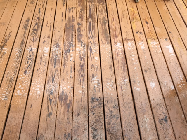

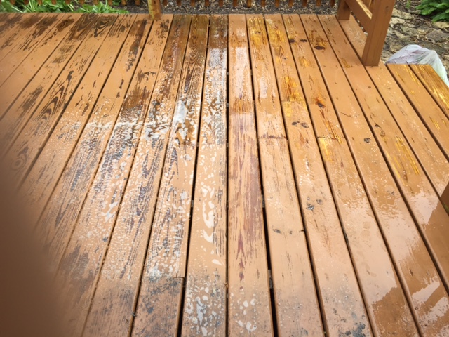

The problem is, the stain barely came off! I am removing Behr semi-transparent cedar natural tone stain - no idea when it was last applied and I'm sure it was simply re-coated several times.
I was expecting the stain to come right off the spindles and hand rails, but was thinking the flood boards would be much easier. These were just as stubborn and after a liberal application and letting it sit for 25 minutes, even using a stiff broom to work it in, nothing really came off!

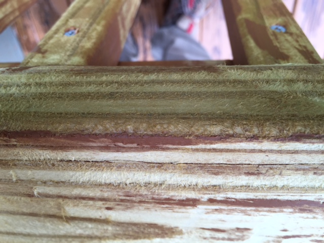

3. Did I ruin some of the wood with a power washer (see pics of close up with fibers coming off)?
4. Why is some of the wood yellow in color and some is very dark where the stain did come off a bit?

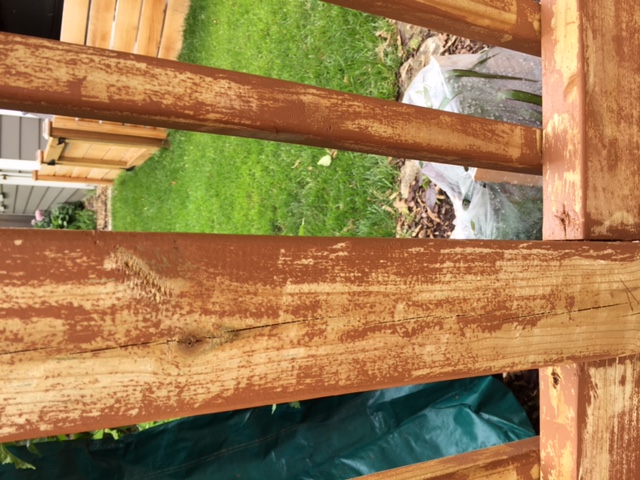

Pic of spindle showing not all stain would come off...

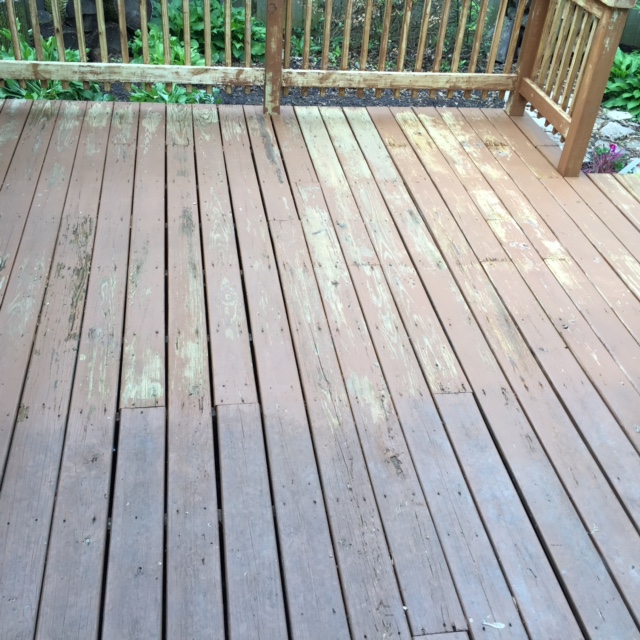

This morning you can see the difference where the stripper was applied to a quarter of the deck versus the rest of the deck - the rest of the deck is def dirty as hell, so is it possible that the stripper just needs multiple applications as it burns through layers of dirt and stain?
Also, I used a garden sprayer, so I am going to test out a small section using a roller to maybe see if that application is better.
Lastly, I am also going to try the roller when the deck is dry, it was wet after rain and an initial soaking by me, so I wonder if that stripper didn't work as well because it was wet (too wet?)
Posts: 3343
The issue is the Behr and the multiple layers of stain adding up to the point that is is basically a solid color stain now. No stripper will get that off effectively. You are going to have to sand this off.
