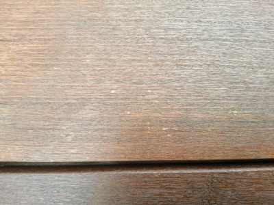

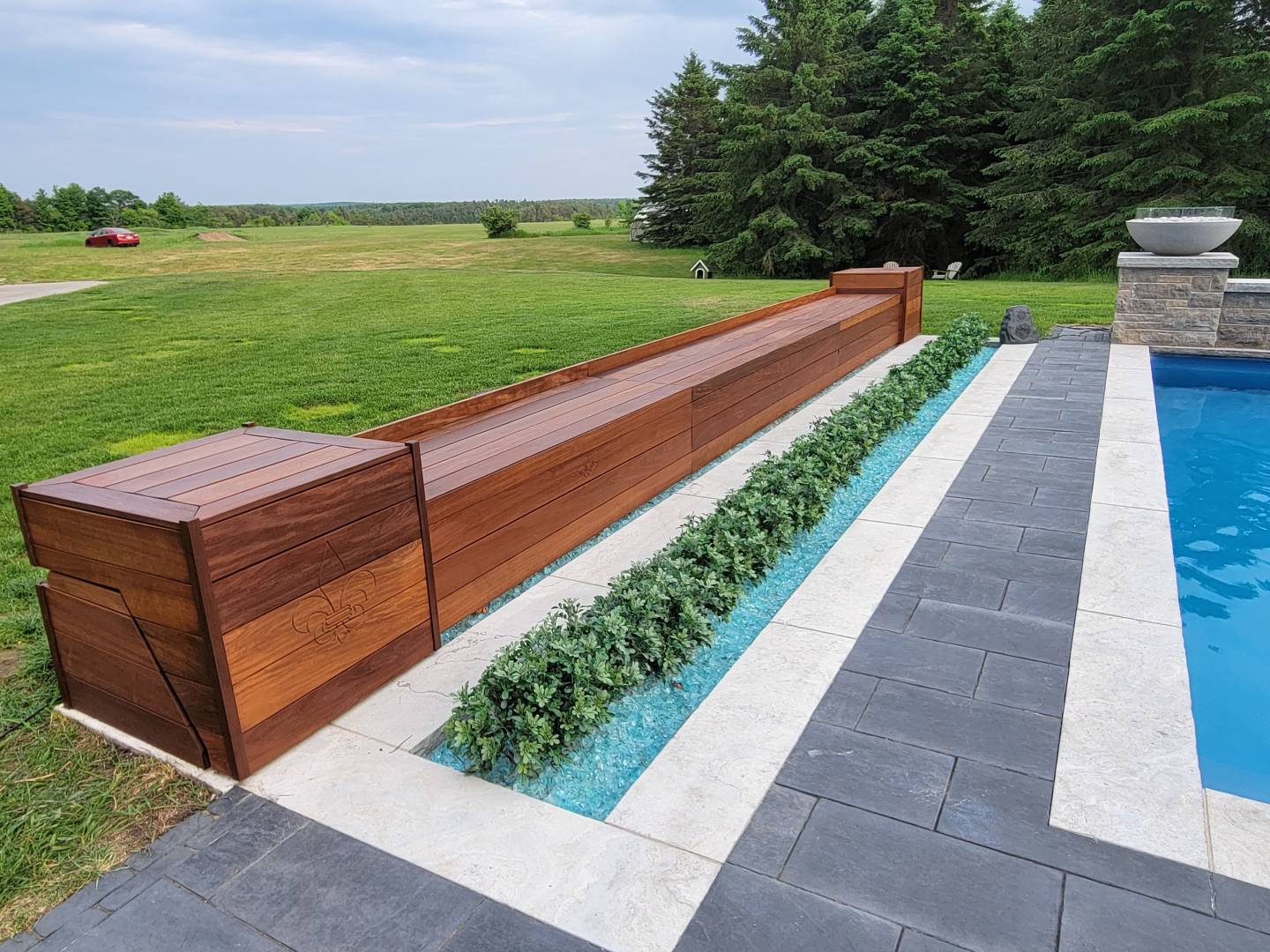

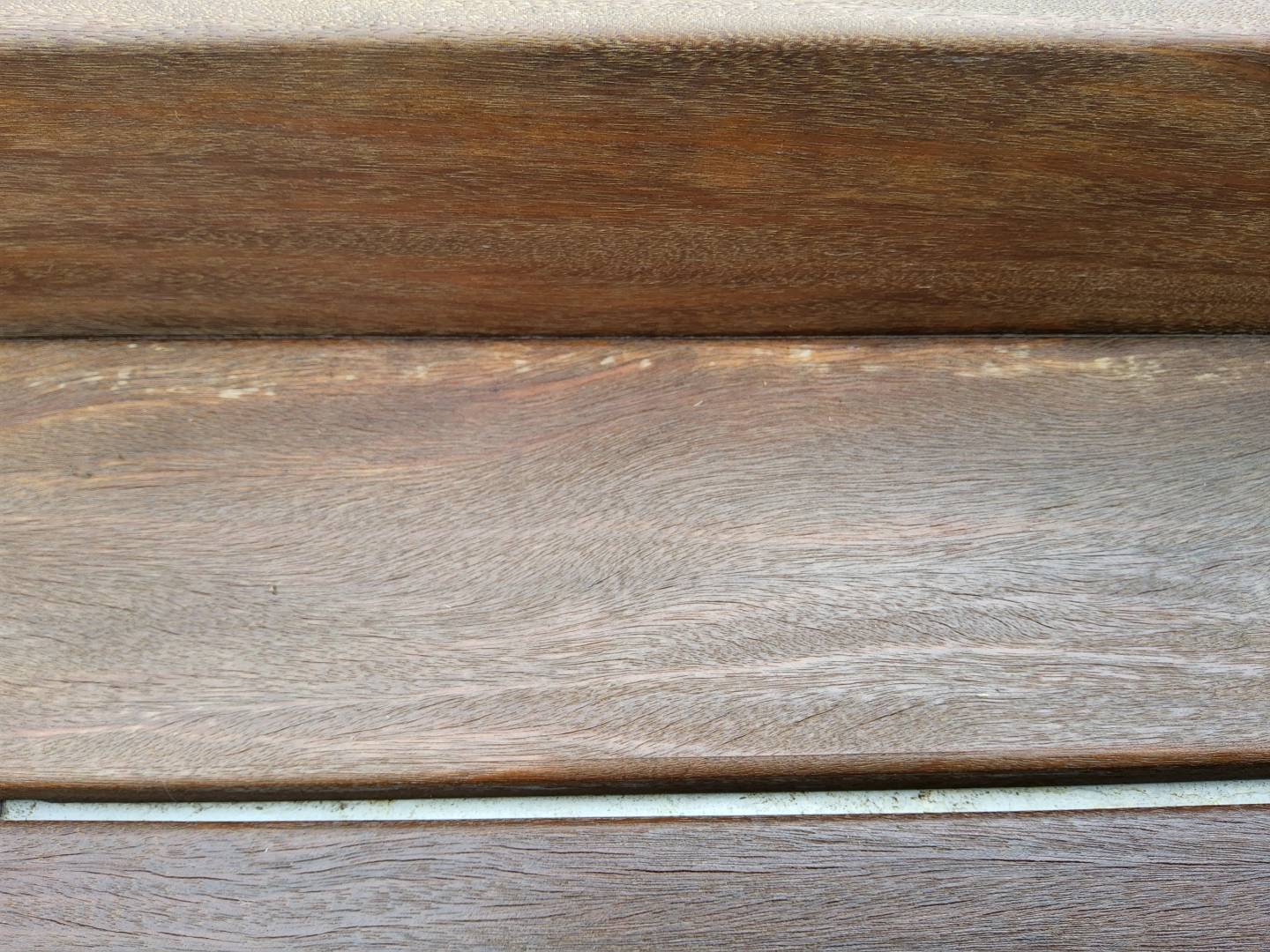

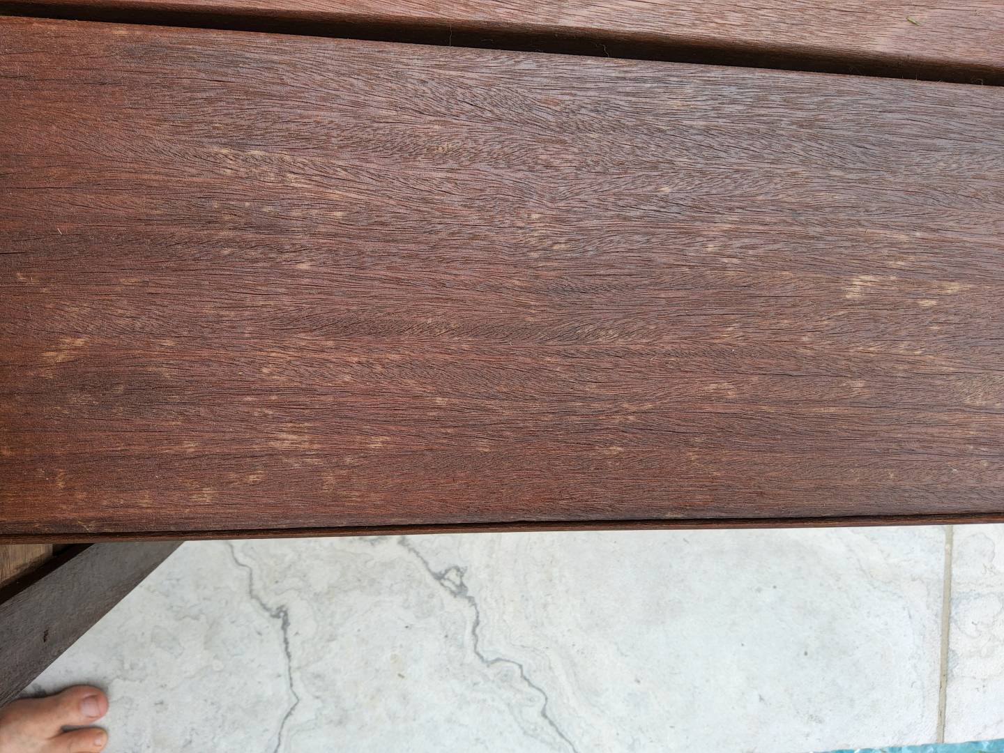

I finished our IPE pool bench with Deckwise IPE Oil and it lightly rained about 4 hours afterwards.  It was only supposed to rain the next day so we had planned on tarping it.  We tarped it in the rain and this morning everything looks great wit the exception of 3 small areas that I tried to rub dry while deciding what to do.  Do you have any suggestions to fix the three areas so that they blend with the rest and look beautiful again without too much fuss?  It bothers me that I caused it and had I just tarped it we would have been fine!

 Thanks kindly for any suggestiones that will make it right!
Posts: 3385
It is not possible to spot-fix and have it blend. The only real way to fix would be to strip it down and start over.
