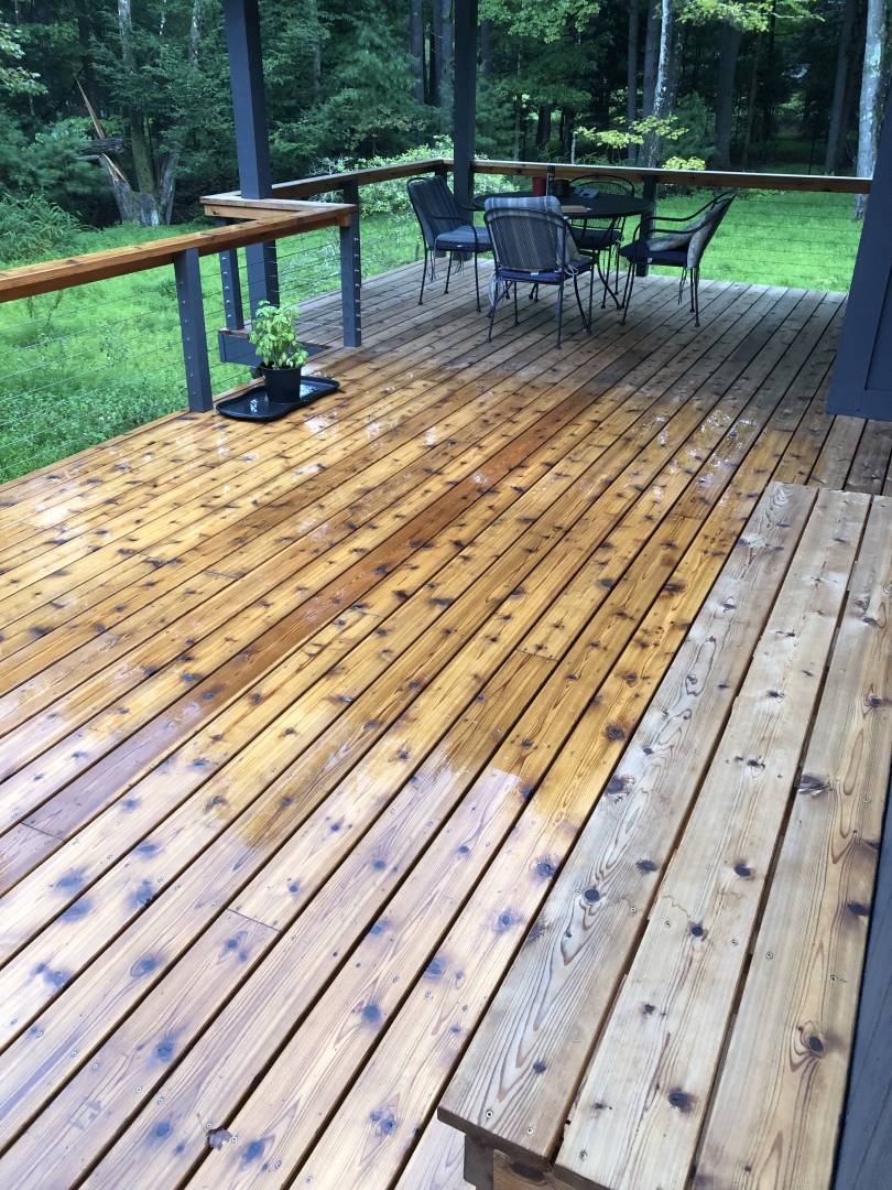

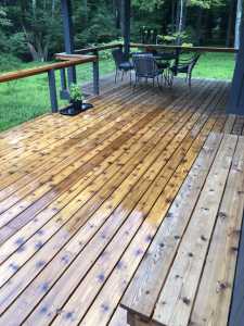

@administrator
 And...is my plan moving forward correct? (see above) Thanks.

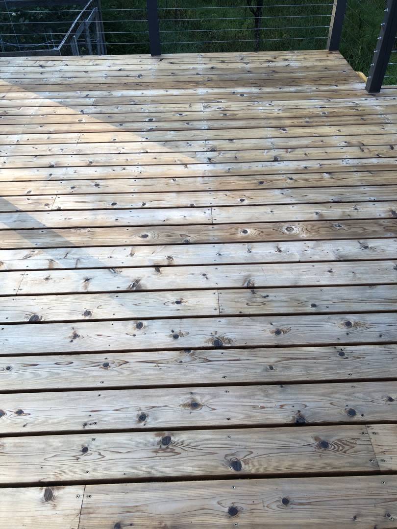

Of course, while waiting for a reply (and catching my breath, I've been cleaning for several hours), I'm researching and learning.
Do I need to wait before applying TWP as the cedar was only installed in June (although I've already stripped the Ready Seal)?
If so, what do you think of waiting and leaving it until spring when I'll have to reclean/brighten?
One coat or two? As it's new wood, I'm thinking one.
Do you recommend an alternative product over the TWP which I see has issues being absorbed into new wood?
Thanks....I'm sorry for multiple posts but the more I learn the more questions I have. (I'm now more informed than my "doing-it-all-my-life" contractor, who botched it in the first place.)

3-4 months for new wood and TWP. Wait until then or Spring. Redo the prep when time to stain. TWP has no problems absorbing when done correctly. One coat if less than 12 months.

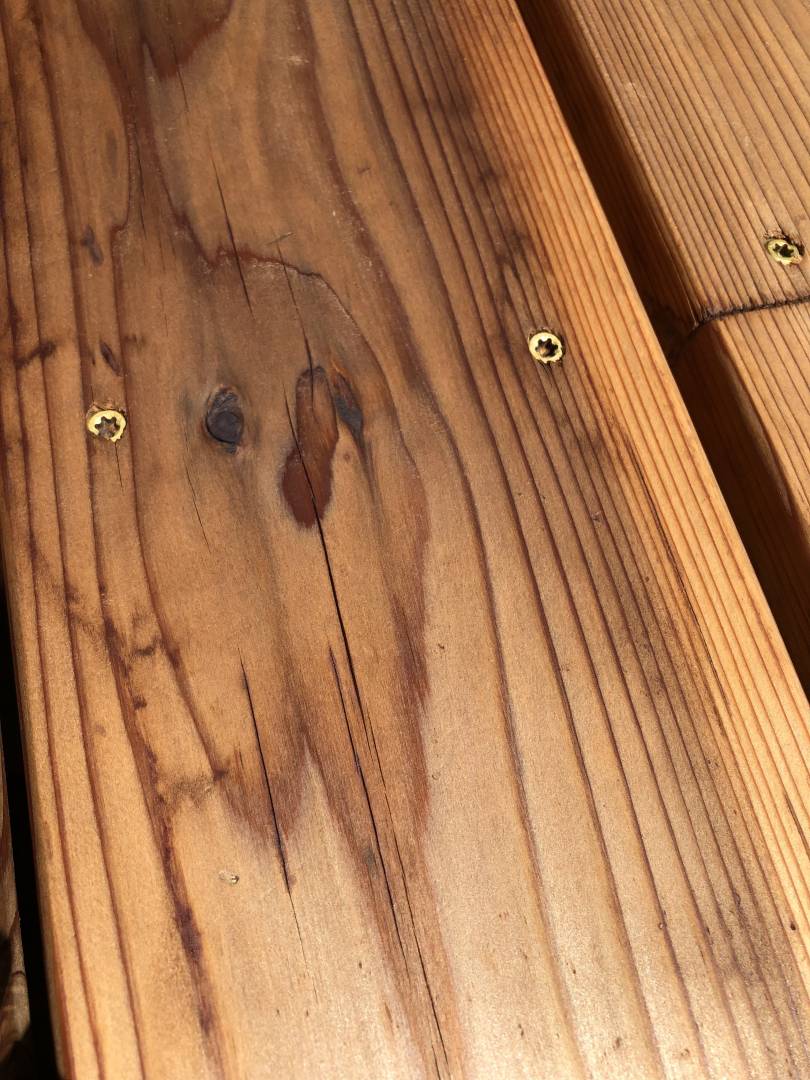

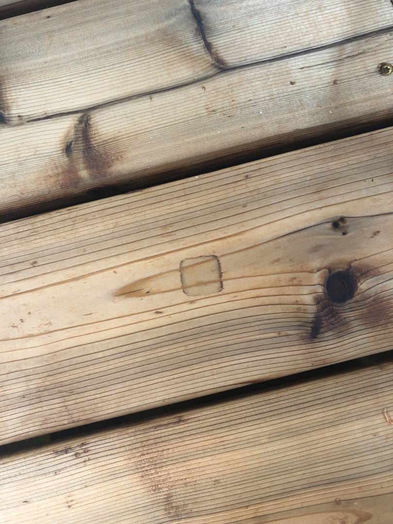

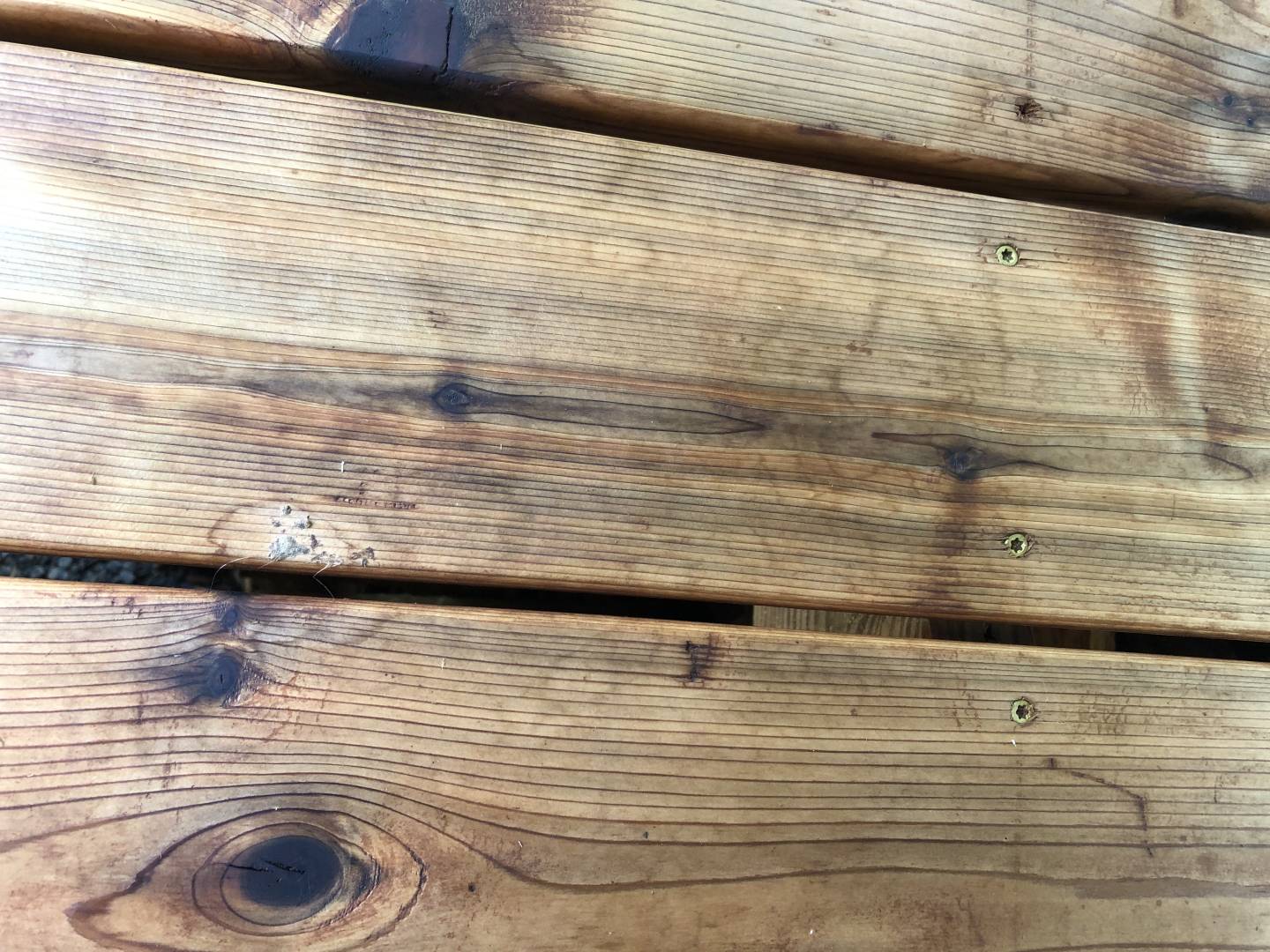

I've done nothing beyond use Oxiclean to remove the overapplied READY SEAL from the deck. When I showed you the first set of pics 2 weeks ago you said it was ready for staining. While doing nothing during those 2 weeks, I've noticed the following:
1. Halos of white around the deck screws the morning after it rains. (see pic)
2. Stains from deck furniture after it rains. (see pic)
3. The wet deck looks better than the dry deck, which is probably common.
QUESTIONS:
1. What do the Halos indicate?
2. Why does the furniture leave stains?
3. What can i do to achieve a wet-look all the time?
Ed

1. Sorry but not sure on this.
2. It is either a water stain or a rust stain. Using a wood brighener may help to remove.
3. Use a Honey colored stain like TWP 1500 Series in 1515 Honeytone:
https://www.twpstain.com/twp-1515-honeytone

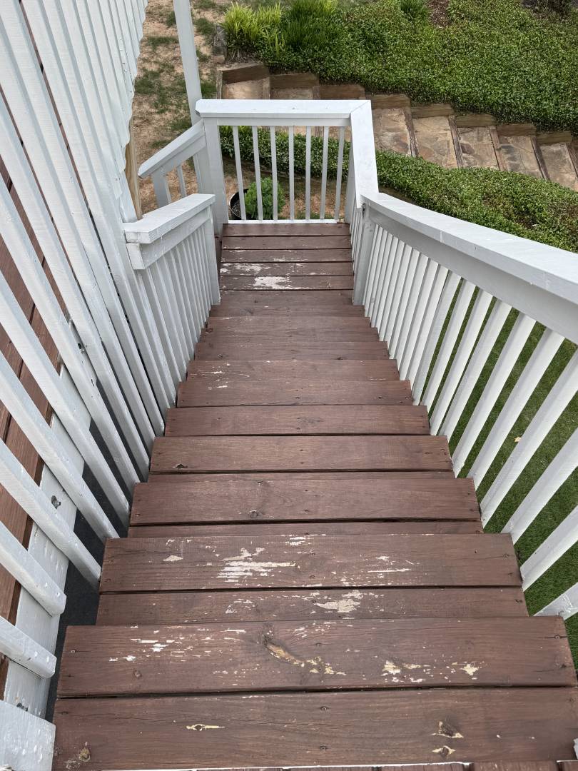

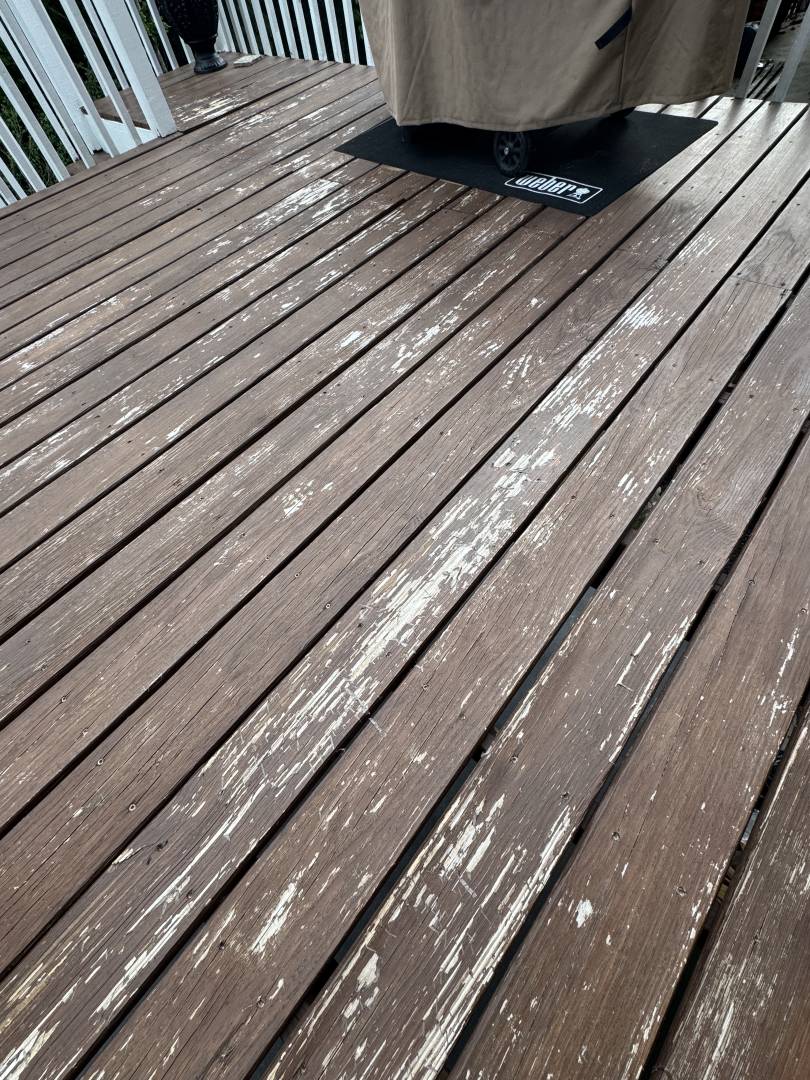

I live in GA and my deck (Pine) gets partial shade but mostly hot sun.  I put down new decking about 3 years ago and used a Behr semitransparent stain (big mistake).  Starting last summer, the stain began to peel and now I need to fix it.  Should I sand or use a deck stain stripper?  Only issue I might have with the stain stripper is that my railings are painted and I am afraid the stain stripper may accidently get on the railings.  Would I be safer to just sand? I have stained several decks and fences over the years and never had any issues.  The first time I use a Behr product, and it turns into a disaster.

@ouduckpond77 Behr is a filming stain that applies more like a solid stain than a semi-transparent one. It will need to come off and that will require stripping and power sanding.

Would the stain stripper also take exterior paint off as well? Do you think I need to do both stripping and sanding? Can I just do one or the other? Recommendations on a semitransparent stain?
