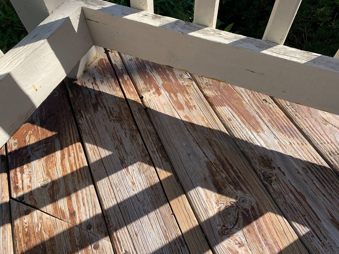

  • 1. Indiana
  • 2. Large (500 sf+) 2 level deck, one level in full sun, one level in predominantly shade - almost 30 years old, sun deck obviously in worse shape
  • 3. Pressure Treated Wood
  • 4. Minimal Mold or Mildew Issues, does come off with power washing
  • 5. Peeling, cracking
  • Have used oil or acrylic products in the past.
IMG 9477
IMG 9534
IMG 9471

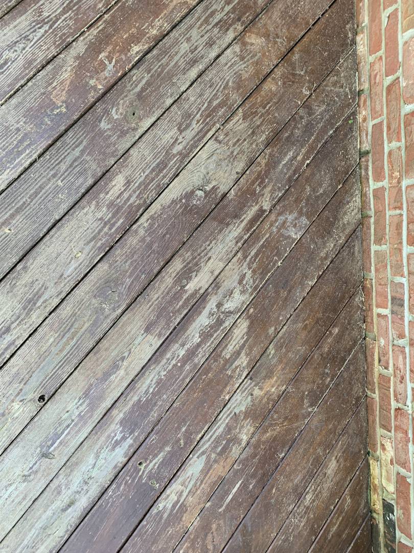

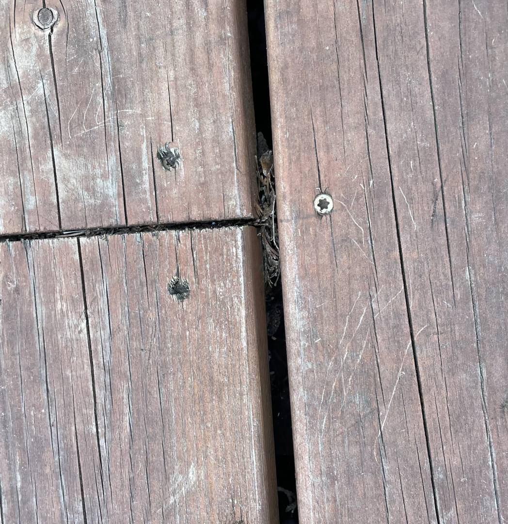

Have been working on this deck since last summer.  Am only able to remove "most" of previous finish, after renting commercial sander (areas under railing cannot be reached) , multiple heavy duty power washings, stripper, etc.  Did a test set of stairs last fall, used 2 coats Pittsburgh Paramount, already beginning to fail (small areas of bare wood showing)
Although extremely helpful, I am overwhelmed by the amount of information on this website!  I am assuming that I cannot use oil based product due to previous mixed media.  What is my best bet going forward ... is anything going to work if I cannot get all the old finish off?
Stripper?
Brightener?
Finish - Solid?  Water Base?
Product Recommendations?

We would suggest getting it all off. For most of the stain left, we suggest the RAD stripper with both additives. Apply, let dwell for 45 minutes, and then pressure wash off.
Once done, spot strip the stain that did not come off with the RAD Paint Strip. These will be the "thicker areas":
Once the stain is 95-100% removed, brighten all the wood and then use a penetrating semi-transparent stain:
(@galadhremmin)

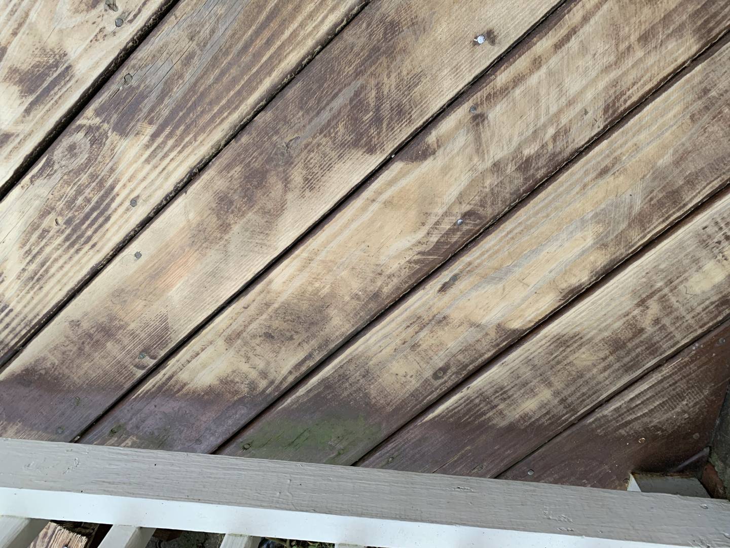

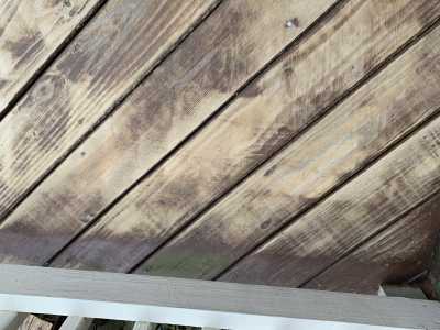

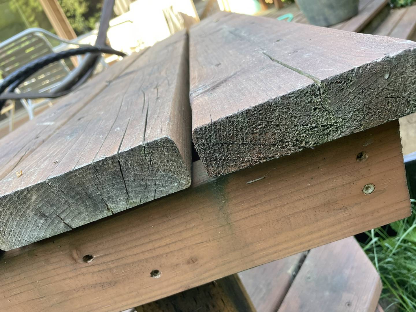

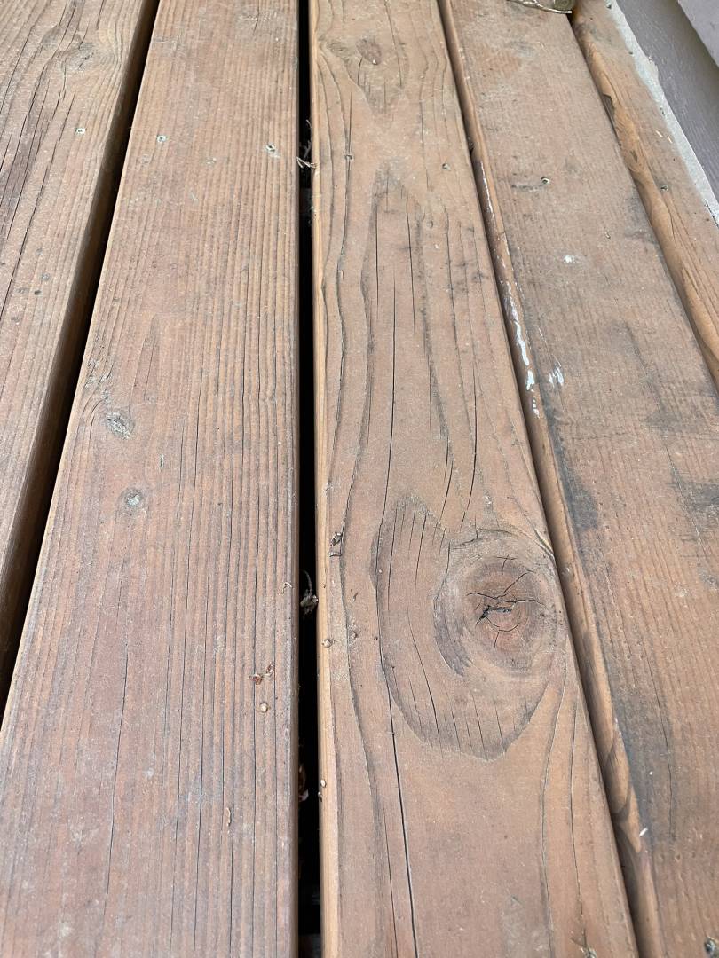

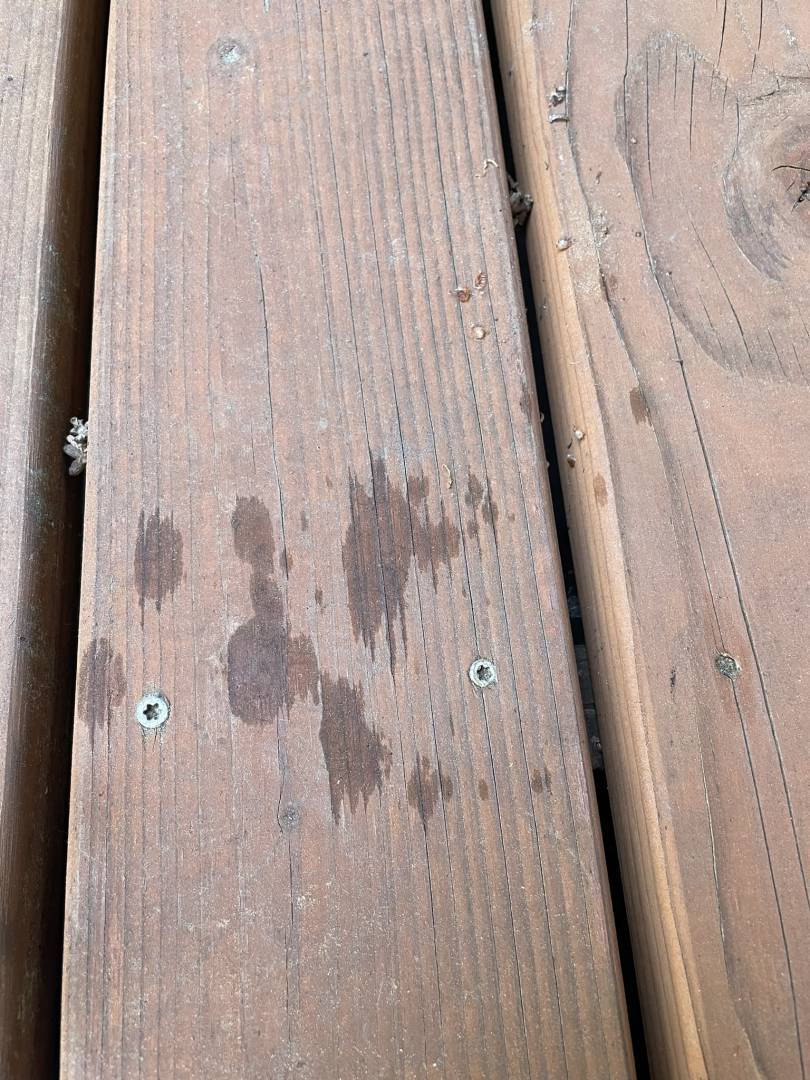

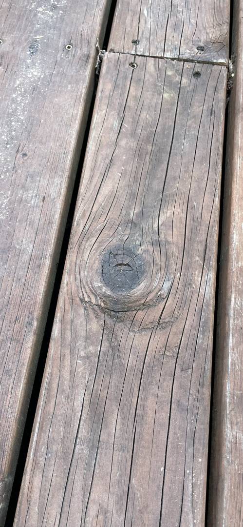

Here are some views!  I've included a water splash (drops stay partly on the surface for a few moments, are fully absorbed within 20 seconds); the worst board; some exposed and more-protected areas; some ends. Please let me know if you need to see something different.  Thanks!

Clean and brighten all wood for prep and then use a penetrating semi-transparent stain that is similar in color. Only 1 coat.

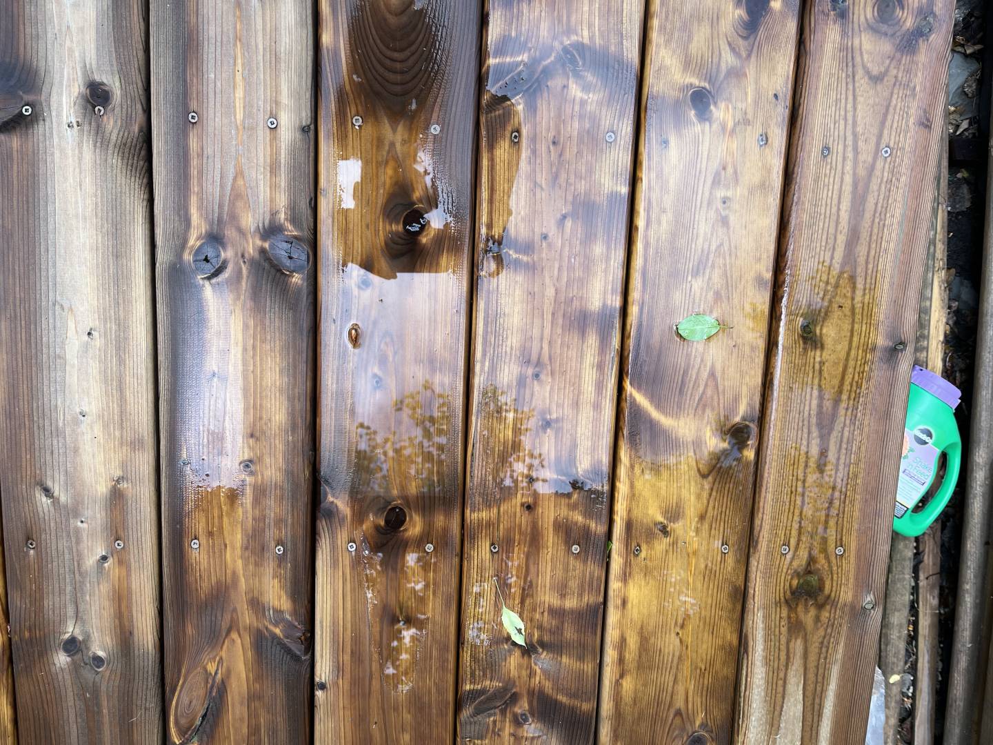

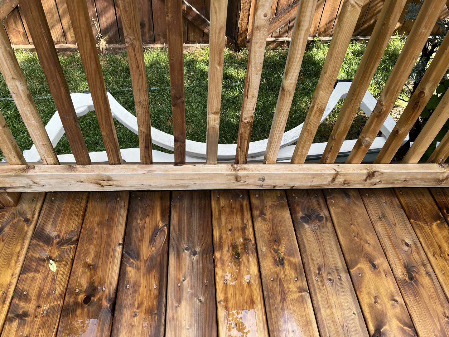

Canada, smaller deck
pressure treated pine
we like the look of the wood when it rains, mostly the deep color in grains over shine

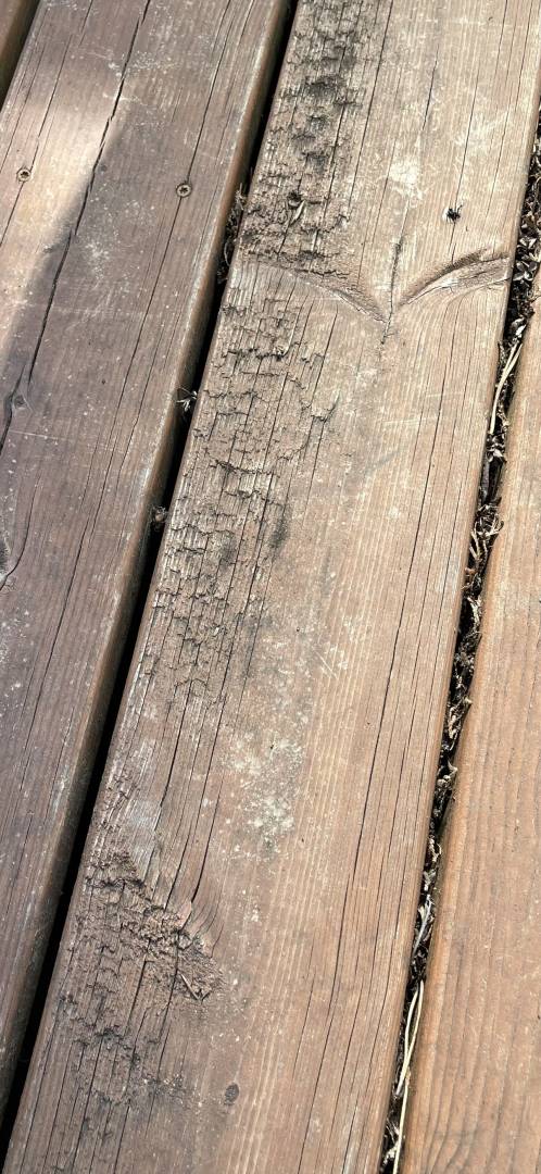

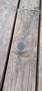

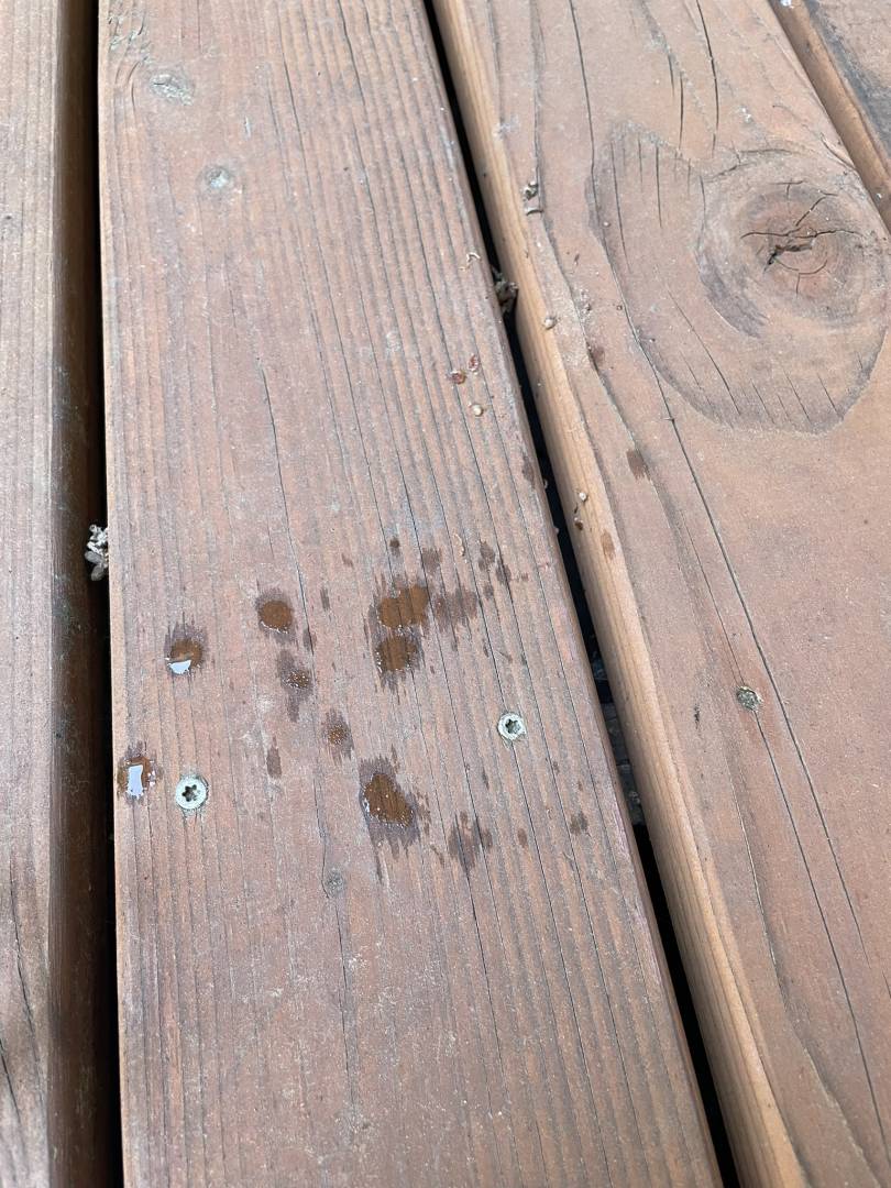

trying to find a product that won’t peel or  chip that will create this look, and I do not want to have to strip or sand in the future. I don’t mind reapplying oils frequently if I can get the look I want. When dry it looks like the horizontal board in 2nd picture. Please help I haven’t been able to find a Paint person that can help solve this. I’ve tried nine samples of various water-based and oil products, including Olympic and behr. Cannot get some of the most recommended products in Canada due to VO2 restrictions
IMG 2700
IMG 2702
Posts: 3342
Armstrong Clark stain in Natural color is what you would want here:
https://www.armstrongclarkstain.com/armstrong-clark-stain-5-gallon
You can have it shipped to you.
