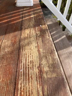

You have a varnish on there and it has to come off fully first by either power sanding:
Or a Paint Striper:
@administrator Thanks for the response, its appreciated.
I'll sand off the varnish.
Once I've done that, should I add the stain? If so, do you have any recs?
@douglasfir Try this: https://www.deckstainhelp.com/restore-a-deck-wood-stain-review/
Very easy to maintain.
@administrator Amazing, thanks so much for your help.

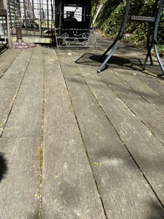

Hi there,
Thanks for your help yesterday. I'm now thinking about doing the rear deck also.
NY
Mahogany
Mix of shade and sun.
4x40ft
Do I:
1: Pressure wash
2: Strip using: https://www.deckstainhelp.com/restore-a-deck-injectable-deck-stain-stripper-review/ or
using: https://www.deckstainhelp.com/rad-paintstrip-paint-solid-stain-stripping-gel-review/
3: Brighten using: https://www.restore-a-deck.com/rad-brightener-only.html
4: Stain using: https://www.deckstainhelp.com/restore-a-deck-wood-stain-review/
Pics attached:
@administrator On seconds thoughts, I;'m going to use the stripper to remove the varnish from the Douglas fir.
- Do I need to use a brightener before applying the stain?
- Do I need to protect the surrounding walls with tarp during the stripper and brightening stage or is only required during the staining process?
TIA.
Yes, brighten after and protect all walls when stripping.@administrator On seconds thoughts, I;'m going to use the stripper to remove the varnish from the Douglas fir.
TIA.
No pic.Hi there,
NY
Mahogany
4x40ft
Do I:
1: Pressure wash
Pics attached:
@administrator
1: Strip using: https://www.deckstainhelp.com/restore-a-deck-injectable-deck-stain-stripper-review/
Note you pressure wash after using the Stripper
2: Brighten using: https://www.restore-a-deck.com/rad-brightener-only.html
3: Stain using: https://www.deckstainhelp.com/restore-a-deck-wood-stain-review/
Use Light Walnut color for Mahogany Wood.
