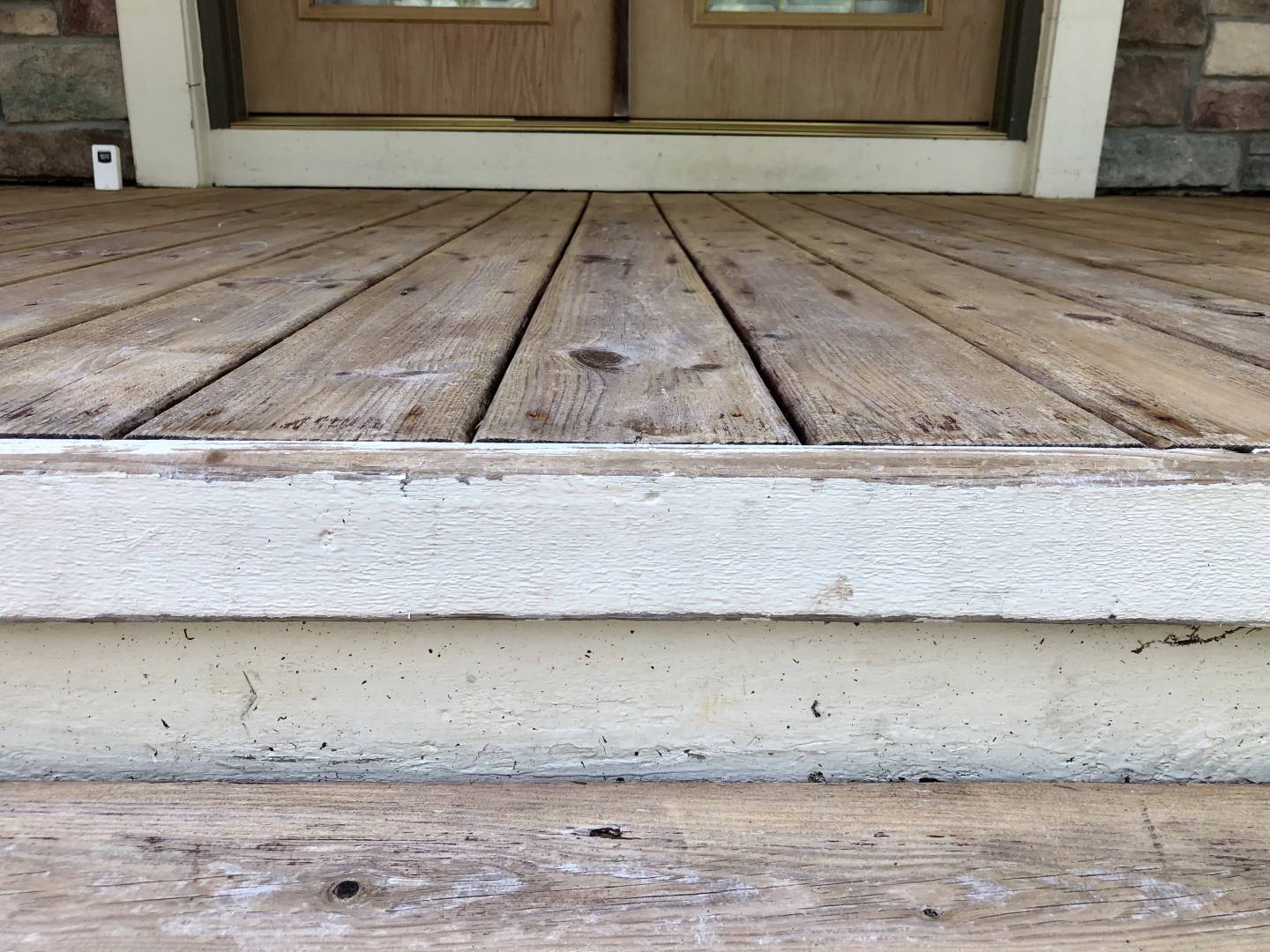

You can stain over this. We would use a solid stain for the trim board.

Eminent Member
Posts: 20
@administrator Hello, I didn't realize you had an article of recommended solid stains linked here to your answer.  I did already buy a qrt of PPG Ultra Creme. Should I try to return it and go with Defy?
Posts: 3342
@franz Defy is much better for sure.
(@franz)
Eminent Member
Posts: 20
Hello, What would we notice as a difference between the two stains?  It seems after much searching that I could only get it ordered in the needed custom tinted color, if I purchase the 5 gallon option.  I do not see a tintable gallon option anywhere. Am I missing it?
Thank you so much
Posts: 3342
It is just a trim board (mostly vertical wood) so it probably does not matter that much what you use.
(@franz)

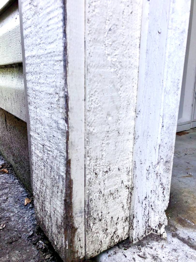

Eminent Member
Posts: 20
@administrator
Just noticing this trim.  We actually have 'rough-cut' cedar trim boards and they are used all around the exterior of the house.  So to maintain the deck trim that is stripped, plus re-coat the peeling spots/knots around the rest of the exterior, we would like to see about getting the Defy in a custom cream, but not in a 5 gallon portion.  Do you know of a place who will tint (have name & sample of PPG color in can) a gallon of Defy?

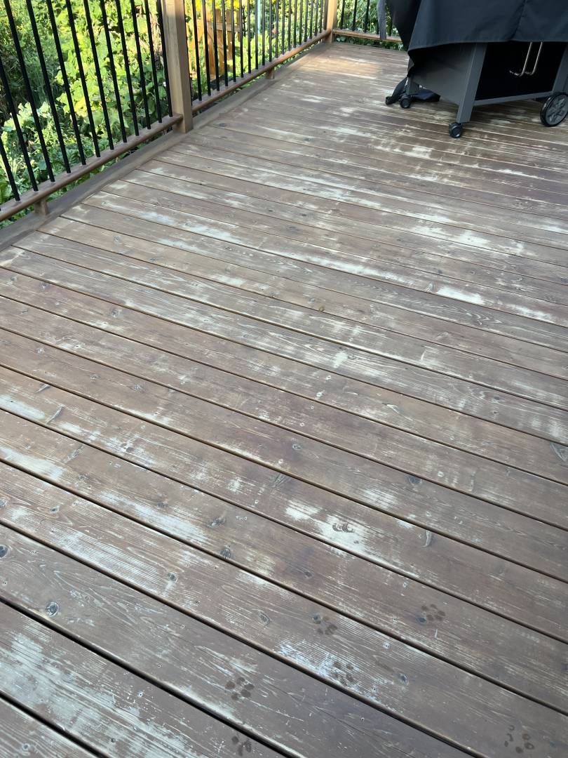

@administrator Help!!  This cedar deck is 3 years old and i've had to strip and brighten it 2 years in a row after using highly recommended SW products. Last one was Superdeck. It faded and flaked off quickly in traffic and full sun areas. I've maintained decks for a lifetime and i don't want to have to do a hard strip ever again. I planned to use Penofin Red Label Oil Sealer and know it will gray but i'm now reading about blackening? Can you make a recommendation on a product that won't film build?
Posts: 3342
@edwhit Post pics for prep advice. Once done, use TWP 1500 Serie or Armstrong Clark Stains. Both are much better than Penofin and SW deck stains.
