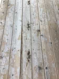

On July 15 I used Step 1 of the Restore-A-Deck to a new cedar deck that was built in 2022 in SD. It removed lots of gunk but left a white film and chunks of white film that have dried to the deck, see pictures below. Will Step 2 remove all of this or should I do Step 1 again?
IMG 0024 (002)
IMG 0023 (002)
(@administrator)
Posts: 3341
That is oxidation you did not fully remove. Redo Step 1 and make sure to use a pressure washer as well.

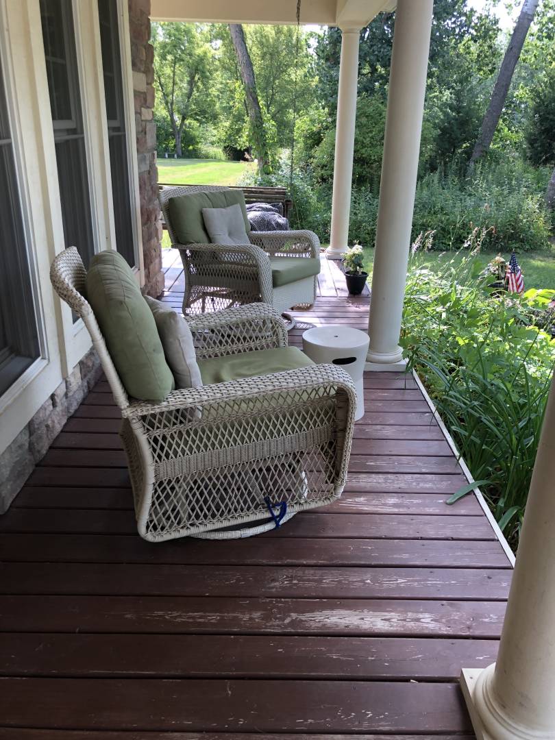

Hello, We have another 17 yr old pressure treated deck to maintain, it is under a porch canopy so not full sun/faces North, and has 4-yr old semi transparent stain Behr. To minimize more work (after just sanding bare an entire back deck) I thought I'd just restain with same product-- a water based stain.  The Behr stain/build up proves almost impossible to remove on other projects, but have not used RAD stripper yet (have used Cabot stripper on other back deck). So if staying with same type -- water based semi transparent, don't I just have to clean and brighten?
What would you suggest I do? Thank you for your help-
Kimberly
IMG 7489 Front Deck
This post was modified 2 years ago by franz
(@administrator)
Posts: 3341
What you have on the wood is more solid/opaque than semi-transparent. Behr lies about their opacity. We would power sand it off and go with a true penetrating stain. Clean and brighten over the top with the same will result in compounding your issues with the Behr.
