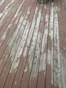

We need help on what to do with our deck. Seems to be a 5 to 7 year repeated process. We are retired and hope to move in about 5 years to a smaller home. So this is the last time I want to refinish the deck but want to enjoy it while we are still here.
Answers to your questions:
  1. In which state is your deck located? Wisconsin Milwaukee Area
  2. How much sun/shade does your deck get? Part shade in the morning, full sun in the afternoon.
  3. What type of wood is your deck made    of? Treated Cedar
Some, not much
  1. What type of stain did you use last time? Behr Waterproofing Wood Stain Deep Base 213.
Here are pictures of our deck. One guy quoted using 2 coats of Deck Correct by Cabot over the existing Behr after a light power wash and scraping. He doesn’t want to strip the deck. This looks like a permanent product hard to remove down the road?
The second guy will Power Wash / Days 2 and or 3 Drying/ Day 4 Stain/ Day.
The decking will be washed and scrubbed with a chemical solution to "revive" the wood. The surfaces will then be power washed to provide a clean surface. This is a cleaning process NOT a stripping of the old finish.
The decking surface will be sanded prior to the staining application. This step is taken to promote adhesion and provide a more uniform surface for the finish coat. Then apply 1 full coat of solid of Sherwin Williams Duck Back Solid Color Deck Stain on all surfaces.
So can you help us sort out the best solution? I’m getting one more quote and want to be prepared to suggest the right solution and products you would suggest.
One final question, I’m thinking of covering the deck with a tarp in the winter. There is plenty of air moving under the deck to keep it dry but would keep the snow and ice off of the surface during the winter months. What do you think of this idea?
R4ntoy
(@administrator)
Posts: 3341
@r4ntoy You have a solid stain so the easiest is to stick with a solid stain. See this for prep tips:
SW stains are poor. Look for a better brand:
https://www.deckstainhelp.com/category/deck-product-reviews/solid-color-deck-stain-reviews/
No point covering the deck.

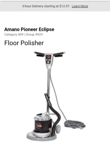

Screenshot 20230621 214551
One of these you mean? Do you have a pad or grit size you would recommend? Thank you.
This post was modified 2 years ago by elav
(@administrator)
Posts: 3341
Yes. We typically use just a white or red pad to buff off fuzzies. If needed, you can also get the sanding discs and use them under the pads.
