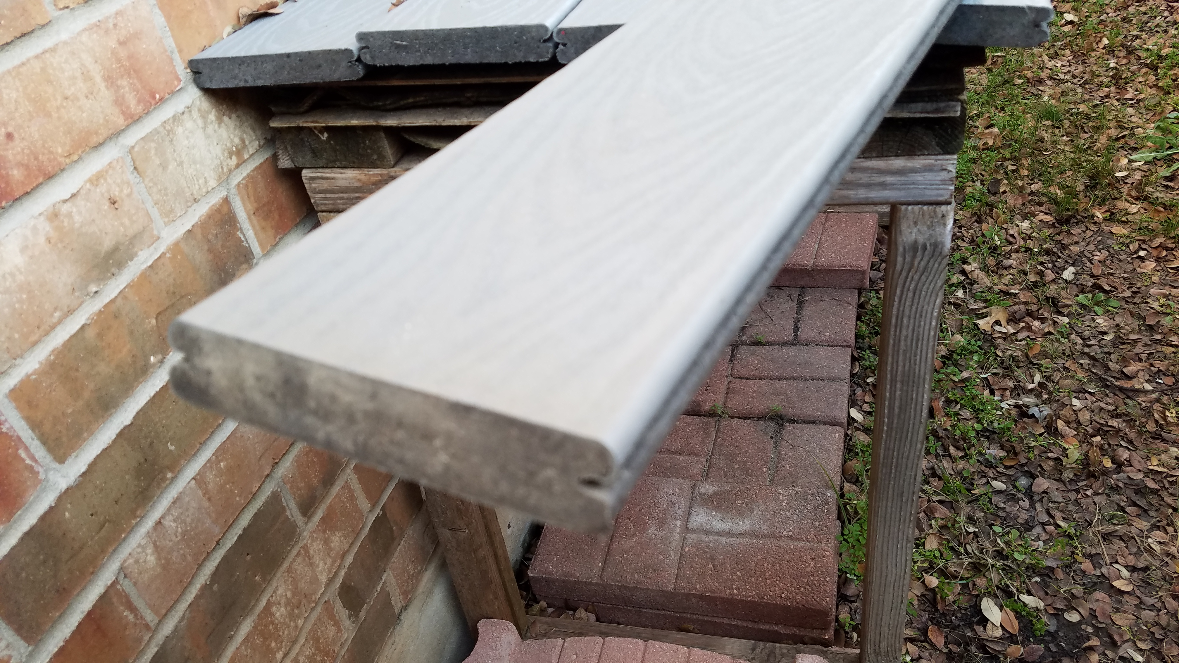

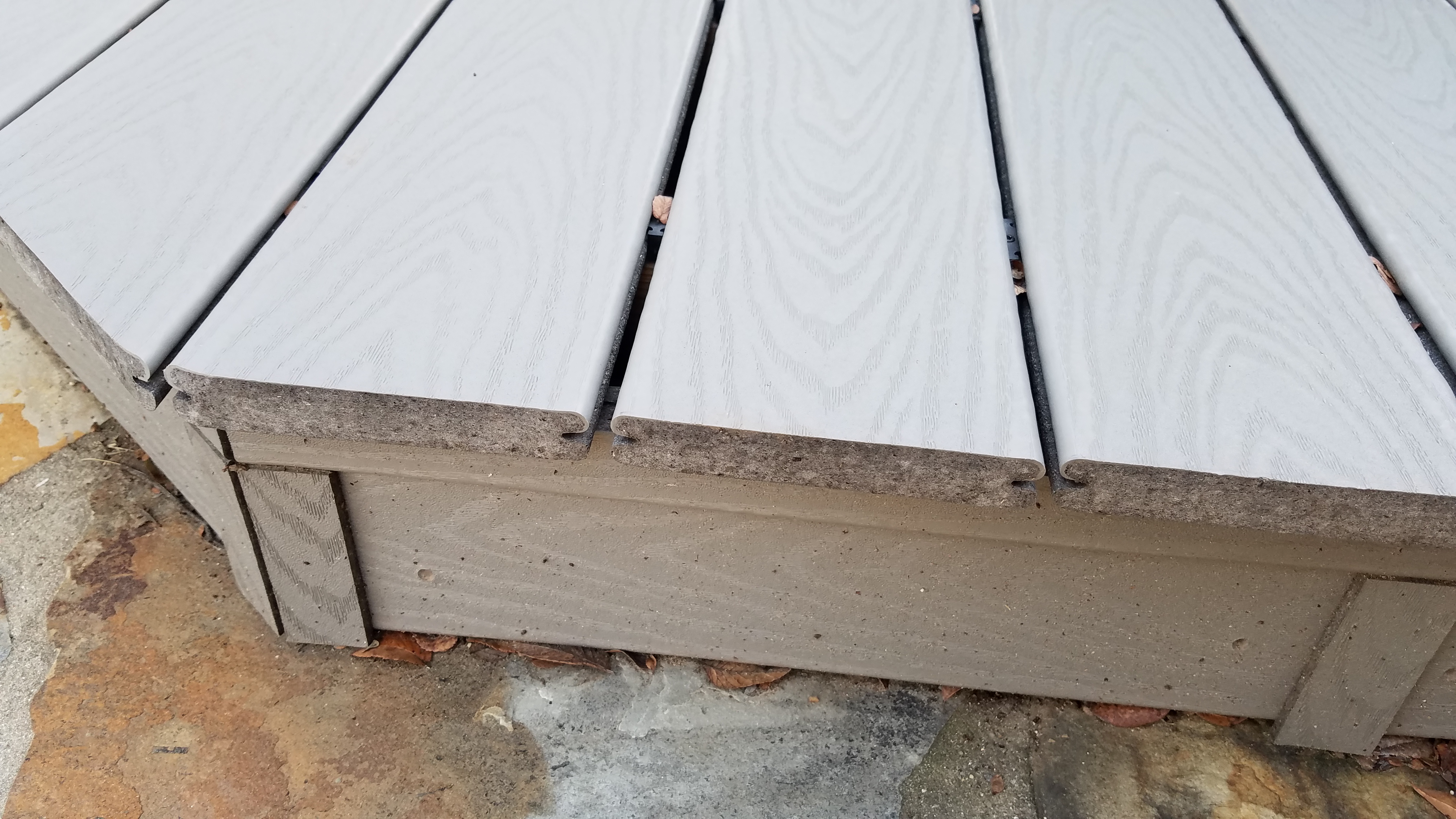

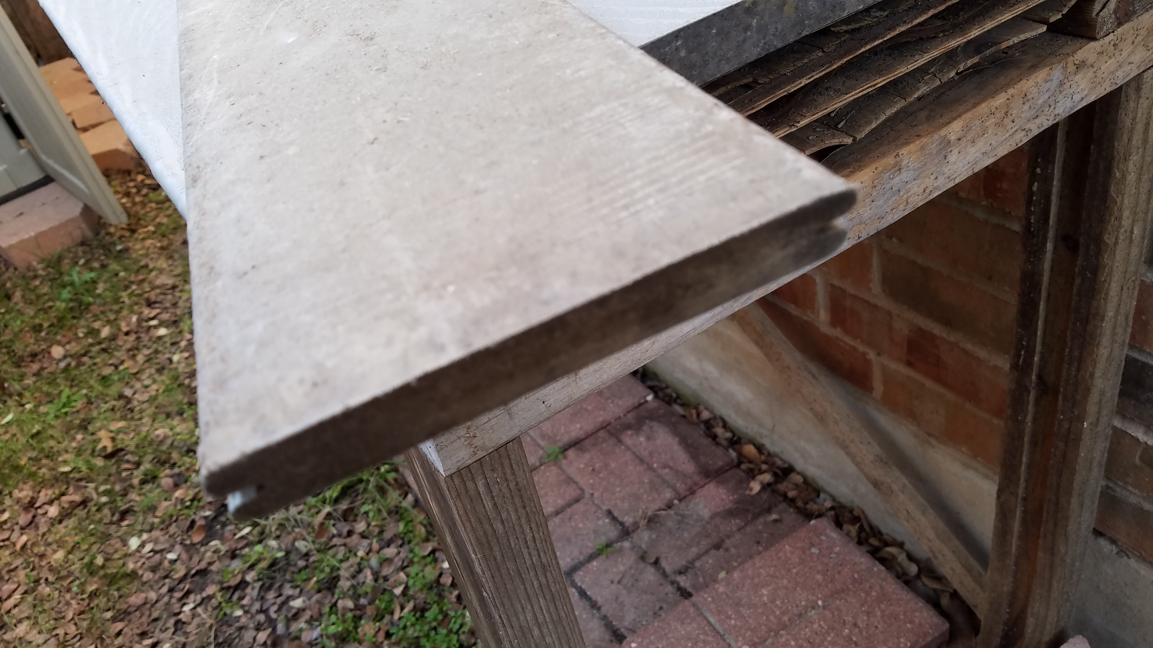

If OK, I'll ask this here. I have a composite deck and we'd really like to change the color of it. We just bought this house and this was installed already. It looks to be about 5 years old, maybe? Not sure. But we do know we really can't stand the USS Missouri Battleship Grey color, definitely does not go with anything in the yard.
My question is, is there any coating that can durably coat this composite? The usual suspects at Home Depot suggested Behr's DeckOver, but after looking at reviews online, I don't want to spend $500 and a tough mother of a day painting it with this stuff, then having it peel the first time a chair is skid across it or a hard freeze comes.
I'm posting three pictures of the decking (including a left over piece), but since it was pre-installed on this house, I have no idea who made it. I'd really just like to find out if there is any super adhesive, super tough paint or coating that will stick to this decking, it's pretty slick stuff.
Sorry but we do not have any experience with staining the composites. Definitely stay away from the Behr though.
