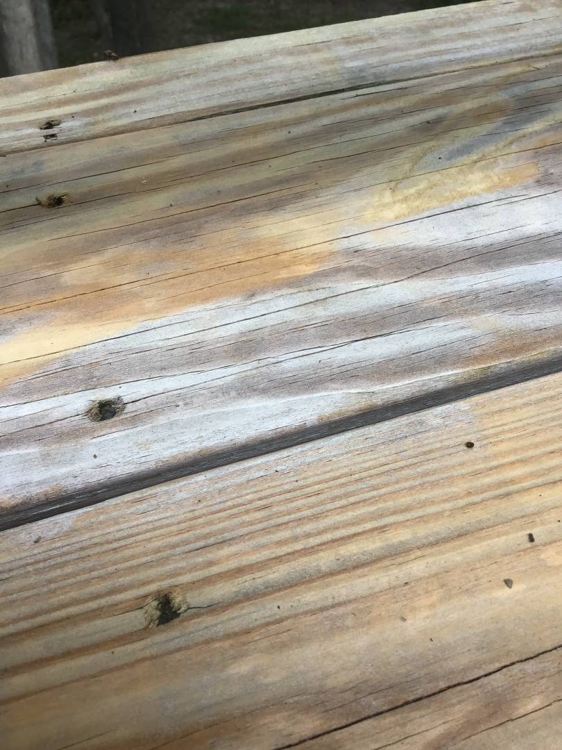

Hi, everyone!
My husband cleaned/prepped our deck with Valspar All in One Wood Prep, then power washed it. Some areas look uneven in color. I was considering using a semi solid wood stain, as I have seen articles stating the pigment is beneficial for protection, and that solid stain can crack and may require a lot of scraping prior to reapplication later. However, I am concerned this unevenness in color may show with a semi solid stain. Should we go with solid stain or take some steps to even out the color, then use semi solid stain? If the latter, how would you recommend we even out the color (most efficient way possible)?
I have attached a photo of the most extreme unevenness in color.
BD4B44DF 408E 4D03 BC5E 352B3AC5188A
Posts: 3381
That is oxidation/graying that he did not remove fully. It will come off. Use the Restore A Deck Cleaner and Brightener kits for prep as they are much better than the Valspar. For the stain, semi-solid would be a good choice. Try TWP or Armstrong Clark.
