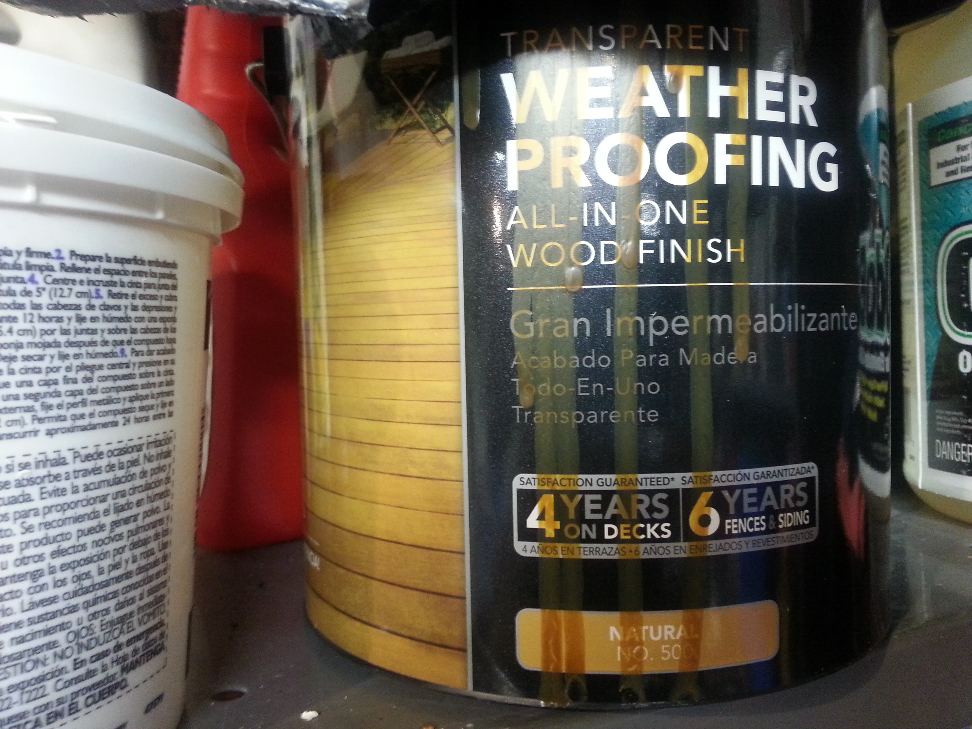

New member here. This is a GREAT site. Unfortunately, I discovered this site AFTER applying Behr Weather Proofing All in One Finish last summer. It's a mess. I have peeling on the tops of rails and the horizontal decks now have uneven colors.
My question is, I've searched this site and didn't find any reference to this particular product. Is the Weather Proofing All in One Finish just a renamed Behr stain?
Obviously, I want to remove all this and put something else on. I live in Northern Va so I'm looking at TWP 1500 (pine wood). However I understand I have to get this garbage stripped off first. However, I have some basic questions:
1. Will Restore a Deck stripper work best?
2. What is meant by "injectable"? I have both a pump sprayer and a power washer.
3. If I need to sand, what is the best method? I have a large three level deck and the thought of hand sanding the entire deck is terrifying.

To remove this you would want to use at full strength and pump spray it on. You will need a few applications of the RAD stripper as Behr can be hard to remove. Strip as much as possible then sand if needed using a floor, belt or hand sander.
All Behr deck stains are poor.
