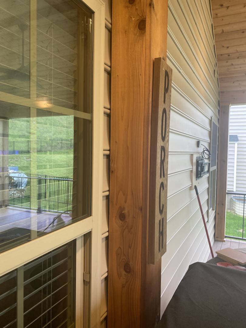

Post pics for prep advice.
(@valszy)
Posts: 4

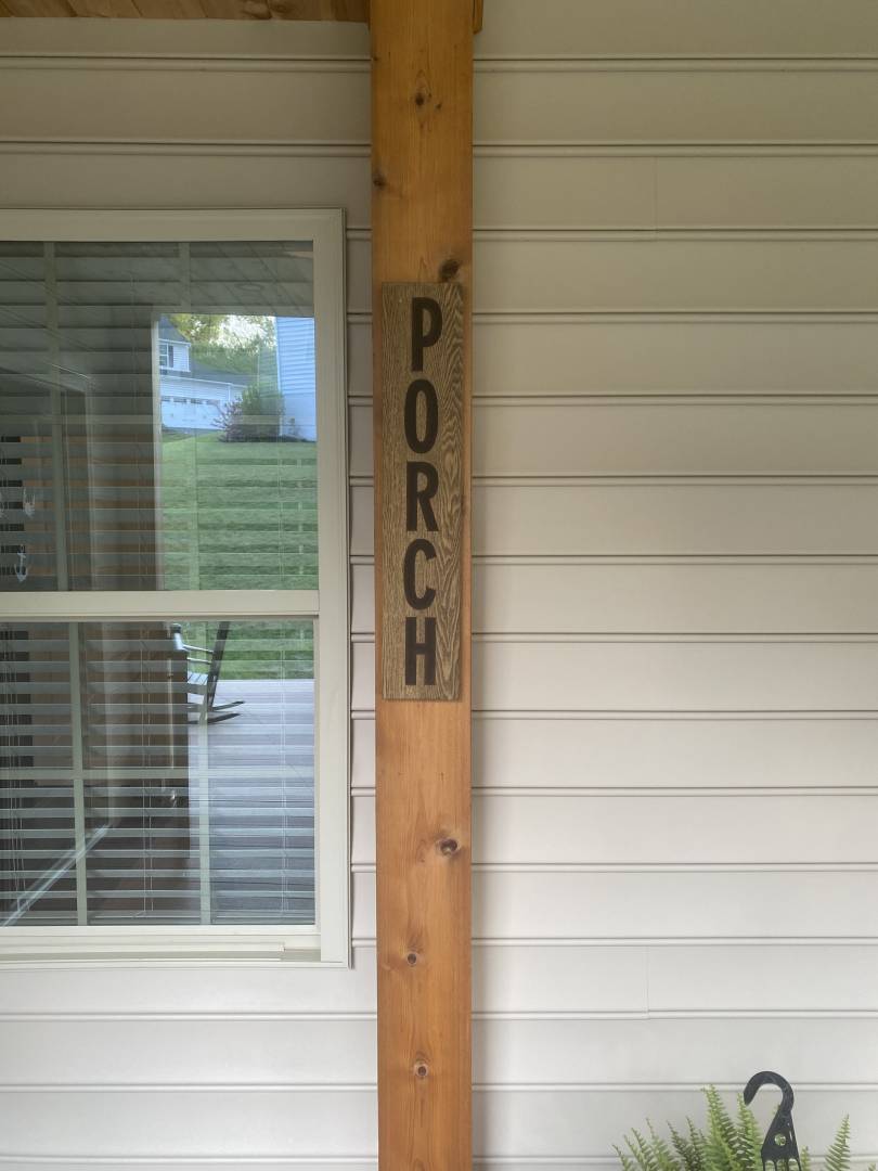

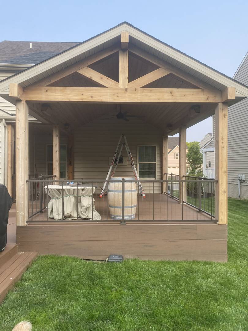

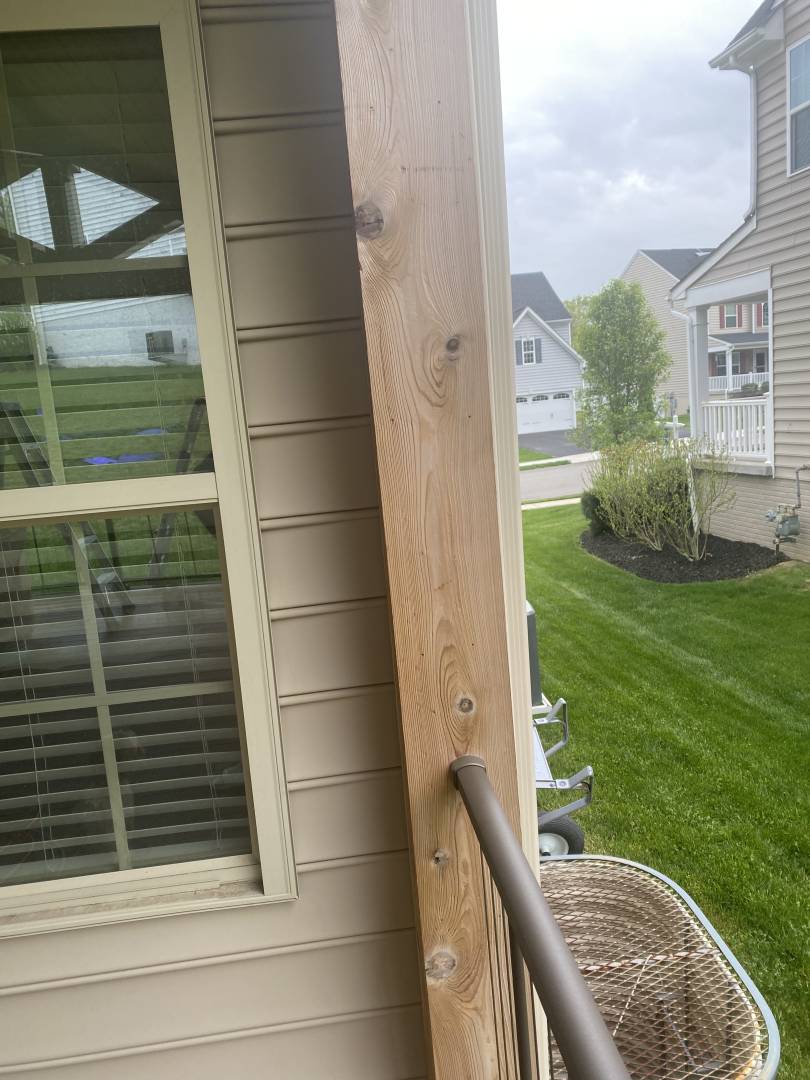

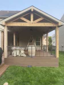

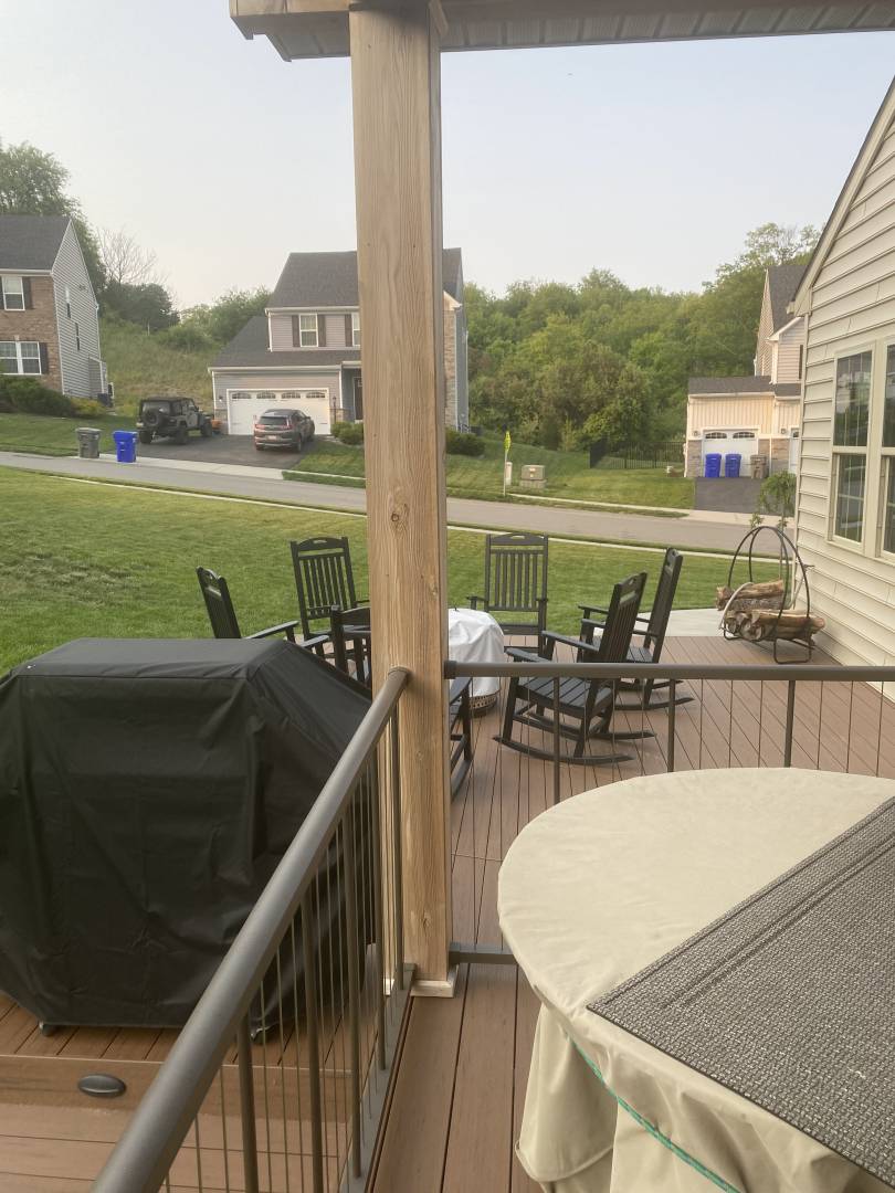

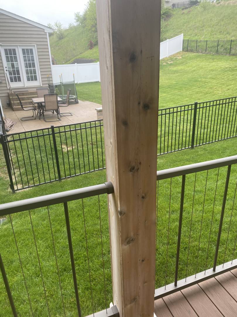

I’ve attached more pictures.  The only area really left with stain on it is the post showing the word “porch” on it.  The archway we sanded down and the other stain faded off the posts.
(@valszy)
Posts: 4
8F04C1D1 8A8C 490C B83B D1C16EE9F5BF
5D5A4961 472F 43A6 ADA1 FE1579AE3781
F94DD9FF E68A 4FD0 9886 0EDD65F0CFDB
Use the Restore A Deck Stripper on the one post. When done, use the Restore A Deck Brightener on all wood. Stain with the Restore A Deck Stain in a semi-transparent color.
