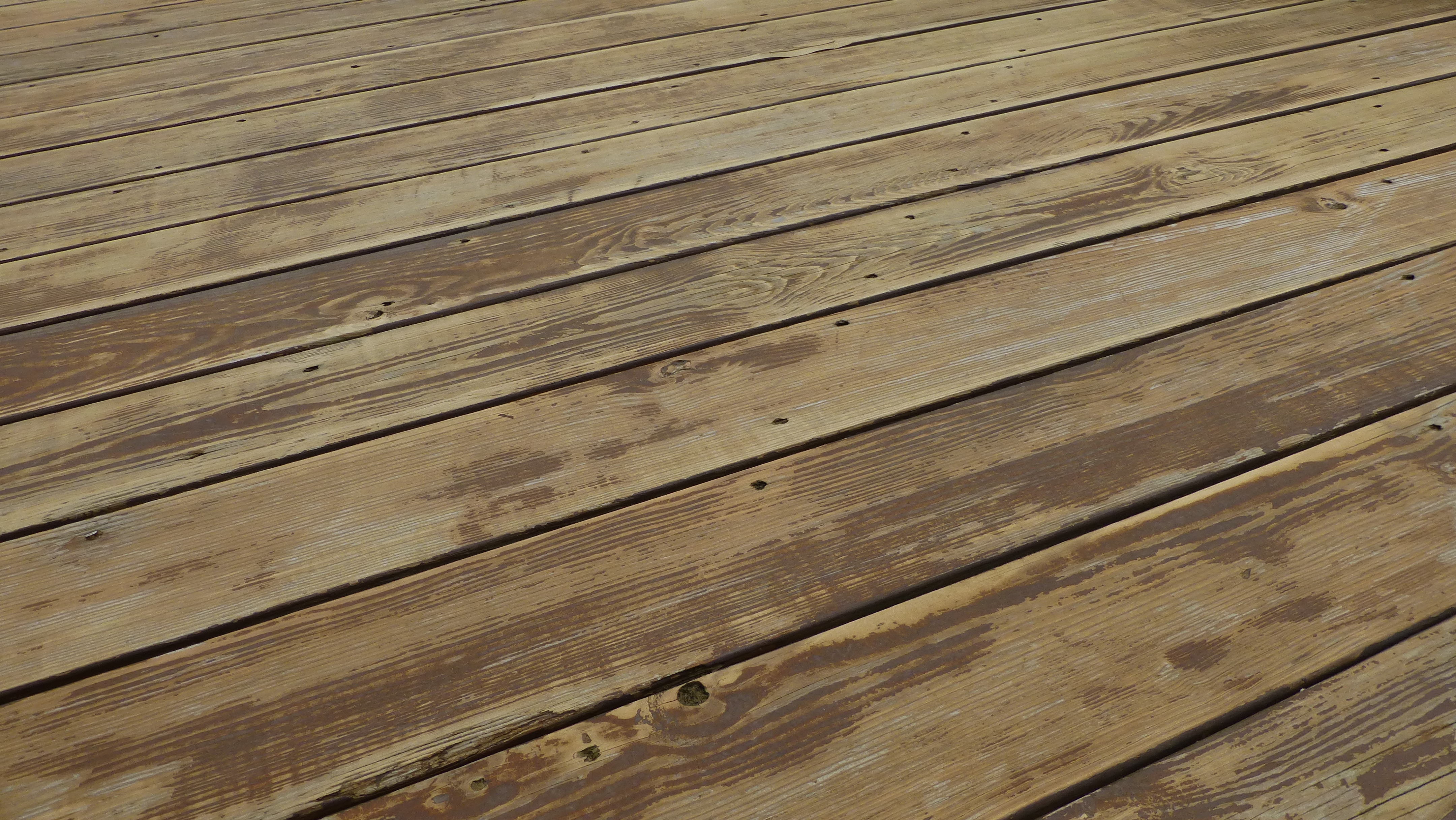

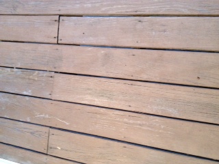

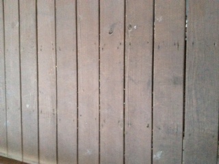

Our deck is about 5 years old and was stained about then as well. I cleaned and power washed it about a month ago but I am not sure if it is clean enough. I posted some pics hoping someone can give their input. Thanks.
It does not look clean enough to me. I would use a deck stain stripper followed by a wood brightener to remove as much as possible of the old coating.

The Rad kits contain a cleaner and a wood brightener. They do not strip old coatings. If you are going to switch brands then yes you should use a stains stripper such as the Restore-A-Deck Stain Stripper. If going with the same brand then using the RAD Cleaner and Brightener Kit should be enough to prep the wood for another coat.

Improper prepping is the number one reason a deck stain fails faster then normal. You spray on the stain strippers then pressure wash off. The more you get off the better chance the new stain has to perform well. It would be to your benefit to at least try to get more off.
