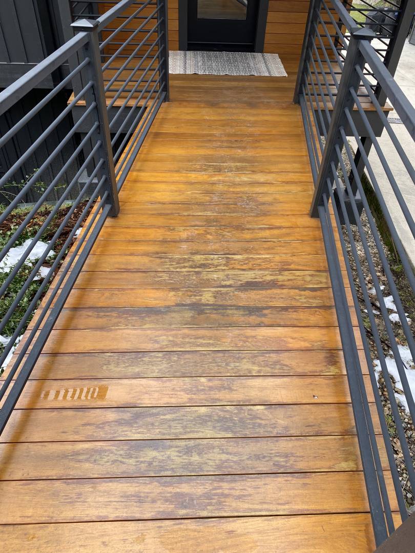

This garapa was installed July of 2021. It was oiled before installation and had some discoloration summer 2022. My husband did some light sanding and re-oiled. Now it looks like this. Any idea of a fix?
Posts: 3384
Strip it all off and then brighen the wood. Restain after.
