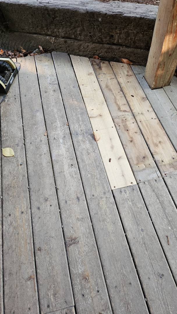

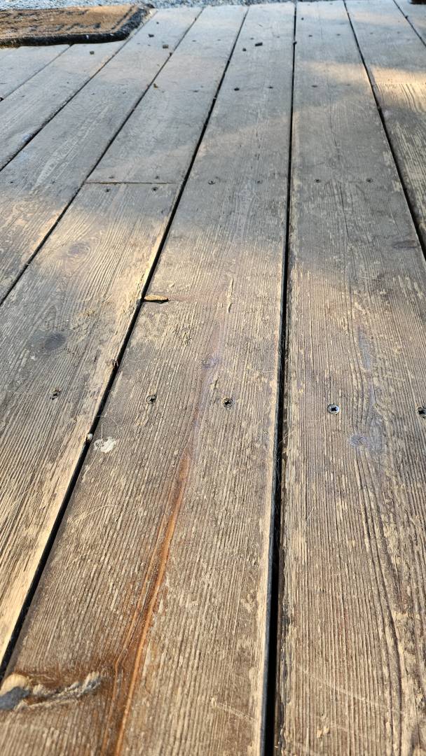

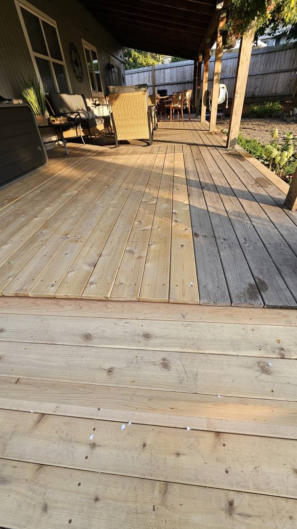

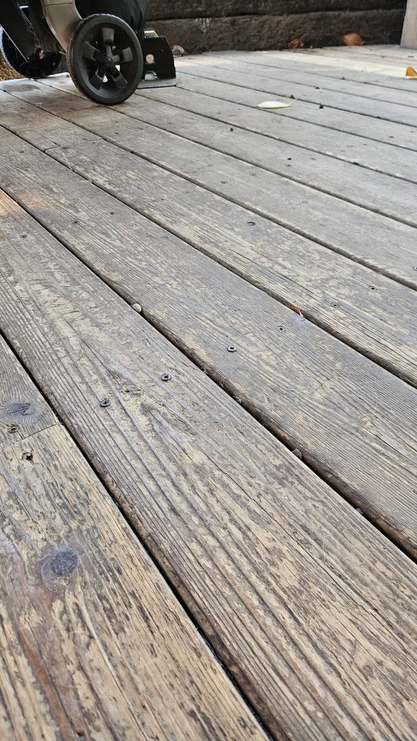

This is probably a 20yr old deck that is mostly covered. Has not been treated since built as far as i know.  I am not sure if stripping and brightener would be enough before stain. We had to replace some of the wood around the edges, and fill in a spot where a hot tub use to be.  Also new steps at the end of the deck.  I am attaching some pics.  What is your opinion on how to proceed?

See this about new wood. https://www.deckstainhelp.com/how-long-should-you-wait-to-stain-a-new-deck/
When ready, clean and brighten all wood for the prep and then stain. Stain options are on the link above.
(@pnwdeck)
Joined: 3 months ago
NO stripping of the old stain or sanding?
Yes, you will need to strip and brighten for the old stain. Clean and brighten the new wood.
