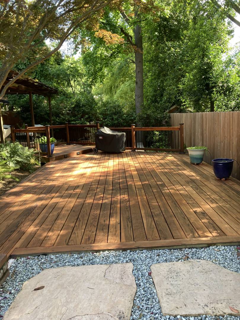

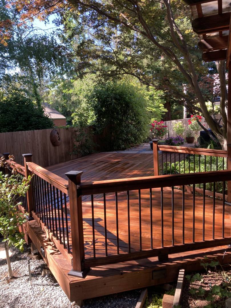

I have refinished my deck several times over the years, but was most successful with results from the last two years. The last job was just completed and the results are pictured in attached photos. I used both Restore-A-Deck products which performed as advertised. I finished with Armstrong Clark Transparent Redwood Tone. The discovery was a 5 in. Blue Hawk brush from Lowe's which comes with a detachable handle. To stain the deck boards, I attached an extension pole in place of the handle which allowed me to stand as I brushed out the stain to desired consistency and smoothness. Using the method I have also used far less stain than in the past. I completed the approximately 400 sq. ft. deck including rails and trim with slightly less than one gallon.
