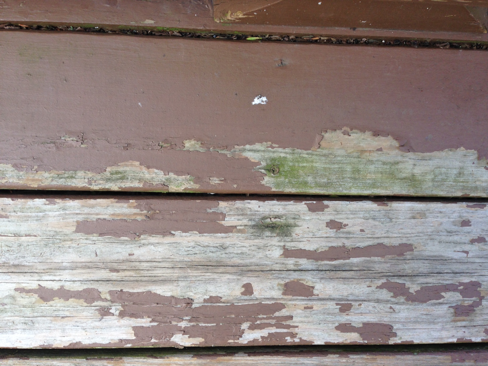

I posted in the Deck Cleaner section asking if I need to sand to remove the old stain. I was asked by your moderator to provide the type of stain last used and upload some pictures.
Well, I discovered that the stain/sealer used was Cabot Premium wood care, Solid Color Acrylic Deck Stain, 1806 Neutral Base. I still have two gallons of the stuff left so I am tempted to use it again but obviously would like to use the best product for the job.
My father sealed the eco the last two or three times and I'm pretty positive he did not use a cleaner like it is recommended here and most everywhere I have looked. He just scraped the old , flaky, peeling paint away and reapplied. I think this was his main mistake. However, he's telling me that I shouldn't sand it. Just scrape it. I think using an electric band sander with an 80-100 grit would be the best way to remove the old stain sand and resurface the wood. He says I will catch it on the screws and nails and create a problem there. I'm unsure what to do. I think If I am careful to avoid the screw tops, and screw any ones that protrude in all the way before I begin, then I should be OK. But then I am uncertain of what to do next. Do I clean up the sawdust before I start adding the deck cleaner, power wash the deck or can I skip the step of adding the cleaner entirely if I sand it down enough?
One other idea we had was to buy composite wood, same size as the existing boards and lay it overtop of the existing ones. Whether we sand and seal the old ones might not make a difference because I am thinking that water will inevitably get trapped between the two layers of boards and begging to rot at an accelerated pace. However, it would be nice to use composite wood so we don't have to keep doing this every two years! Thoughts?
See attached pictures. Thanks!
Posts: 3381
You are stuck with another solid unless you want to sand 100%. We would pressure wash with a deck stain stripper to remove what loose stain you have. It will not strip it all off but it will remove some stain tat has failed. After the stripping you should sand where needed to make sure all leftover stain is still attached/intact on the wood. Apply your solid and retain every 2-3 years but repeating same prep. Unfortunately nothing will last much longer in your scenario due to current condition of wood and past applications.

My deck looks same as the pictures above. I am weary from working on the deck. Started process last summer, and decided to wait another year as the solid stain would not come up after power washing 2 times and sanding....now this year power washed, scrapped....still see failing stain. Will sanding remove what is left? I will be using a lighter color solid stain. I want to do this right for a lasting finish. Any suggestions???
Posts: 3381
Remove the rest by sanding then clean and brighten the wood for final prep before applying a new solid stain.
