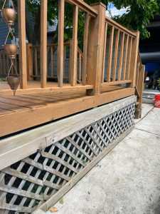

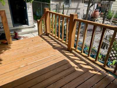

My deck recently was redone with Behr semi-transparent waterproof stain/sealer. It's a terrible orange color, and it was painted on unevenly, so it is patchy. I've learned that Behr is particularly frustrating to remove, and a bummer product. And it's on all the railings as well. What is the best stripper to take it off? Pictures attached.
Many Thanks for the advice!
image1 (1)
image3 (1)
It is opaque, not semi-transparent in appearance. Behr lies about their opacity. You will need a solid stain pain strip and sanding to get it all off: https://www.deckstainhelp.com/how-to-remove-a-solid-color-deck-stain-or-paint/

Thanks for the quick advice, Scott. So I should go for RAD Paint & Solid Stain Stripper, not the Restore-A-Deck Stain Stripper, correct?
For anyone else who finds this thread with the same question, here's exactly what I'm trying to remove:
image0 (1)
Posted by: @egm87
image0 (1)
Yes, use the RAD Paint Strip.
