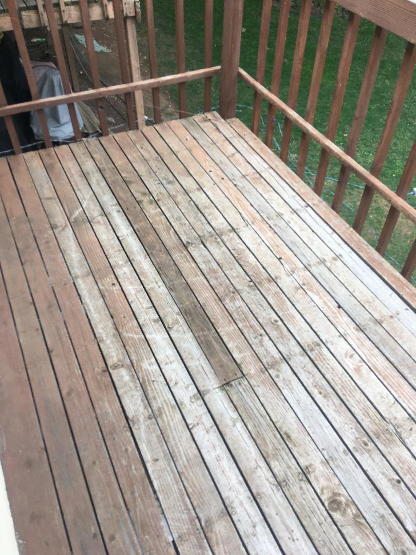

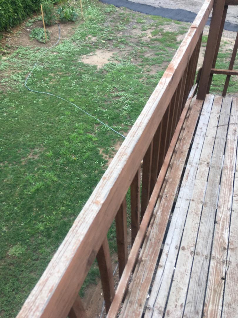

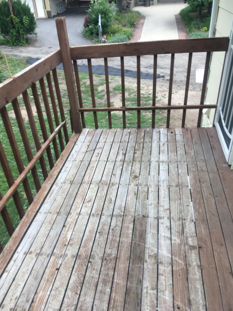

I have three older decks that are identical at a triplex rental property in Golden, Colorado.  They are original from 1982 but in pretty good condition because they are on the north side of the building and don't get much sunlight. Not sure what the wood is, possibly redwood?  I would like to remove the old stain and apply something that will protect them and improve the appearance. I want something penetrating that will not peel and will have longevity. Would Restore a Deck be a good product for this, or would TWP or Armstrong be better?  I am inclined to use a water based product because it is easier to work with, cleanup etc. since the units are occupied, and am fearful that an oil based product may end up gummy and tracked inside on the new carpet by the tenants.  I do plan to clean and brighten first.  I don't think I have mold issues.

Would Restore a Deck be okay for older wood or should I use another oil based product that will condition better?
You have to remove the old coating fully and this means you need to strip (not clean) and brighten. Use the Restore A Deck Stripper with both additives and then Brightener:
As for the stain, all 3 would work well. TWP and the AC are oil-based and neither would be "gummy" and track inside the house. They are both full-curing stains.
The RAD Stain would work very well if you prefer the water-based.
