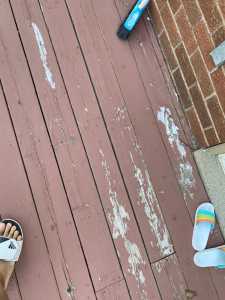

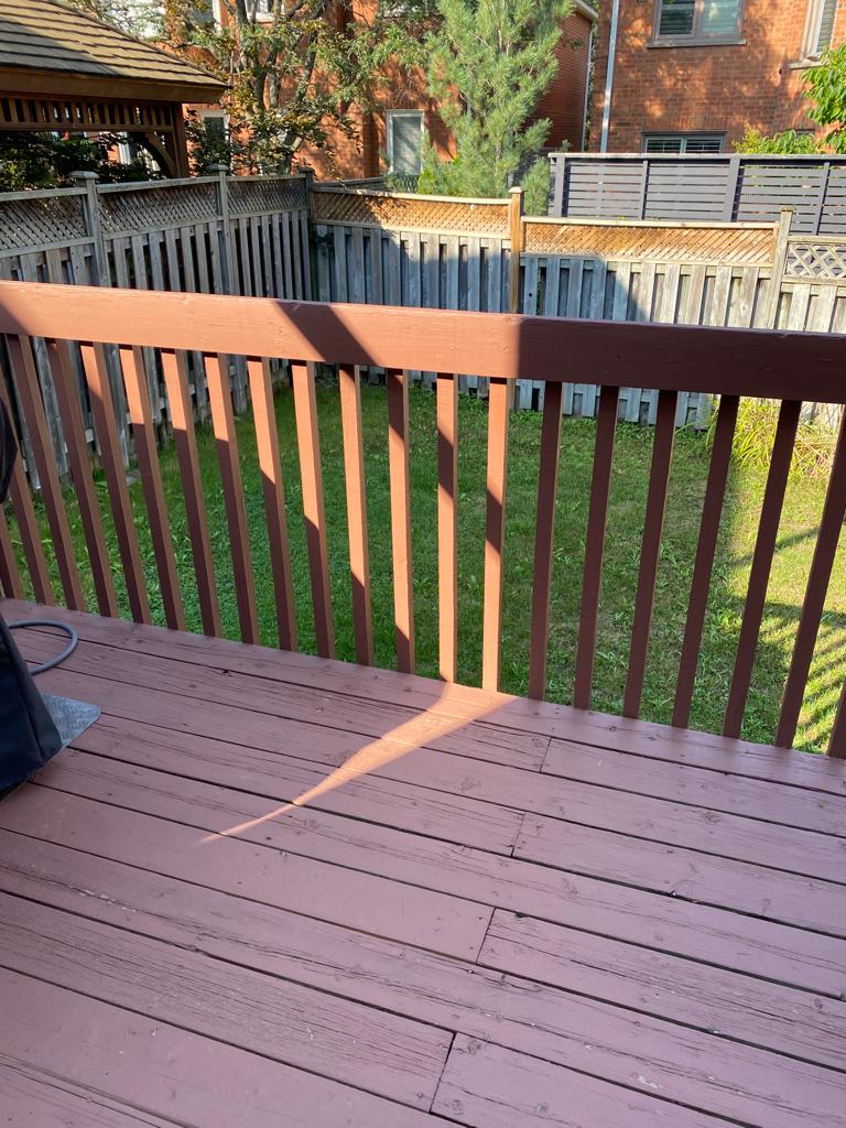

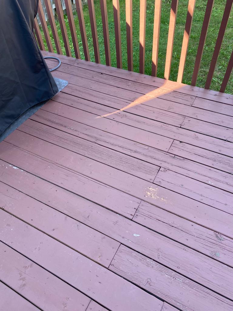

Hi all – thank you for the resources, could use some guidance/sanity check my planned approach
We live in Toronto, Canada, purchased a house with a 300 sq ft deck, it was stained with a solid stain (unkn
WhatsApp Image 2022 08 30 at 11.25.20 AM (2)
WhatsApp Image 2022 08 30 at 11.25.20 AM (1)
own), older wood, stain peeling, nails seems ok and floor is quite flat
Want to move to a clear or semi-transparent stain – Sansin Dec –
Curious on the process
1) Strip current stain with sander? thinking of using Diamabrush on angle grinder –
2) Is it easier to use a chemical stripper (before, after, or instead of sander)? or a large floor sander rental?
3) Clean and Brighten, is this needed?
4) Apply Stain once dry
Pictures below, main question is related to the recommended stripping/cleaning/brightening process,
what is the best option / sequence (diamabrush, floor sander, pressure washer, chemical stripper)
many thanks in advance
This topic was modified 4 years ago by Scott Paul ~ Restoring Wood & Decks Since 1993
You cannot strip a solid stain fully so you will have to power sand or grind it off. Clean and brighten after a full removal.
