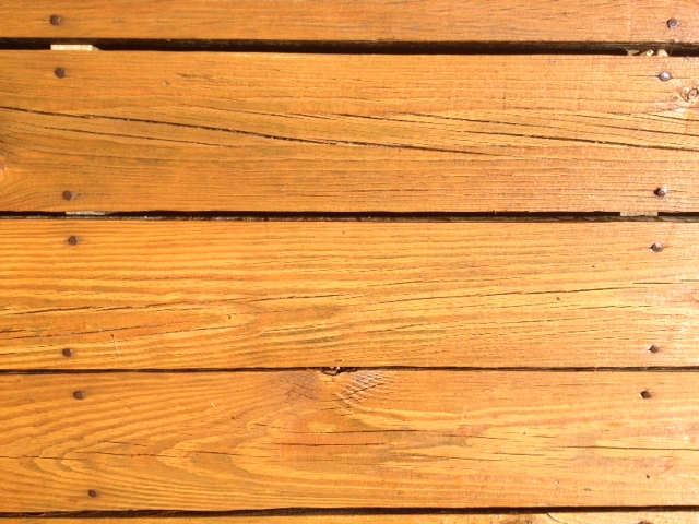

Here is a picture of Defy Extreme Cedartone:

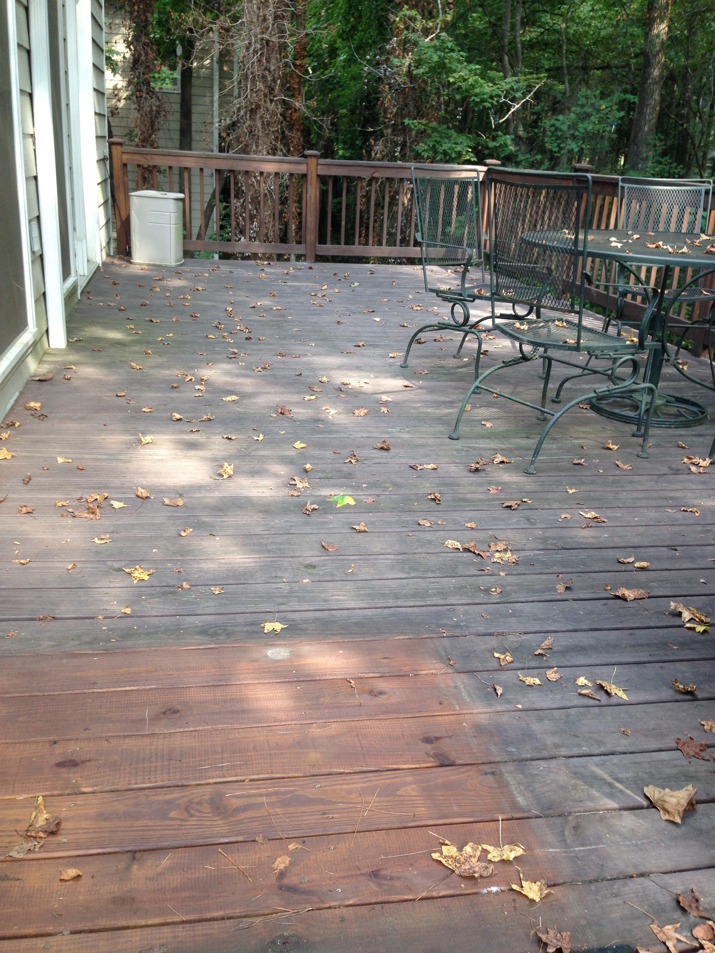

I'm in a similar situation but different location (Atlanta). We used Cabot Preservative Wood Finish in a brown about 4 years ago. There are some green spots in shaded places. The steps are stripped clean in a few spots from the dogs. But I can't complain for 4 years. I'm having trouble choosing a products this time around. I was leaning toward a solid stain. Armstrong folks suggest that solids show scuff marks more and a semi-transparent would be better. I'm also interested in defy but so nervous about peeling.
We keep an outdoor rug over the dogs path on the deck.
Lots of rain, lots of shade, but several hours a day of hot GA sun.
Suggestion?
Posts: 3381
Strip and brighten for the prep and Rustic Brown from AC as the stain.
