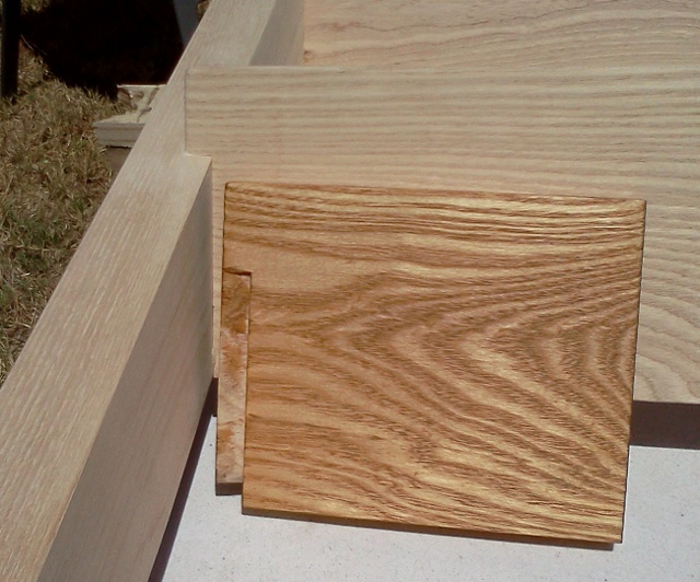

I removed links from first post. I ended up ordering "natural" from here, http://www.twp-stain.com/twp-1500-stains.html, because they had the best shipping rate I could find for a single can. They never did email the tracking number as stated, but it showed up the day I started to wonder why I hadn't gotten the tracking number yet 😛
Did a quick test on an end scrap. Bad cell phone pic, but gives a decent idea. I think it is ever so slightly more golden than it appears in the pic, but it just depends on the lighting. Looks good, so now I'm just waiting a bit for the wood to season.
Posts: 3381
Looks very nice! Almost like a Red Oak hardwood floor.
