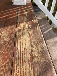

attached
 IMG 5948 Small

You have a varnish on there and it has to come off fully first by either power sanding:
Or a Paint Striper:

@administrator Thanks for the response, its appreciated.
I'll sand off the varnish.
Once I've done that, should I add the stain? If so, do you have any recs?

@douglasfir Try this: https://www.deckstainhelp.com/restore-a-deck-wood-stain-review/
Very easy to maintain.

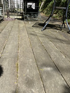

Hi there,
Thanks for your help yesterday. I'm now thinking about doing the rear deck also.
NY
Mahogany
Mix of shade and sun.
4x40ft
Do I:
1: Pressure wash
2: Strip using: https://www.deckstainhelp.com/restore-a-deck-injectable-deck-stain-stripper-review/  or
using: https://www.deckstainhelp.com/rad-paintstrip-paint-solid-stain-stripping-gel-review/
3: Brighten using: https://www.restore-a-deck.com/rad-brightener-only.html
4: Stain using: https://www.deckstainhelp.com/restore-a-deck-wood-stain-review/
Pics attached:

@administrator
 IMG 5961 Small

1: Strip using:  https://www.deckstainhelp.com/restore-a-deck-injectable-deck-stain-stripper-review/
Note you pressure wash after using the Stripper
2: Brighten using:  https://www.restore-a-deck.com/rad-brightener-only.html
3: Stain using: https://www.deckstainhelp.com/restore-a-deck-wood-stain-review/
Use Light Walnut color for Mahogany Wood.
